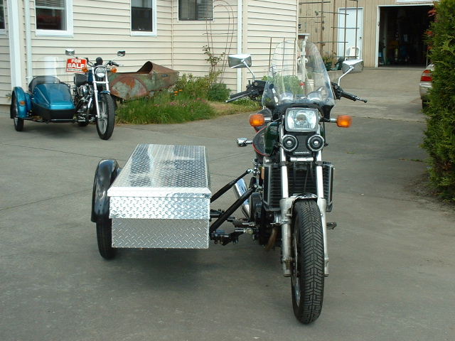

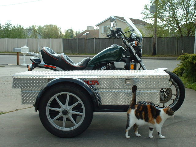

The attached V65 Magna Handyman rig utilized a CSC Companion chassis with a flatbed deck upon which a rail or utility box was bolted for miscellaneous shop hauling chores (with speed).
Subsequently sold to a wooden boatwright for hauling and dockside repair work.

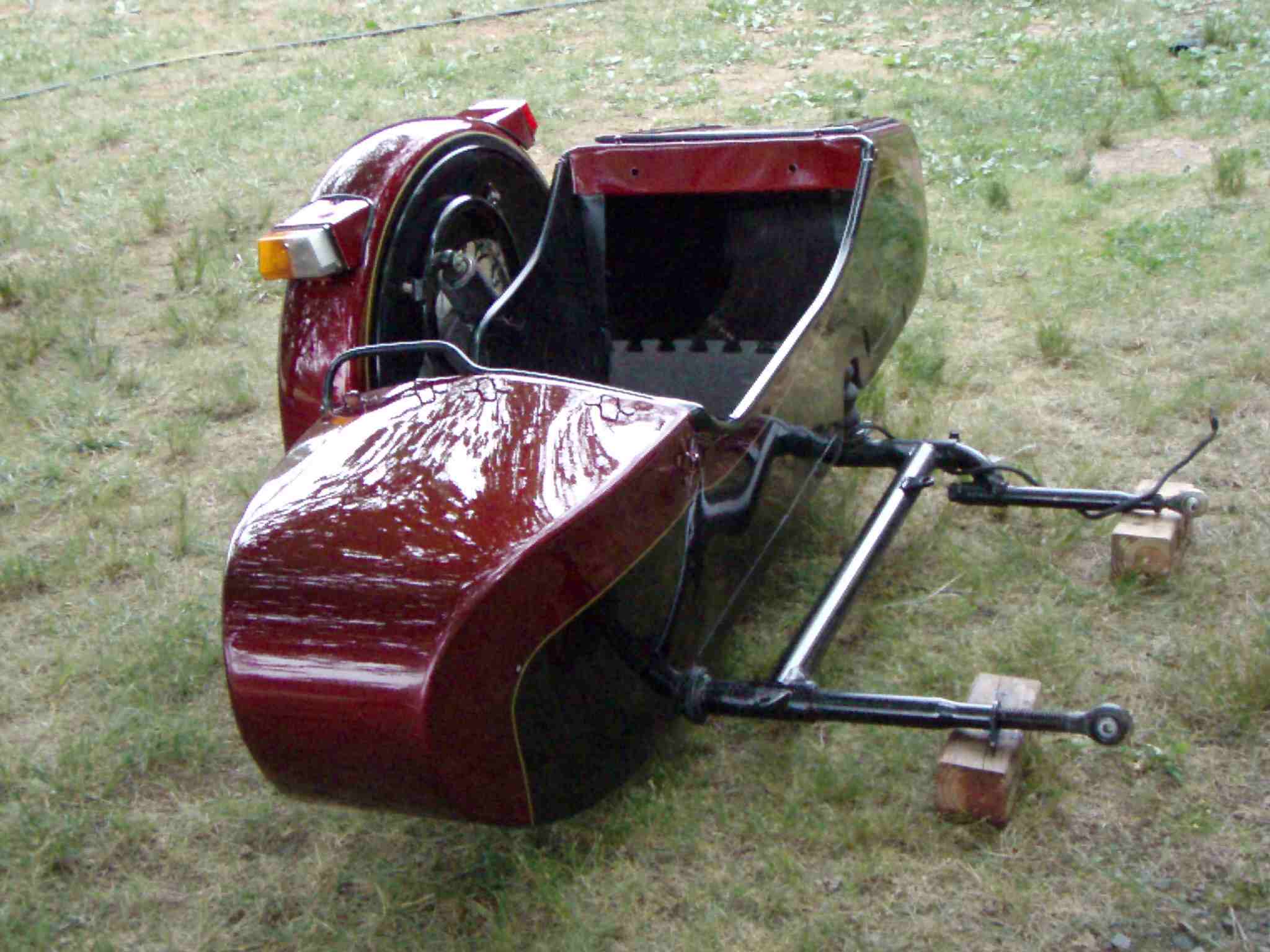

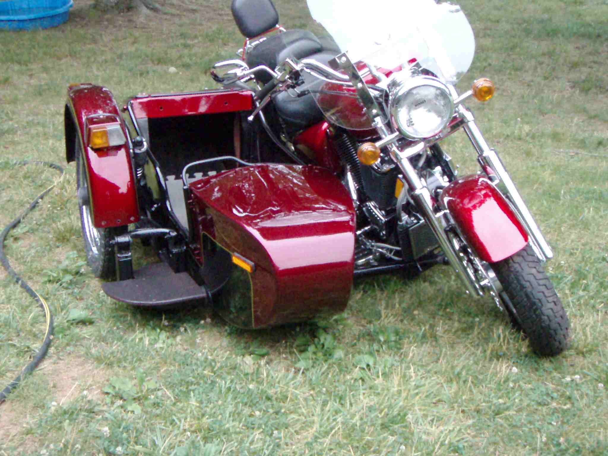

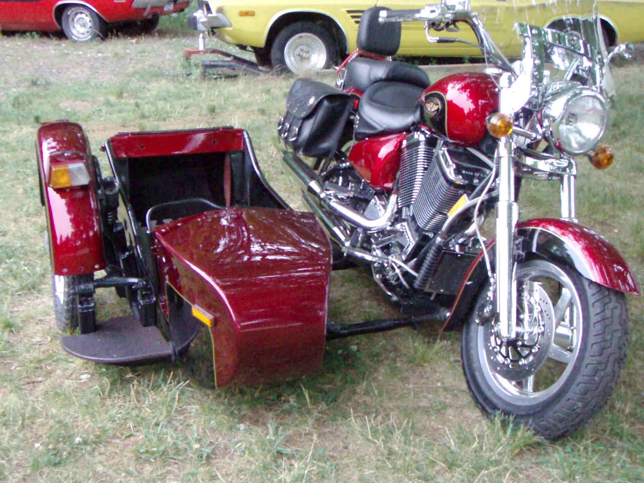

The leaner was actually fairly easy to adapt. I lowered the Ural suspension and attached rod ends to the frame supports. Fabricated mounts that would bolt up to existing bolt holes of the Victory's frame. Two bolts attach the rod ends to the mounts. Had to tweek the front mount a bit to find that 'neutral' steering feel. By moving the front bolt hole up and outboard towards the sidecar I was able to find the sweetspot where rig tracks straight without constant steering input. So the front mount is now slightly different than the photos show. Personally I did not care for the steering charateristics of the ridgid setup. Articulated setup feels just like a motorcycle is supposed to. You lean thru the curves. The main thing is keeping the support frame low to provide yourself as much lean angle clearance as possible. I'll be soon modifing my exhaust to 'loop' over the rear support frame in order to gain a few more degrees of lean angle.
If your interested in a leaner I say go for it. I can't believe that you would regret it. Good luck. Roy

Very nice!
Posted : November 24, 2009 12:10 pm

Roy, you have such a beautiful paint and put your rig that low that I cannot even imagine you outside of a smoothly paved road. Frankly just on a race track.
Best luck
