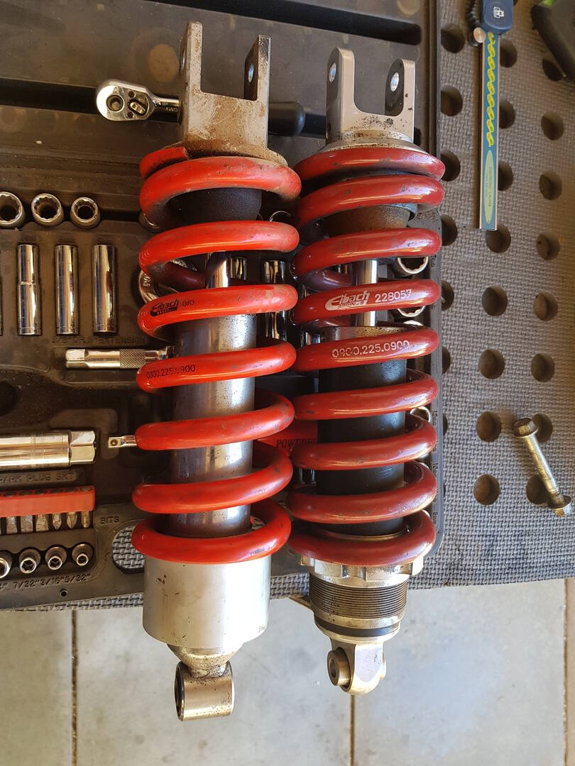

Leading legs do the job steering effort wise so that's  a good start.
Being an older machine does it already have an aftermarket rear shock?
If so the spring may have its weight rating written on it?
Clutching at straws I know
Funny I still have the stock 650 shock with a heavier spring sitting on a shelf
Here in Western Australia.
Pop by and we can try it..........
They differ from the thou depending on year etc.
The one on the rig when I sold it was heavier again if I remember correctly.
Found the picture if you can read the numbers.
i 9rHWvCh X4
Posted : November 23, 2025 9:04 am
