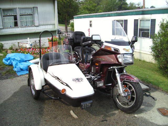

I have a 87 goldwing with a 80 Velorex 560 I have upgraded all mounts and struts with biger tubes and went to a 1inch axle no upgrade to shock or swing arm I know that this is not the ideal rig for bike but the price was good FREE when i take a hard left turn the bike and sidecar dives down what other upgrades do i have to do fix this

The pictured sidecar is a 562E (for economy or Euro) Velorex 562/03 sidecar. These lightweight models were built for the 350cc to 500cc Jawas, MZs & CZs and were imported up to about 2000 for use with light to middleweight motorcycles.
They had a 15mm axle and the unadjustable shock was mounted between the axle and swing-arm pivot point. End result is very poor shock resistance leverage, which is fine for a 300# motorcycle but with a large Heavyweight touring bike.
Bike with rider weighs maybe 1,000# +-.The sidecar only weighs 154#. The mounts are also a weak point with the heavy touring bike. You could turn turtle in a hard left downhill turn with drastic results.
A good bike to sidecar weight ratio balance for a nice stable outfit is around 2/3rds bike weight to 1/3rd sidecar weight.
My recommendation is to sell the sidecar and mount another larger sidecar that will support your GL properly and safely under all normal driving conditions.
