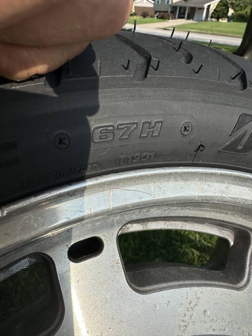

I'm trying to double darkside my 1500 Goldwing. Can not get the bead to seat. I've tried everything. I may have trashed my tire.
I bought a leading link front end from a guy for use with my sidecar. He had a 140/70/18 Shinko REAR tire on the front. I did not get that tire and wheel with my purchase. The OEM size on the front is 130/70/18. I've had more than one person tell me I could go up a size on the front, especially with the room a leading link has. So I ordered a 140/70/18 BT-46. The same size he had.
I had a hell of a time getting the tire on the rim. I have a harbor freight tire machine and a mojo lever. I've never had any trouble getting a tire on. I had to call a friend over for an extra hand. This might be where my trouble began,,,,lol.
We got the tire on but I could not get the bead to seal and take air. I took it to a bike shop. He was back there a long time, but he got it. He said he had a hard time.
I went to put balance beads in, they would not go. There was something broke off in the valve stem. I ordered new valve stems and installed them. Same deal as before. Could not get it to seal. Bike shop was closed so I took it to a car tire shop. He fought it and fought it. Used starting fluid several times. Used an air cannon. He used grease all around it. Still could not get it to seat and take air.

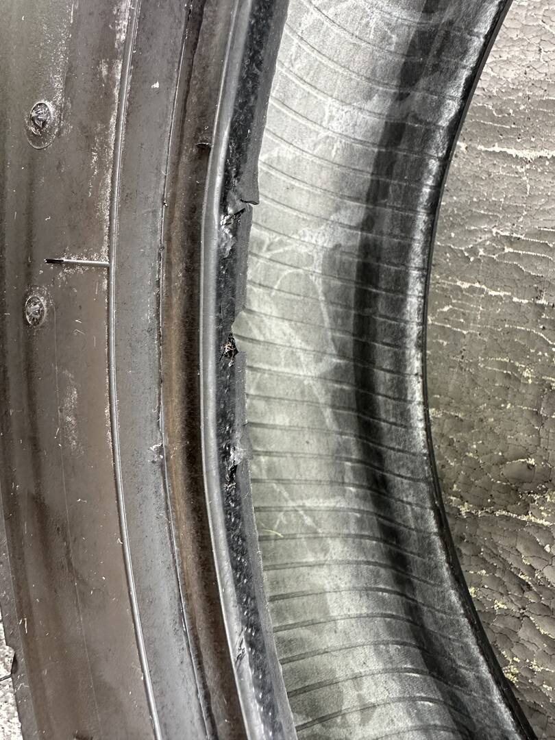

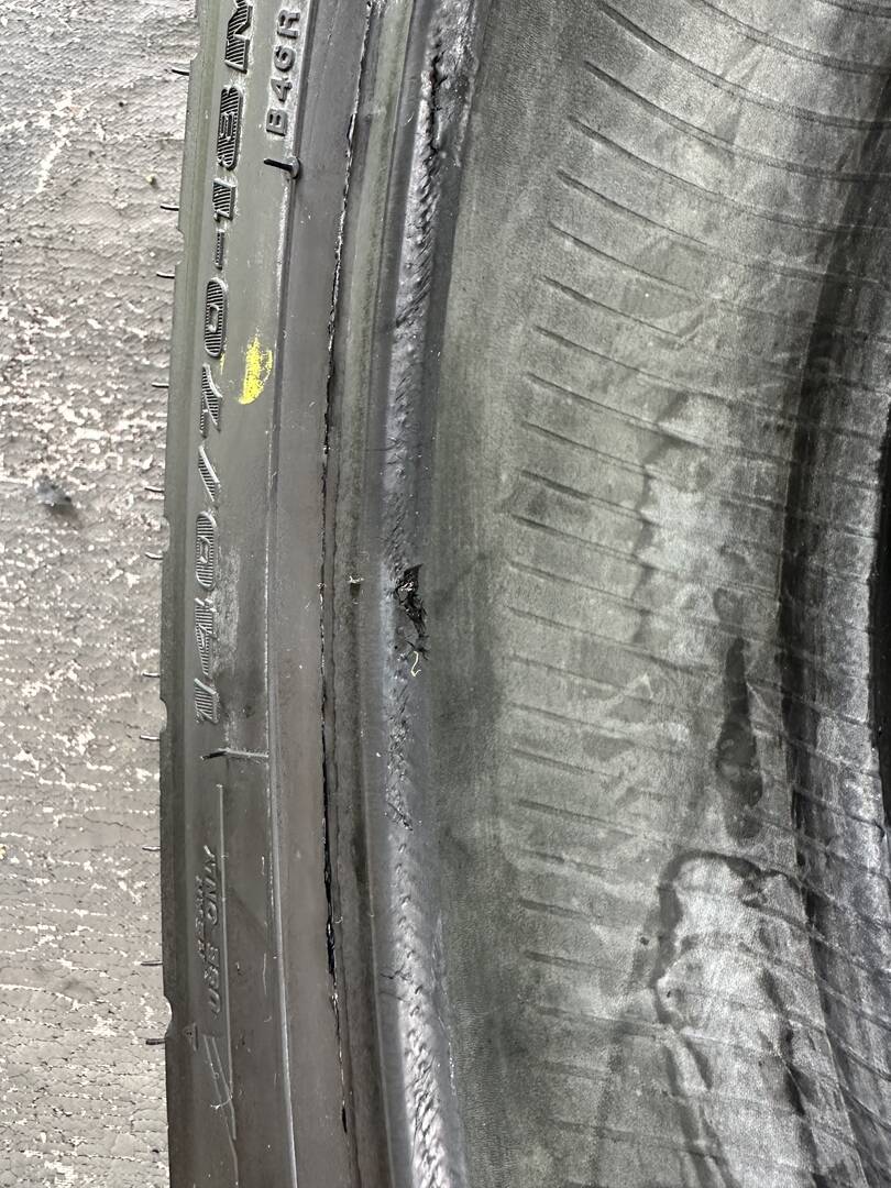

I brought it home and took it off to clean it up and see what I could see. There is tear marks on the inside the horizontal surface of the tire. I don't know if this is a sealing surface or not. I found a pic of a rim and it's called a safety lip on this rim. Not a Goldwing rim. The actual vertical bead sealing surface looks ok. I don't know who did the damage. Don't care. Is the tire trash?
I think the reason I'm having issues is because I'm trying to mount too wide of a REAR tire on the front. But that's just a guess.
So IF this tire is trash, do I just order a proper size front tire, or stay with a proper size rear tire. Or go for the bigger size and just let a shop do it from the start. Will a shop give you any grief about mounting it backwards and a rear tire on the front?

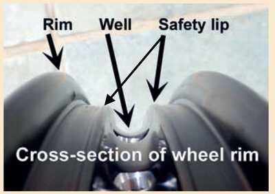

The pic is not a Goldwing rim. But the damage on the tire is where it would seat on what says the safety lip. The gouge in the tire is right where the arrow is touching. It might be too hard to see the tire damage.
The plan right now is to take it back to the bike shop and see what they say, and have them re-seat it.

Calvin,  I  wish I could  help you,  I truly do,  but  not being there,  nor  having my  hands on it,  all I can do is  offer opinions.
This is  an anomaly,  and the  problem is  not the  tire size.
But.....given the  problems  you have  experienced,  and the  tire damage  that  may affect  sealing,  if you  do replace the tire,  buy a 130/70-18 the  next time,  so you  eliminate  that  question.
The shops you  eventually  took it to, will all DENY that they  did the  damage to the  tire. True or not, they will  DENY it.

So in your opinion, is the a sealing surface? Would you run this tire or buy a new one?
Posted : July 21, 2024 9:25 pm
Posts: 1515
Posted by: @calvin-watson
To be frank with you, Calvin..."I" would run that tire, because the damage to the tire that I see in the pictures is NOT at the sealing location. The picture you posted of the WHEEL is vastly different than the wheel you are trying to mount that tire on. The tire sealing surfaces are the lowest vertical section, sealing up against the wheels' highest vertical section.
BUT....having said that....if YOU decide to order a brand new Bridgestone BT-46 in the 130/70-18 size....and get it PROPERLY mounted onto your front wheel....I will reimburse you the cost of that new tire when I see you at the Flint Hills Sidecar Rally.
But me...I would have that current tire installed correctly, and be done with it.
Posted : July 21, 2024 11:57 pm

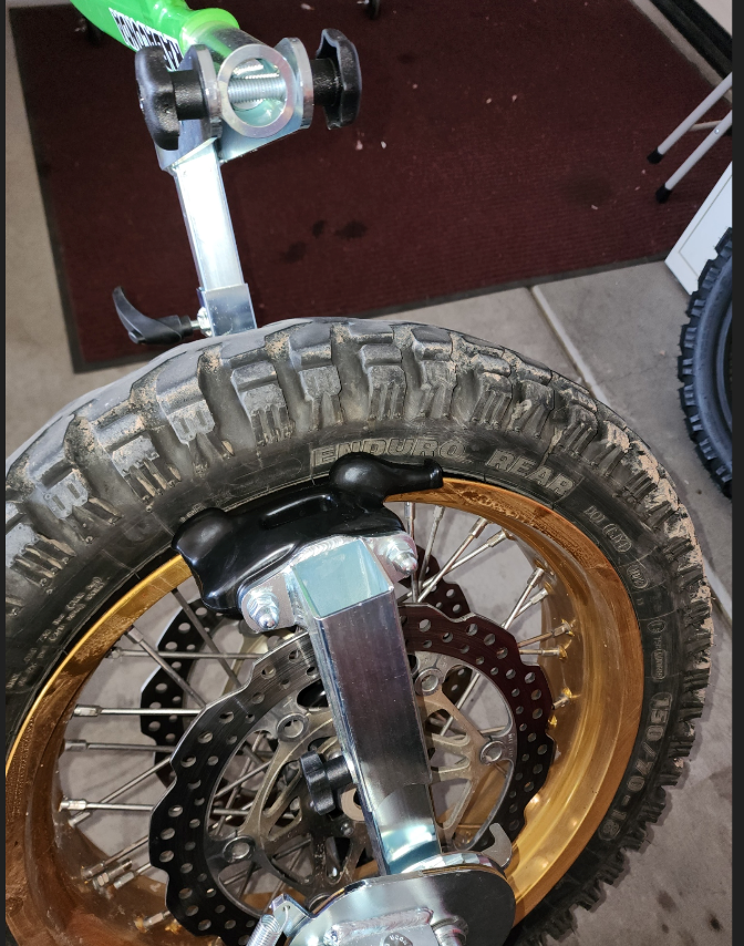

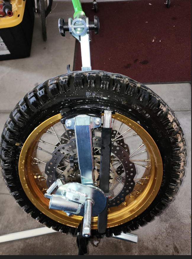

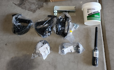

FYI... this tire machine is the schizz: Rabaconda
I go through rear tires at an alarming rate and change out most of my friends tires when they need it.  This thing makes it truly easy.  Watch a few of their many youtube videos and see what you think.  I think it is easier than the HF unit.  I've done at least 15 tires with it, in the last 6 months, and am a very happy customer.
Regarding seating:  The bead grease that Rabaconda includes in their kit is a game changer.  Most of my really stiff sidewall tires (i.e. Mitas E07+ Dakars, Motoz Tractionators, etc) pop at about 15 PSI when I use it generously.  Worst case, I put a ratchet strap around the center of the tire to push the beads out to the rim.  I have never had to resort to lighter fluid tricks to get a seat.  I would use it in a pinch, alongside the road, though.
Glad you got it seated... sounds very frustrating.  I run 150/70-18's on all three wheels, rear tires with the front and the hack wheel mounted backwards to the rotation arrow.  Works great, don't last very long on rear (4,000 or so), but I get about 16,000 miles out of front, and 30,000 and counting out of the hack wheel.
