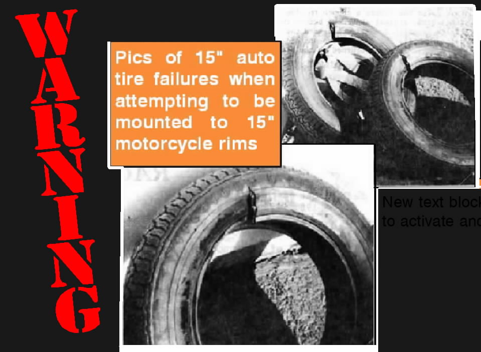

The argument is in regards to 15" motorcycle wheel rim seats being of a larger diameter than auto rims, making it very hard to stretch the car tires enough to seat on bike rims without excessively stretching the tire at the rim beads and causing potential injury, tire failure or even death.
The 16" motorcycle wheel rims are also different sized but the difference is small and they are close enough in dimension that auto tires can be installed.
See attached picture.
Yes, some have been installed with no issues. Some have had failures during installation.
The question is whether any damage was done to the tire that did not show up during installation.
The 15" motorcycle rim is larger in diameter than the 15" car rim at the bead area according to specs so the tire is potentially stressed too much to get it on the rim.
It could be than in some cases maufacturing tolernces are on the large end on the tire and the small end on the rim and things slip on okay. Dunno.
There is still the concern though if any damage did take place during mounting.
If anyone wants to debate this don't bother. It has been discussed here and at other forums time and time again.
Fact is that just because someone mounted a 15" car tire on a 15" cycle rim with no problems it does not mean the next person will have the same outcome.
Fact is according to specs the combination is not compatable.
We would be irresponsible if we did not make this known.
If you want to try it that is your decision and you are responsible for the out come.
If it works for you big deal.
If you blow a tire up in your face and lose and eye or worse it was your decision.
If it mounts just fine and blows a sidewall after a few thousand miles and you crash...well...remember that you were warned.
If you pull it off once and tell someone it is just fine to do as you did and they have an issue you are the one who may have to carry that load.
Sound harsh? Not as harsh as the results that can happen to the unwary. Pretty simple really.
