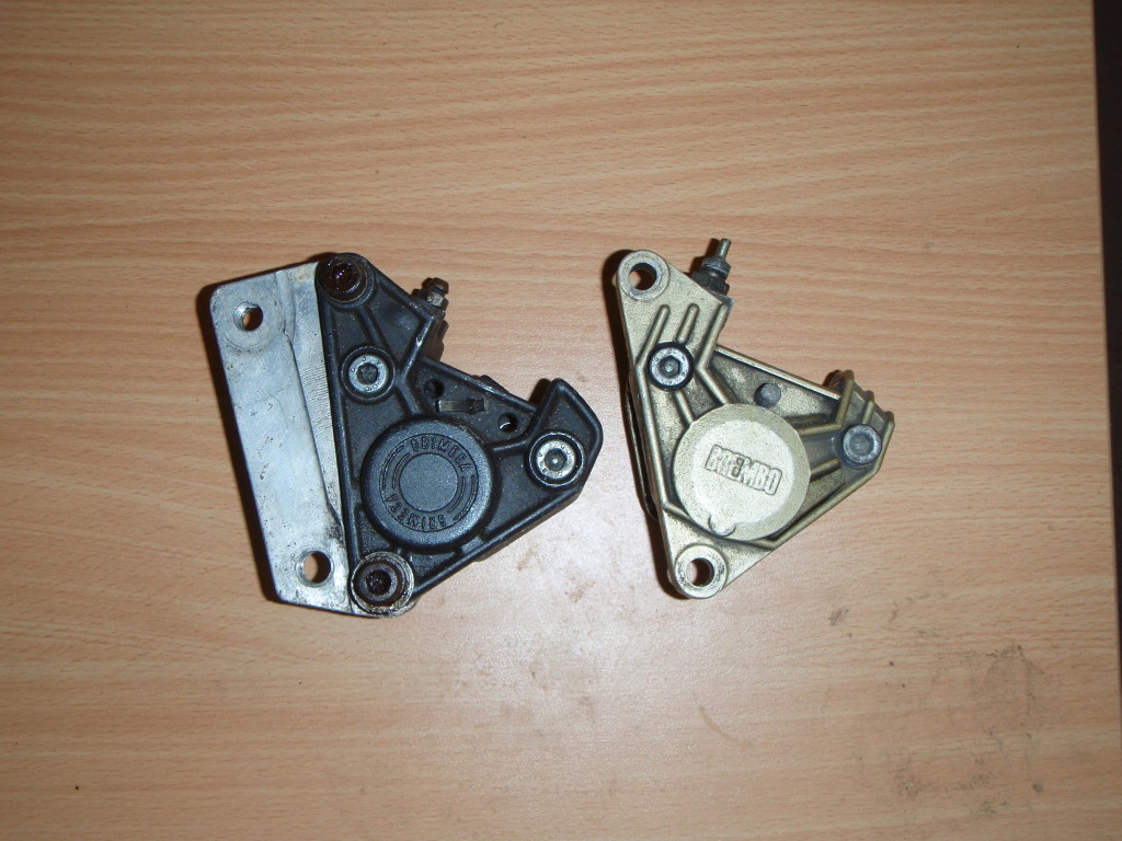

Thanks for the pics.
Yours has a Brembo F04 caliper that has 60mm O.C. mounting holes, the same as the mounting holes in my FS I frame. That caliper has been discontinued by Brembo. I may have a line on a used one though.
Later units use a Brembo P32F caliper with 84mm mounting holes and is readily available.
I wish I knew what other applications use the rotor. CSC literature says it's a Brembo rotor but that's as much as I know. Jason from DMC (jaydmc) said he can get me a rotor and the later caliper and mount. I might just go that route rather than try to piece stuff together.
I can't see for sure but does the rotor bolt directly to the collar that's welded to the back of the hub?

tvking63 - 8/24/2011 10:26 PM Thanks for the pics. Yours has a Brembo F04 caliper that has 60mm O.C. mounting holes, the same as the mounting holes in my FS I frame. That caliper has been discontinued by Brembo. .
I have a perfectly good one, just don't have it mounted on the sidecar. I'm told that the Grimeca B256 and B257, sold by Pingle, is a bolt on interchange with the F04 Brembo.
Pingle is a couple hours from here. Maybe one day I'll ride down and physically compare them.

Cool, that looks like it might work. According to Pingel the B256 and 257 have 41mm pistons. The Brembo F04 has a 32mm pistons so you'd have more leverage but also more pedal or lever travel using 41mm pistons. Or you could compensate by using a larger MC.
I think I'm gonna give them a call.

Just talked to Pingel and they say the B256-257 have 74mm O.C. mounting bolts. So it looks like that's not an option.

tvking63 - 8/25/2011 11:18 AM Just talked to Pingel and they say the B256-257 have 74mm O.C. mounting bolts. So it looks like that's not an option.
Dang, that's too bad. I had two different guys, a Ducati nut and a KTM dealer, each tell me they were a direct replacement. I'll keep digging.
We might not be shot down yet.
I just stumbled across this photo. I wonder if they can identify this Grimeca?

Does anyone have any pics of the later P32F Brembo caliper mounted on a California Sidecar? I'm welding on a new bracket to switch from the discontinued F04 to the P32F and cannot seem to find a location where it will clear the body.

I have the bracket modified to where I think it is going to work. But to weld it on, it would be easier/better if the control arm were off the frame. So I decide to wait until the weather killed the riding season to take it apart. That time is approaching pretty quickly.
I don't think I can mount it where the factory F04 caliper is, there just isn't enough room and the caliper hits the body. That's why I was asking for pics to see is the relief in the body is different than mine. With my body it will have to be closer to the 9 o'clock position.
