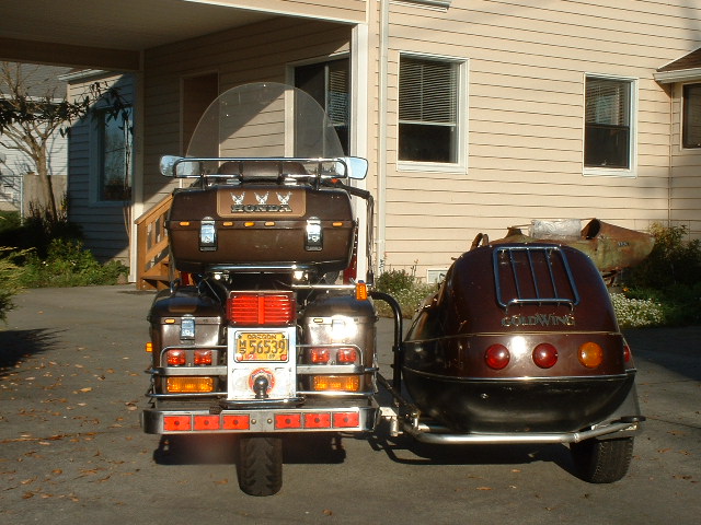

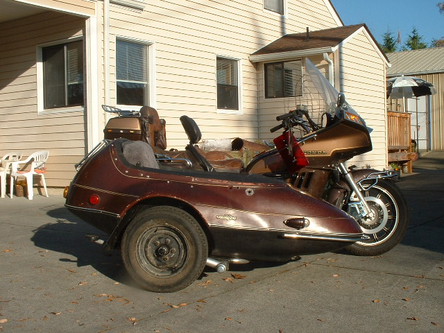

Take a look at the difference in color on my frame.
The unpainted part on top was added on to make the frame the same length as a Goldwing frame. If yours is an original long frame, it would probably look like the painted part, only longer. I just measured mine. On the short frame, the distance between the lower tubes is 21 inches. On the Goldwing frame it is 27 inches.

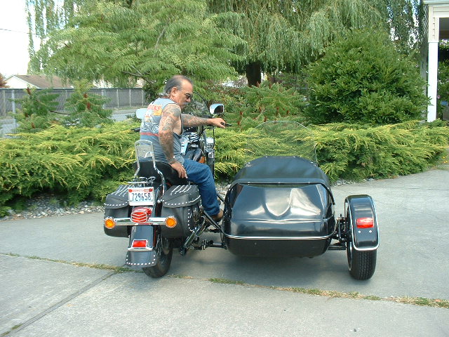

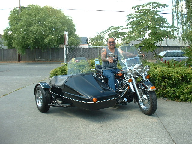

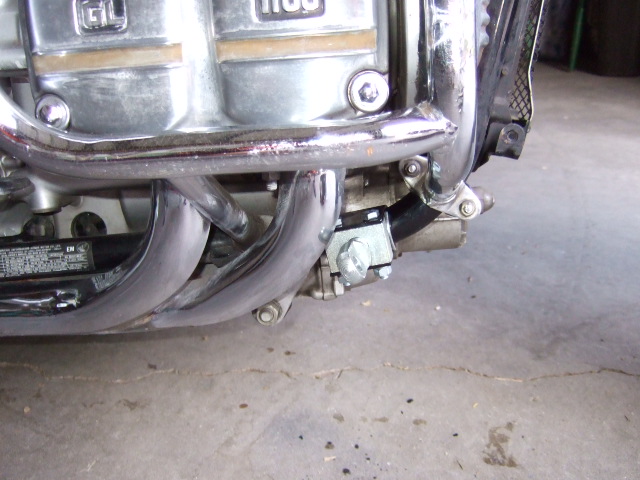

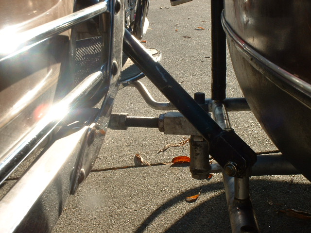

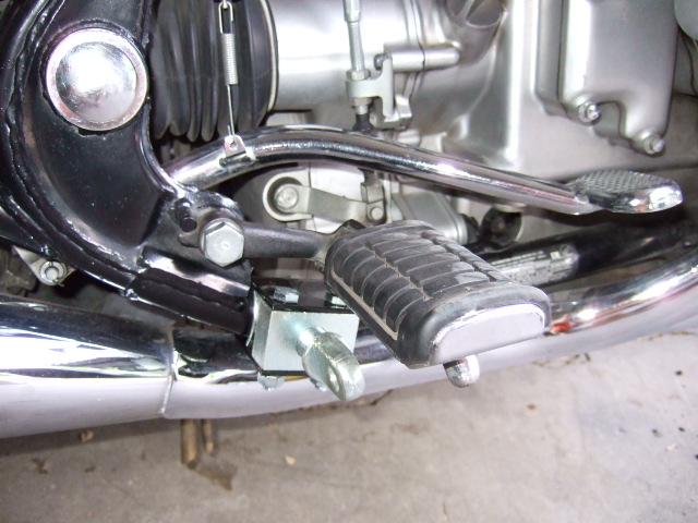

Here's one of the last Twinstars. I mounted it shortly before the fire in Texas burnt up the molds. The GL/Gemini will mount up about the same as this Heritage. I used Heim joint lowers and clevis eye strut mounts on this one.

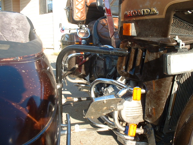

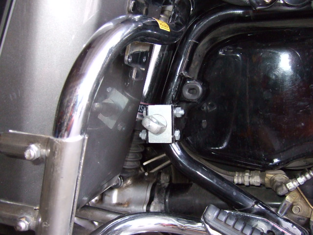

Here are the positions I use on the 1100 GL's for eye bolt type mounting.
Posted : May 18, 2011 10:23 am
Hack'n - 5/18/2011 3:23 PM Here's one of the last Twinstars. I mounted it shortly before the fire in Texas burnt up the molds. The GL/Gemini will mount up about the same as this Heritage. I used Heim joint lowers and clevis eye strut mounts on this one. Here are the positions I use on the 1100 GL's for eye bolt type mounting. Lonnie
Those spots are nearly identical to my GL1200. The front lower fairing wasn't even altered. You simply remove one of the vents. All I had to alter was to trim the back edge of the side cover. After I sold the sidecar, the sidecover looked fine unless you removed it from the bike. Otherwise you couldn't see it had been altered.

The photos and the info on dealing with body panels is EXTREAMLY valuable and AMAZINGLY TIMELY!! I have basically the same mounts, brand new heims on the bottoms and the original clevis joints. Not quite a polished and pretty as those in your photos, but functionally identical.
I'll have to get down on the ground to see if I can get a shackel on the lower frame forward of the exhaust headers. I seem to recall some interference there. If it's the engine guard, that can come off as I'll have a whole sidecar protecting that side of the engine soon!
