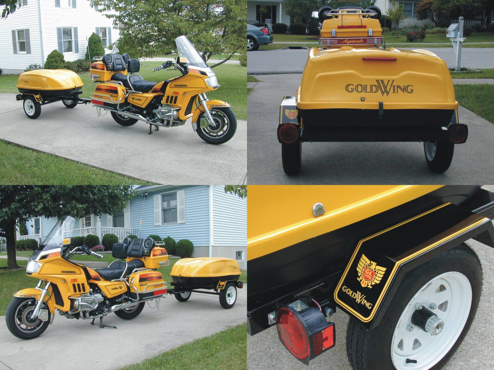

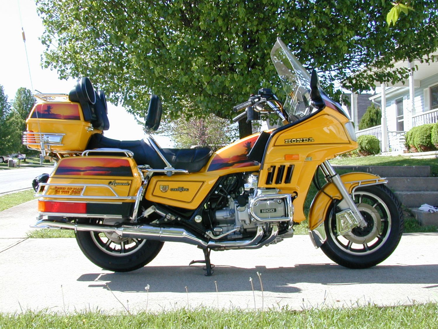

Don't mean to sidetrack this post... I do want to find parts for my rig....
but, here's a pic of my bike with the trailer/graphics I did.
Don W.
Posted : November 15, 2011 3:14 am
