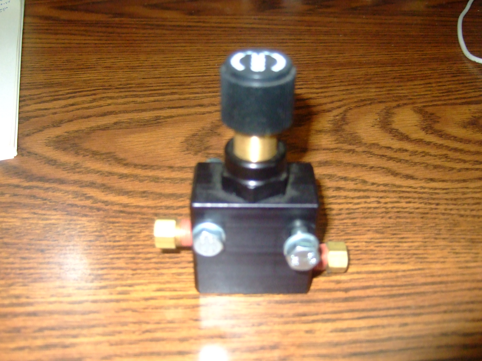

The aftermarket proportional brake setups for bikes consist of an adjustable proportioning valve placed in a brake circuit that controls the amount of fluid going to the slave cylinder to obtain a balance of braking control between the bike and the sidecar.

The doublewide cars are the only ones I prefer to have brakes. If you decide to go with brakes I have a compact (new) proportioning valve for $50. Measures only1"x1 3/4"x 3" high.
