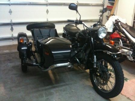

here we go, a couple of pics of the new (2007) URAL Tourist. the thing is a beauty.

Dog and Chauffeur look happy. Be careful. Jena and I both suggest a sidecar training class if available in your area.
