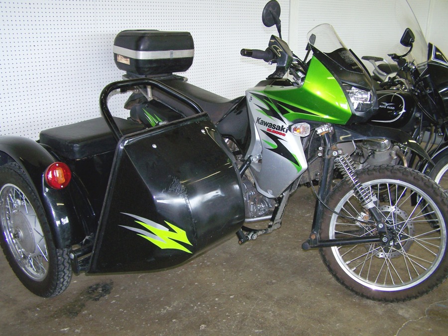

It really gets down to the old Jeep vs Dune buggy argument. Yes there are some places where you can crawl really slowly with the Ural in 2wd that a single wheel drive will not go, but at the end of the day, are these really places you would want to take a nice bike like a GS? For these rare places where 2wd might be handy for a few feet we do offer winches. My own bike in the photo's below "and is for sale" has front and rear Warn 3500 lbs winches with synthetic cables, the only time I have ever used a winch on my bike was to recover another bike that had gone off a bank.
You also asked about kits, we have sidecar kits for every gs ever made except for the HP 2 as every one who has wanted a sidecar for an HP 2 I have told them that the standard GS is a better sidecar bike so they have just purchased another bike. We of course also have kits for the KLR. I prefer the KLR in an off road situation as I will never really care about a KLR and as such will take it places that I will not take the GS not that the GS could not do it, I just treat GS bikes better then the KLR.

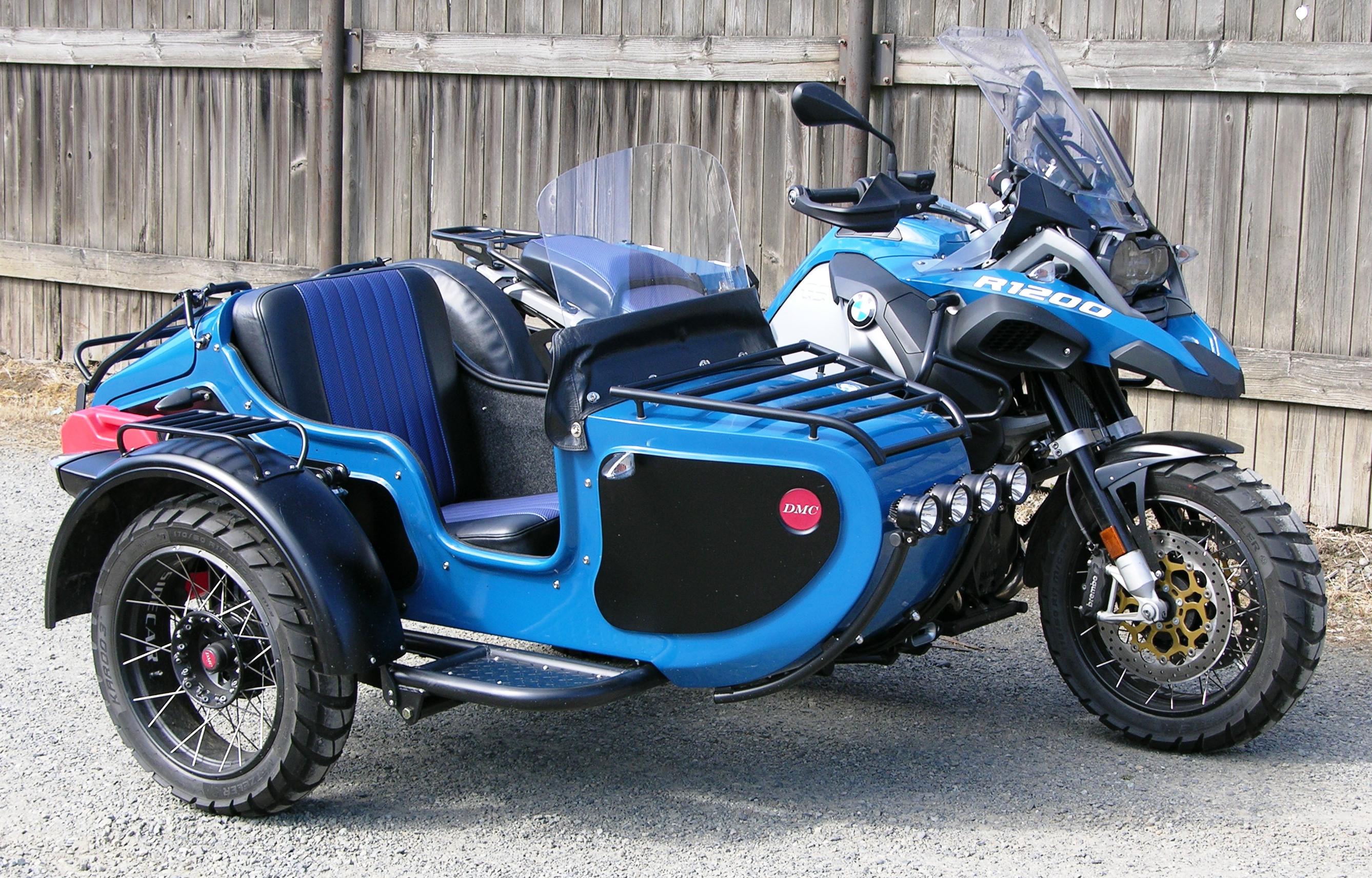

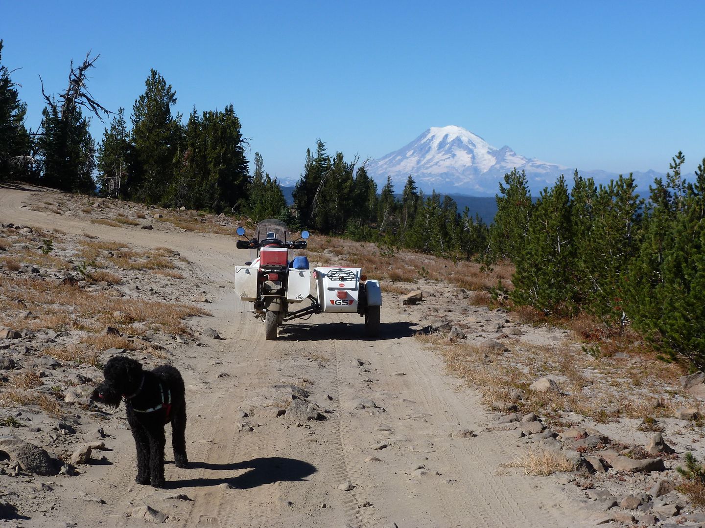

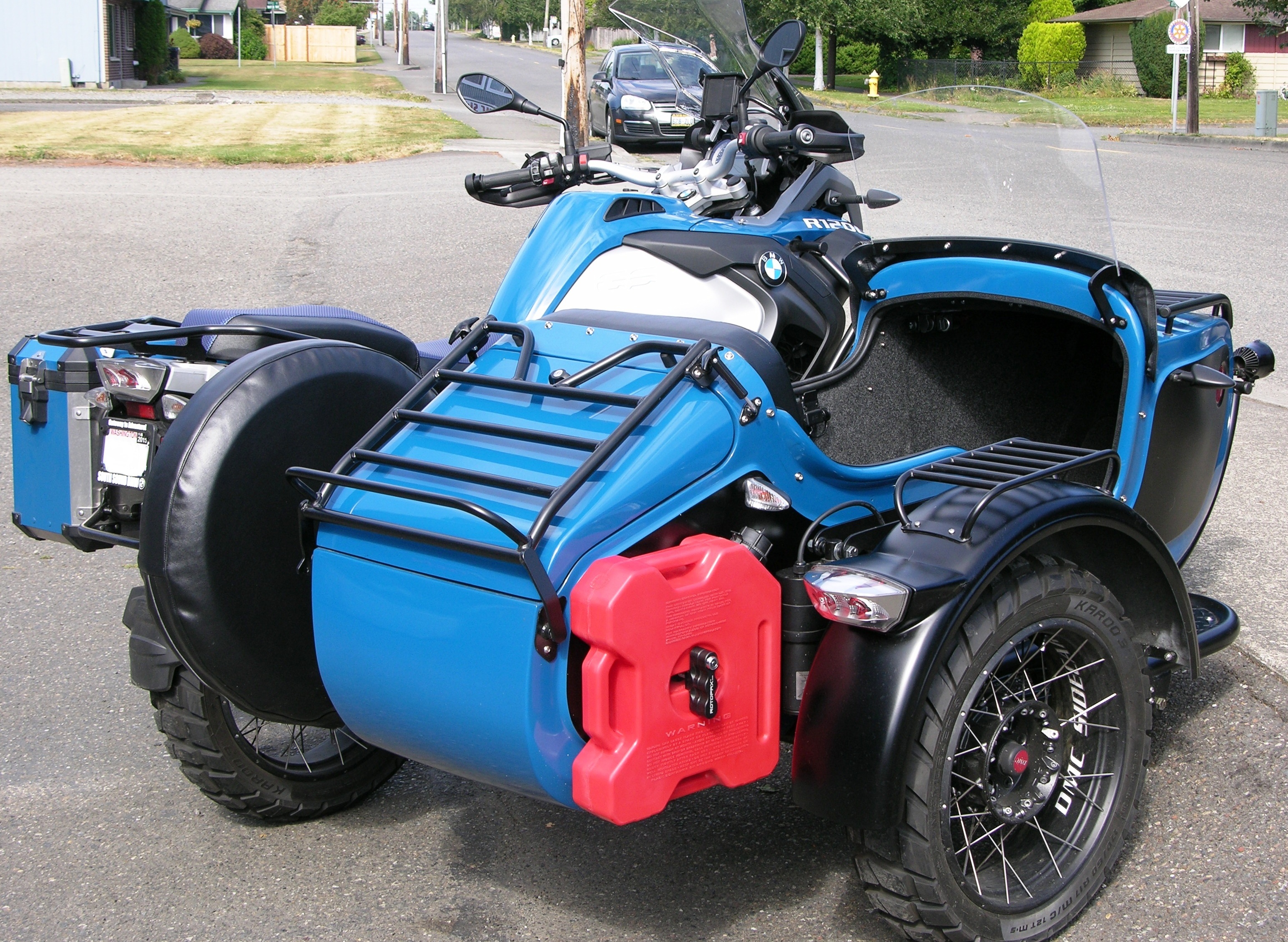

Toyman, in Post #1 you say you want to take a shaft drive BMW hack offroad. I don't know what kind of offroad riding is available in Kansas, but I've been all over the Far West on my shaft drive GS hack (a highly-modified 1150GS Adventure with a DMC sidecar) and I hardly ever go offroad. The occasional farm field, if it's not muddy and fairly flat, or maybe a fairly easy offroad approach to a river bank. But generally never. I'll tackle rocky roads, and muddy roads, and rutted roads, and steep scary roads, and even two-track roads. I've been to a bunch of fire lookouts, and back country high altitude passes, and I even rode the northern half of the Continental Divide Trail (ride report link HERE ). I've ridden thousands of miles on gravel and dirt and rock roads with my GS rig. But to leave the road and just go whooping and hollering through the bush? I don't think I'd get very far. You can get to some amazing places in a regular one-wheel drive GS hack, but I think going offroad is just not very feasible.
I'll toss in a pic. Here's my rig on a dirt road near Yakima, WA with Mt. Rainier in the background and my navigator Kirby in the foreground. Would I like to take a right and just head off into the woods? No.

Very interesting hack on the KLR Jay. I have the same bike solo but a wee bit more scared up. I've found these bikes to be the best compromise for dual purpose.
