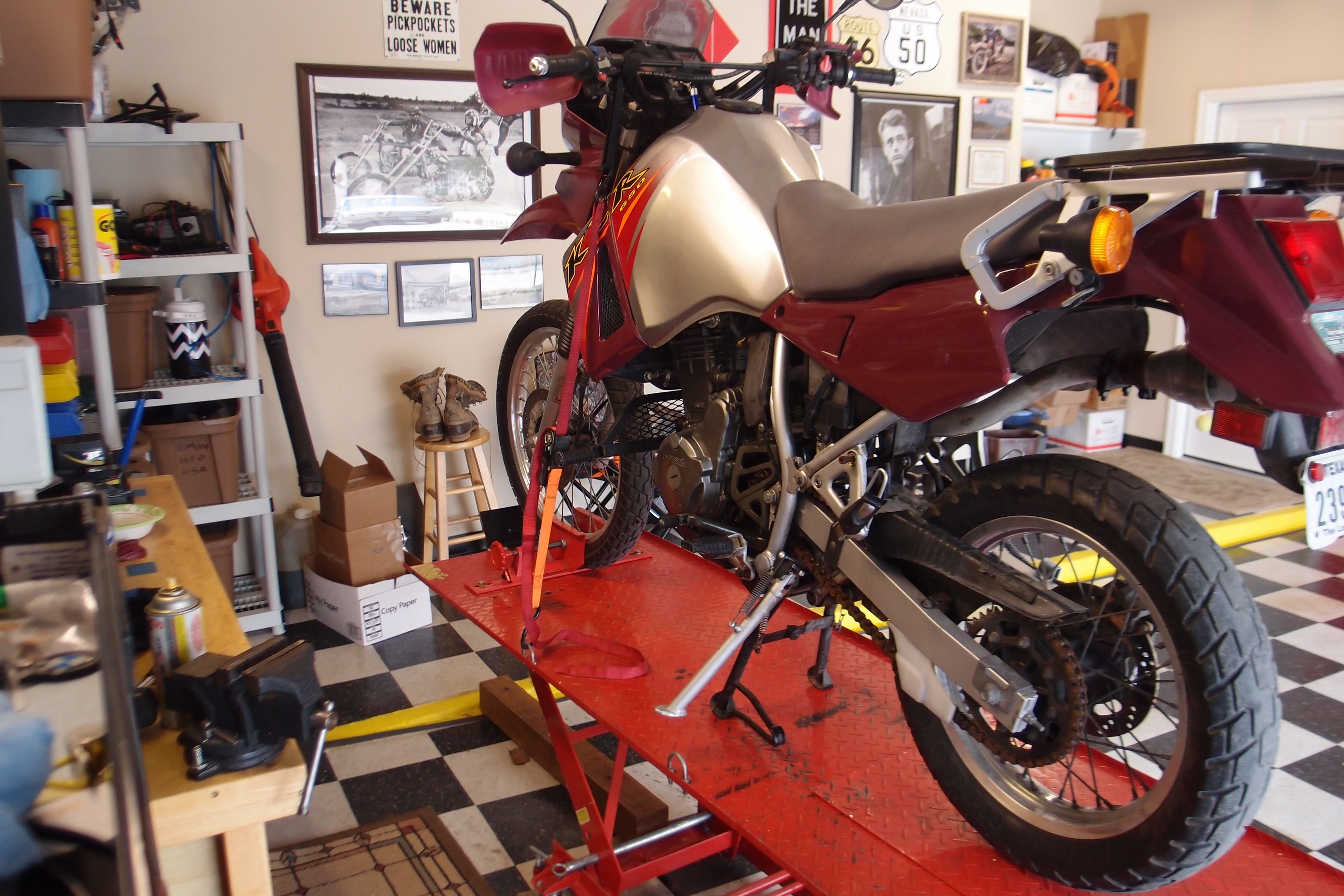

After talking with Jay at DMC about a rolling chassis with a 19" wheel, I looked for a 650cc dual sport locally. Found a 2006 KLR650 with less than 9000 miles. Test rode it and brought it home. Now the fun starts.

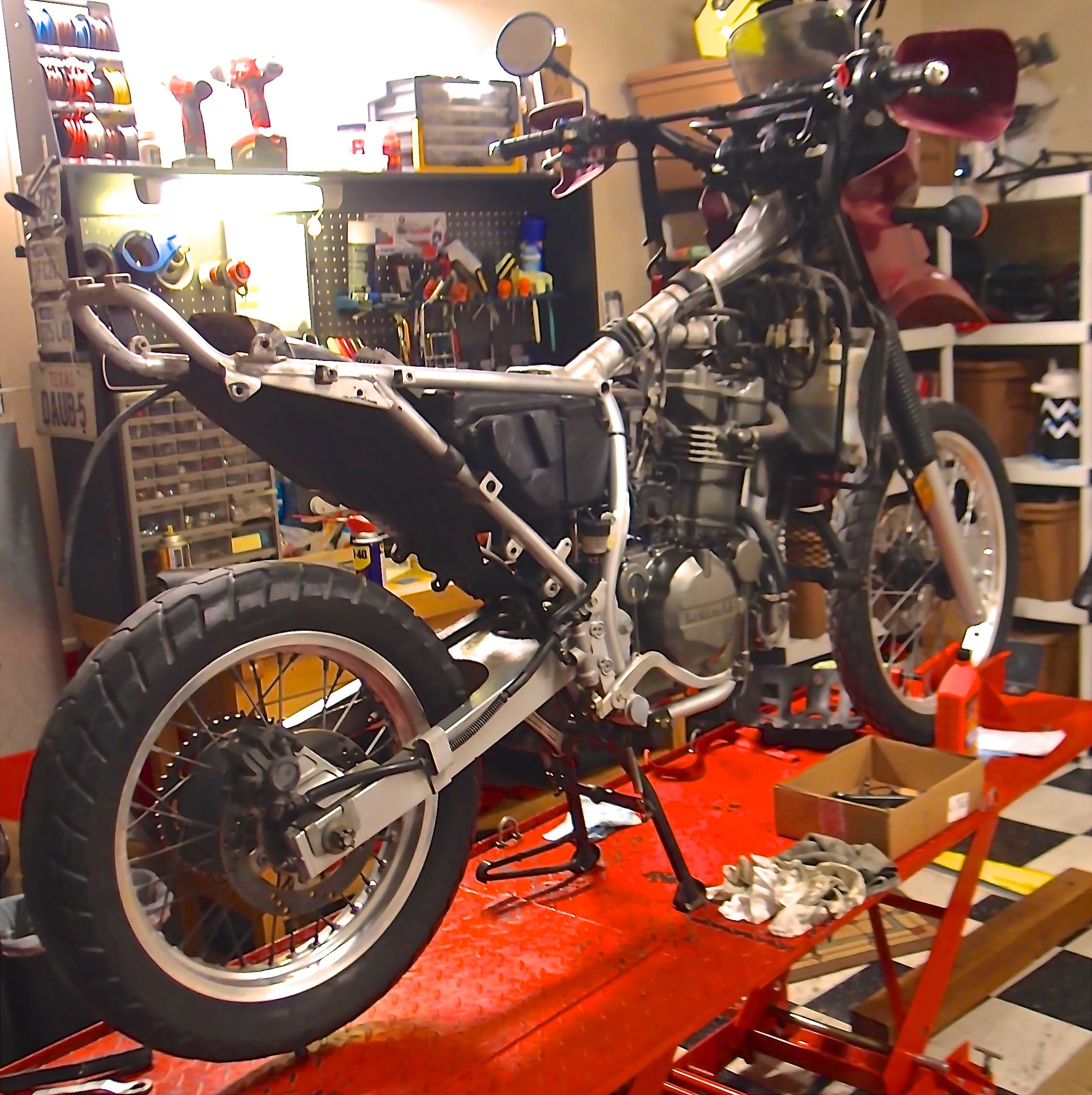

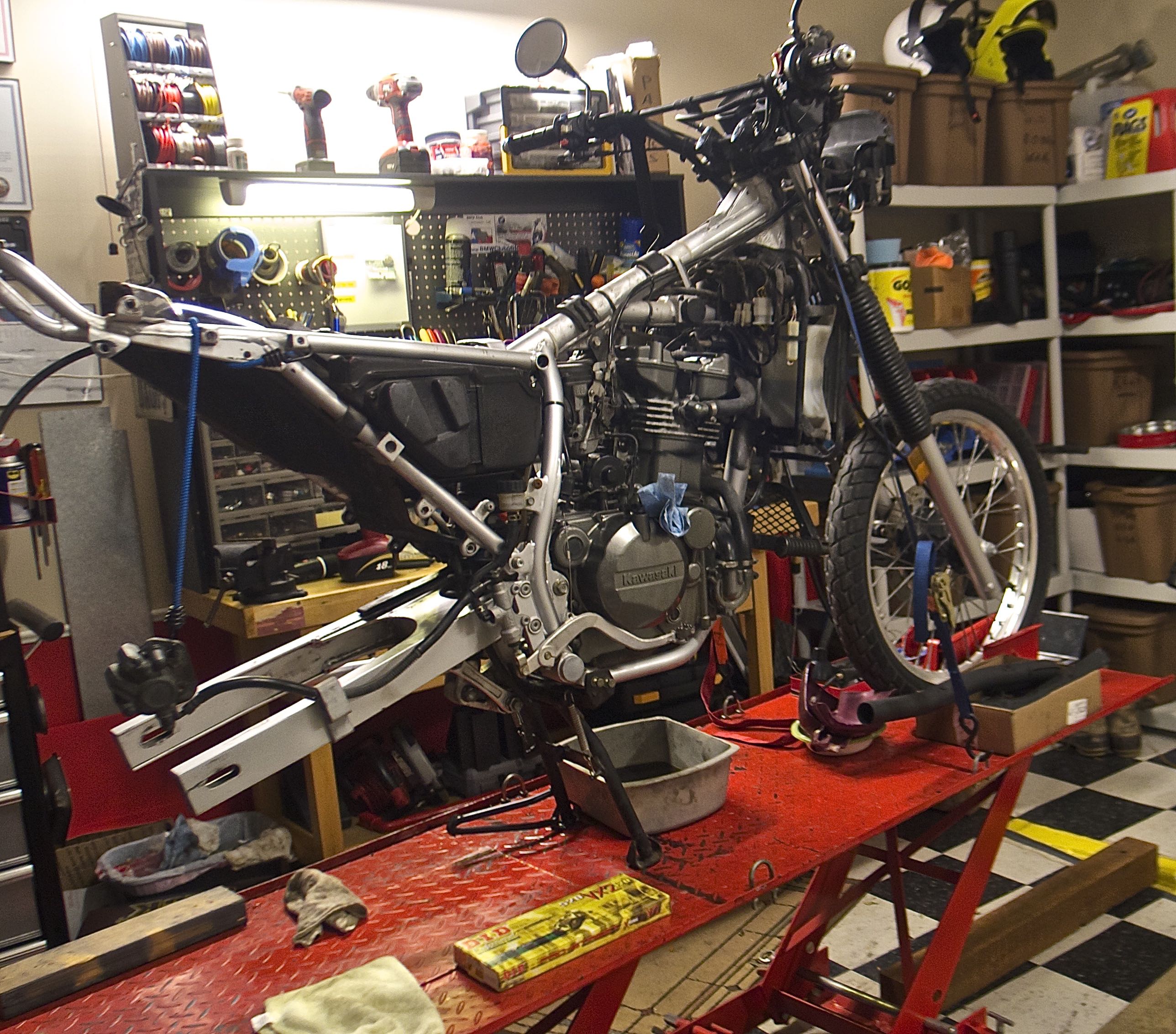

Put it up on the lift Saturday and started stripping pieces off. By Saturday night, was looking like project in motion.

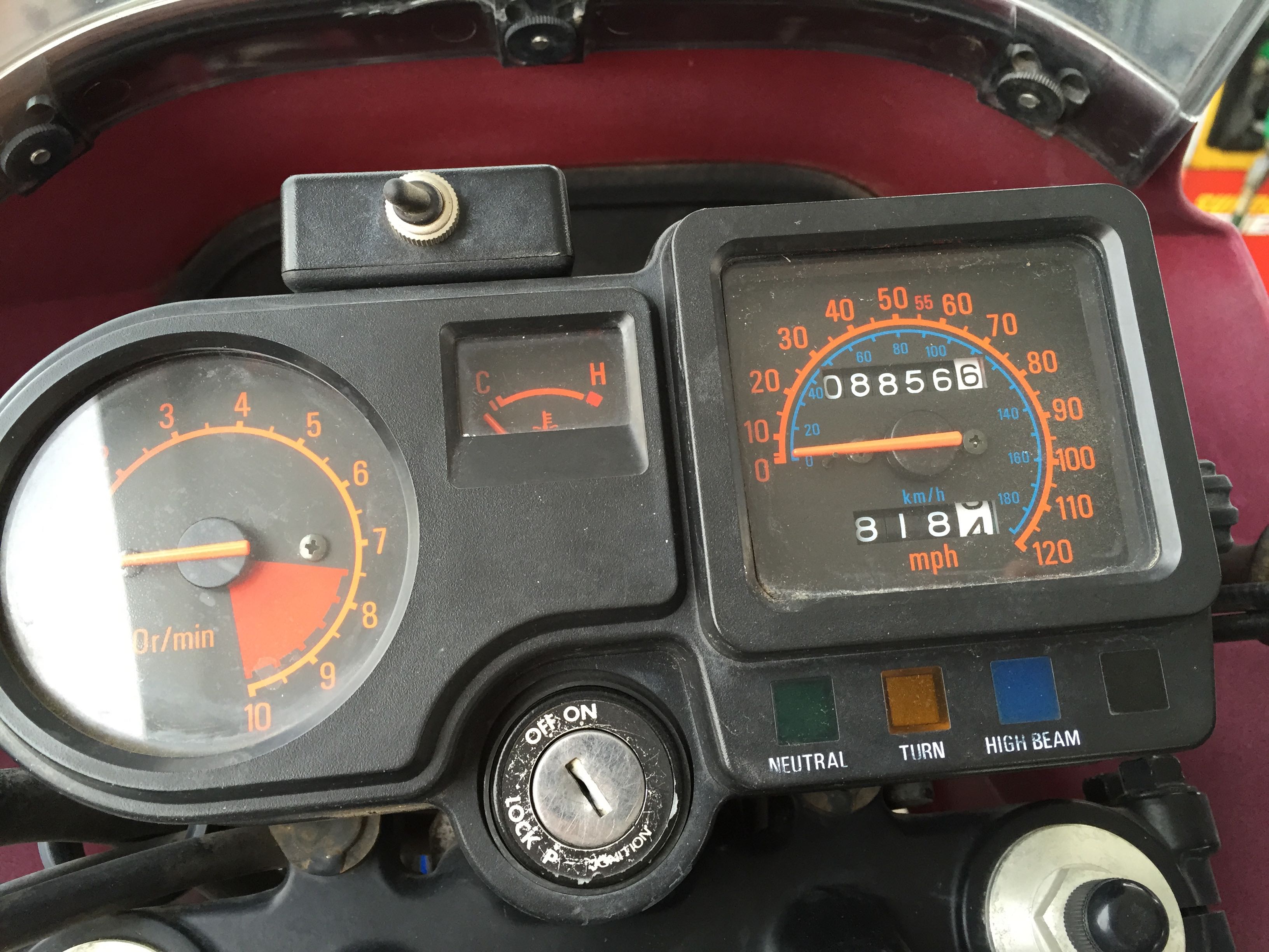

Spotted this switch above the speedo, ask the seller what it was. He said to turn off the headlight if you wanted to run without it. Well, right now that switch does nothing. Might use it to trigger some LED driving lights. When I pull the headlight cover we'll trace the wiring down.
It´s perfect for LED driving lights. On my own bike I would like to have a switch to turn off headlight while starting the bike, if it´s not automatically switching off itself. That sometimes makes the difference between starting the bike under bad conditions or calling for assistance...
Put a 30A relais between switch and light, so the light gets currency directly from the battery and use the switch to cut the relay´s negative ground. You´ll find out that your headlight is +30% and the switch has only to work with milli amperes.
Thanks Claus, will install the 30A relay for the driving lights.

My post was mentioned to the normal headlight, not for the LED driving light. They can be connected w/o a relais. (in case I understood something wrong due to normally speaking German)

Continue stripping parts off the bike. Found many to be rusted so bad they are snapping off. Have relied on a B"LASTER PB a penetrating catalyst to loose nuts and bolts. A steading treatment of spray, waits, wrench, spray again, wait, try again and again. Finally getting the bolt off.

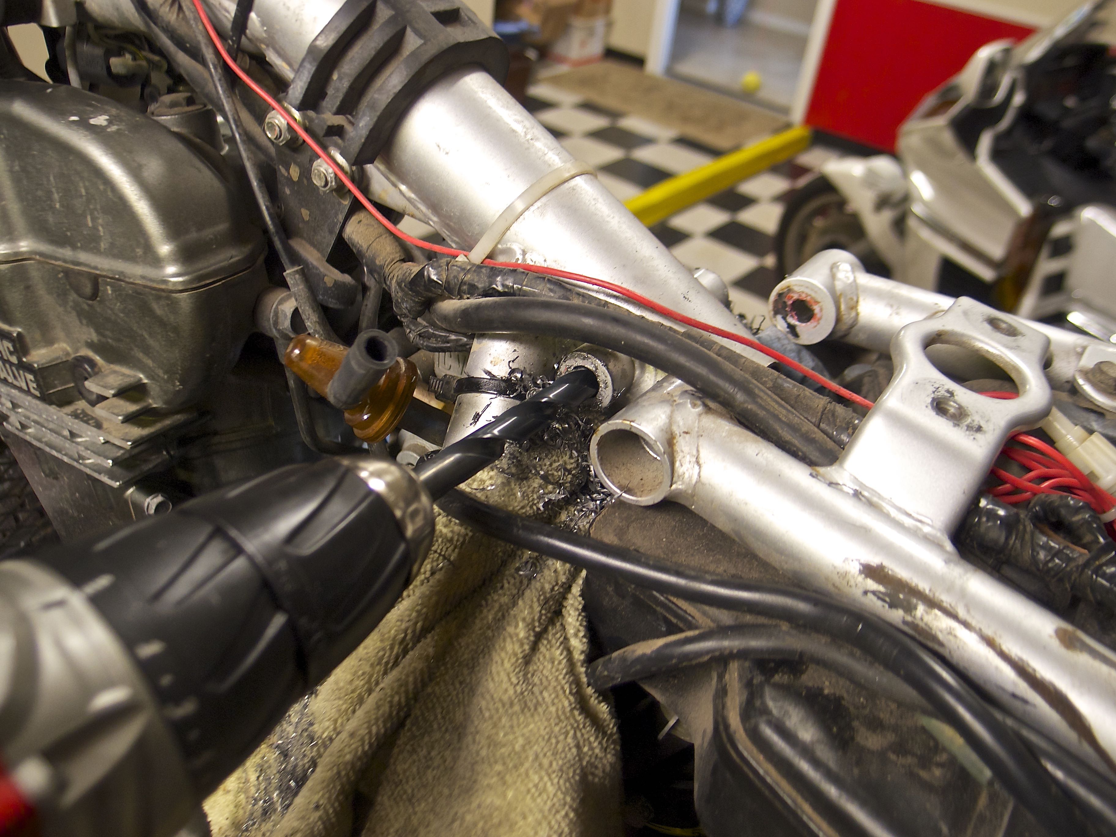

Ordered a subframe reinforcing kit which requires drilling through a solid steel backbone of the KLR.

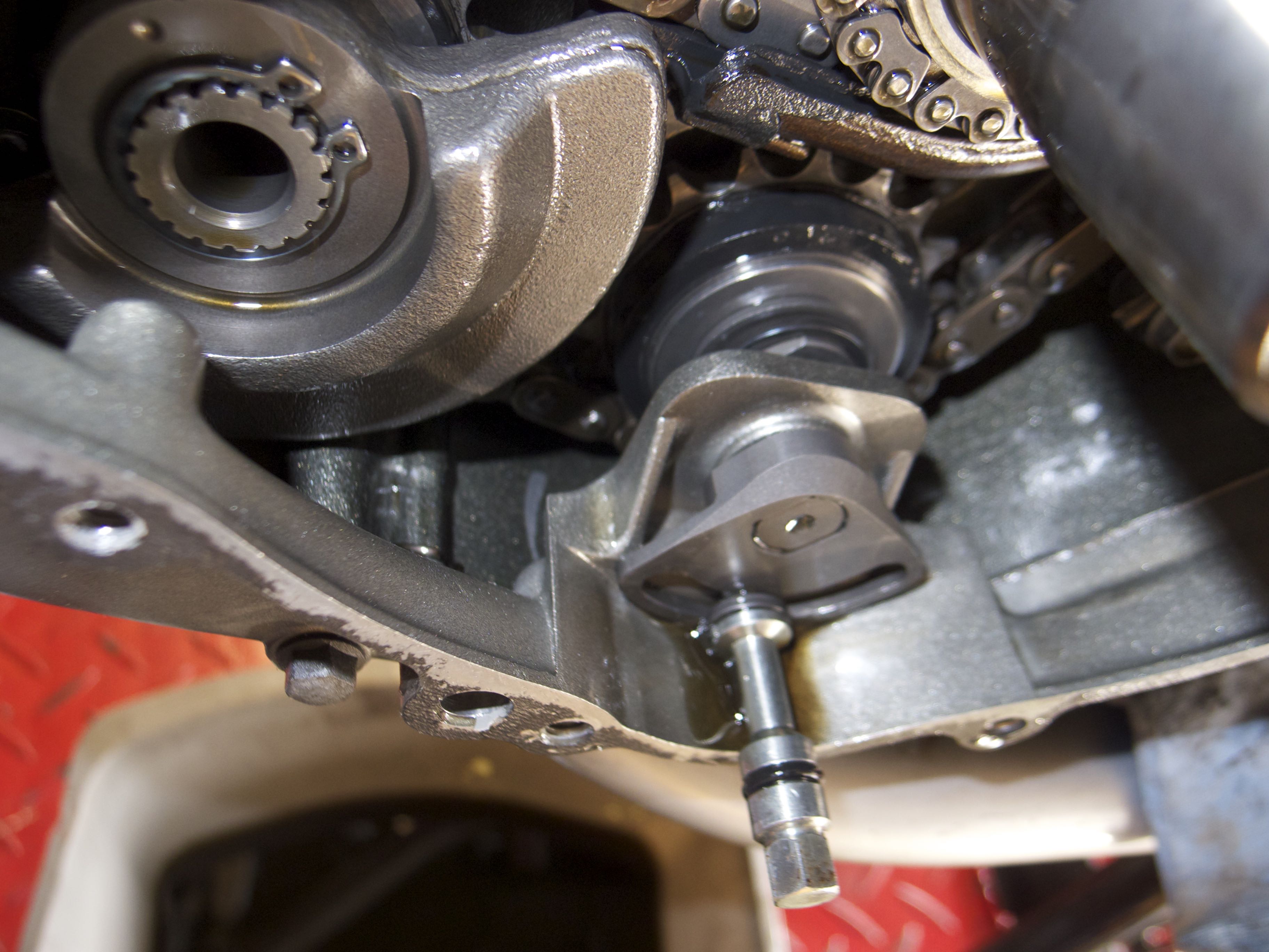

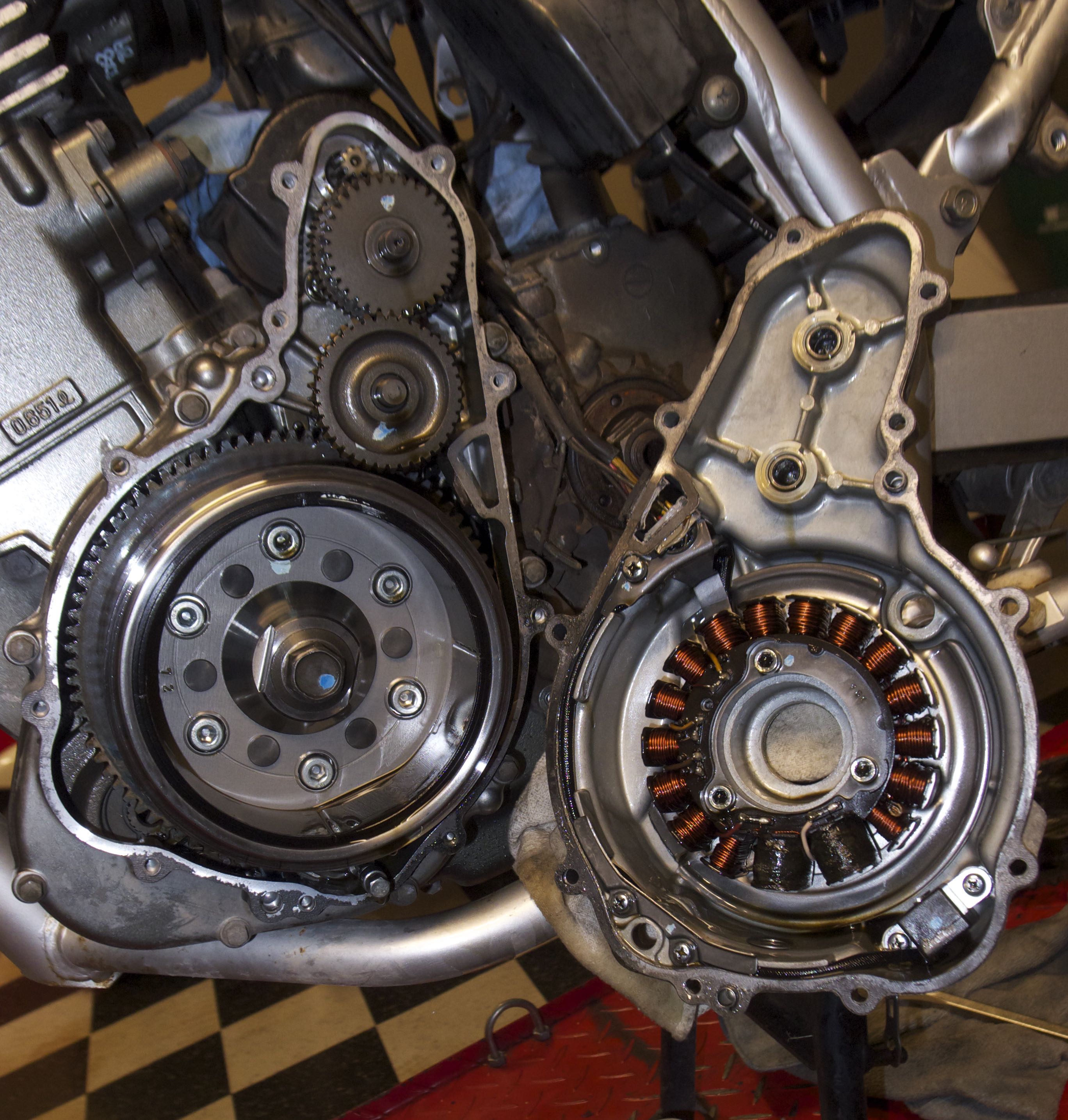

KLR's have a well known achilles heel - commonly referred to as the "doohickey". The Doo is a spring actuated cam chain tensioner. The spring and Doo have been known to break, allowing small steel parts to wander around causing havoc with the engine.
Spotted a posting about how to check if your Doo is okay or not. Requires removing the left side engine cover.
Then look to the left and behind the stub where the Doo pivots. You should see part of the spring. Opened the case but could not see the spring.
