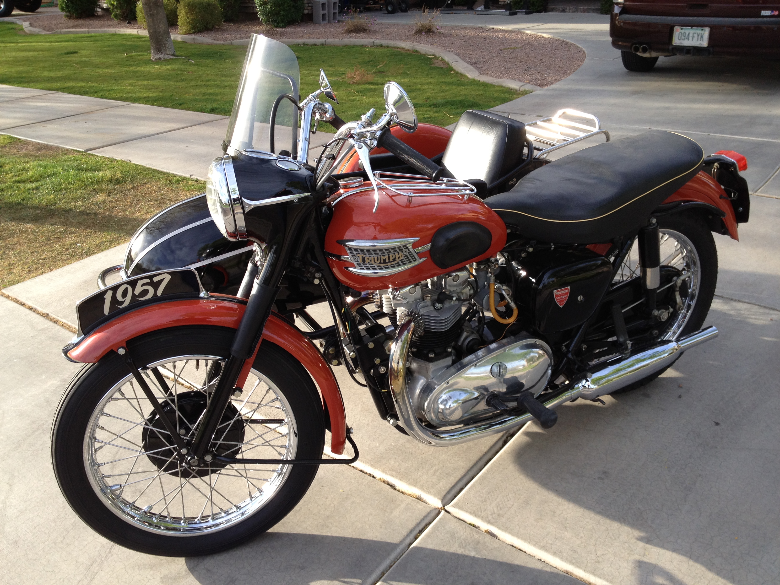

I made contact with Tom Ridyard to set it up. I'll learn from someone that knows what they are doing rather than trial and error.

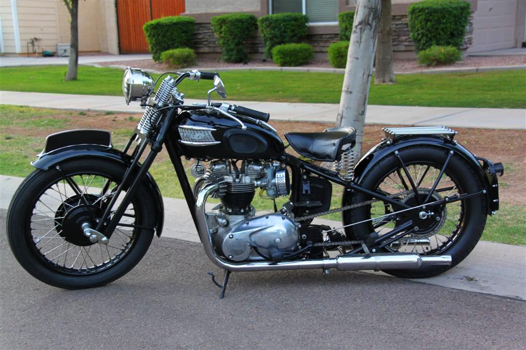

Here is the pics of my rig. I think my plan is to remove the sidecar form my 57T110 and put it on my rigid (pic below) the T110 rides so nice without it, and with it it handles ...like a bike with a sidecar. The rigid already rides bad.

my rigid

One of the true pros here can give you better advice than mine, but I thinhk you'll have trouble mounting a car to your rigid. The rear part of the bike frame is so low that it will be difficult to get decent triangulation with your struts.

I do beleive he is only going to put a sidecar on his swing arm frame.
Posted : November 7, 2012 8:01 am
on the T110 the sidecar attaches both to the swing arm frame and up near the shock top. but the arm is adjustable and pivots. i "think" it will reach the lower frame. but I have emailed Tom to see what he thinks.
Posted : November 7, 2012 8:08 am
that sidecar is gonna look really cool on that old rigid frame bike. johnny
