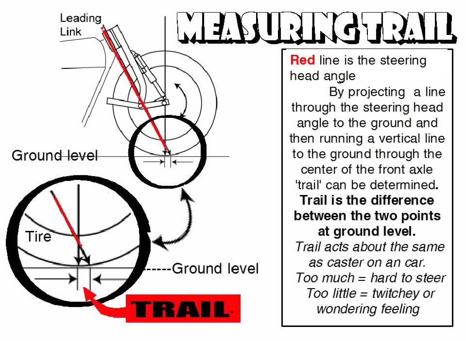

I have attached a picture of how trail is measured. Raising the fork tubes (running them up through the trees) WILL reduce trail a little and also change the steering head angle in relation to the ground slightly. I have noticed some misconception on this a couple of times here so hope the illustration helps. If doing this be sure to check suspension travel for clearance after front end is lowered.Dunno about those chrome sleeves for sure Greg.I would probably not get into this if possible on that bike under your present circustances.

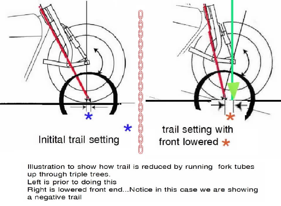

I am having trouble visualizing why lowering the front end would increase trail? Seems like it would decrease it?

Look at the new attached picture below . What isn't considered many times by some is that when running the forks up through the trees the frame will also tilt forward decreasing the steering head angle (rake). All of this together will typically make steering easier and reduce trail . Some bikes are affected more than others. Best to just try it if you wish and see what happens rather than get into a ton of technical stuff.

Note that my previous post above was edited and a new picture added in case anyone missed it. sorry

Thx for the detail Claude, I have been trying to let the rig do some of the work, and ir does help, however, I didn't realize how much difference the reduced trail makes since both my own rigs had this done before I drove them. I will try the damper 1st. My arms are stronger aready....
