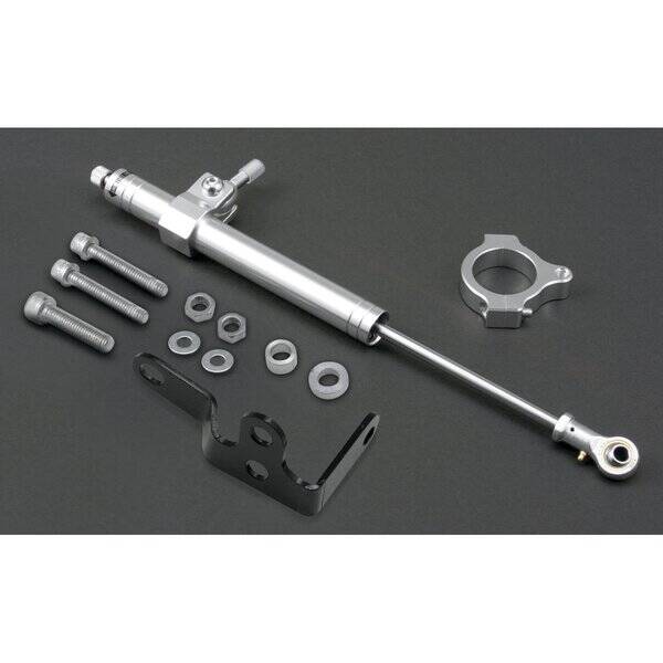

This is the type of damper I have on my rig, adjustable and normally a bolt on item. I stole the pic from the Dennis Kirk site, so check there. I run a Sportster fork on a rigid bike, with an old style ribbed tire. I don't have any wobble, but that tire grabs every road imperfection and I get a wiggle. The damper helps control that well.
I don't know if you are doing the work, so I won't go into the steering head adjustment (fall away). It is simple, but must be done as the factory manual dictates. The measurements and torque sequence are important, to get it right.
What model Sportster? Some have small narrow handle bars, (XLX style) some are wider, (FXDX style) and some help smaller riders, (super low style). You may be able to give your Wife more mechanical advantage with a bar/riser change. I've done that many times, including for my Wife's Sportsters and Dyna, and also customer bikes.
