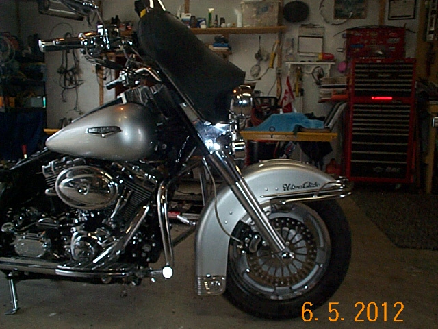

I just installed a set of 5 degree trees...Need to wash the bike solo then rehook the car..
i will let ya no my expierience...
I did mofdify the trees to accept my steering dampner as well..
