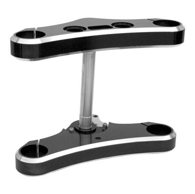

Accutronix Elite Smooth “Nights Series” 49mm Triple Trees are what I used on my Dyna. 5 degree rake. The rig handles great, solo riding is twitchy at 70+mph. On the highway I can one hand it and change lanes very smoothly and naturally. At lower speeds I had some front end shake so I attached a steering damper.
Here you can see where I mounted it.

So has anyone used 3 degree triple trees?
I have been muscleing 03 Fatboy w/ Spyder sidcar around for 2 years now. It handles fine on the highway but mountain driving in the twistys is a real workout.

a fat boy will take stock harley adjustable trees
you can find them old and used on ebay or get repops

well after a long day of research measuring and math I figured out what I wanted and what I wanted to spend. 4 Degree trees on my Fatboy will give me 3.5 inches of trail. The stock Harley Trike has 3.5 inches of trail.
Just to share information or an 03 Fatboy
4 degree triple trees = 3.5 inches trail
5 degrees = 2.9
6 degrees = 2.3
Newer Fatboy's have .5 less angle in the fork. so the math is a bit different.
Hawg Halters, hawghalters.com had 4 degree trees for $657.00
Posted : August 16, 2011 12:45 pm
