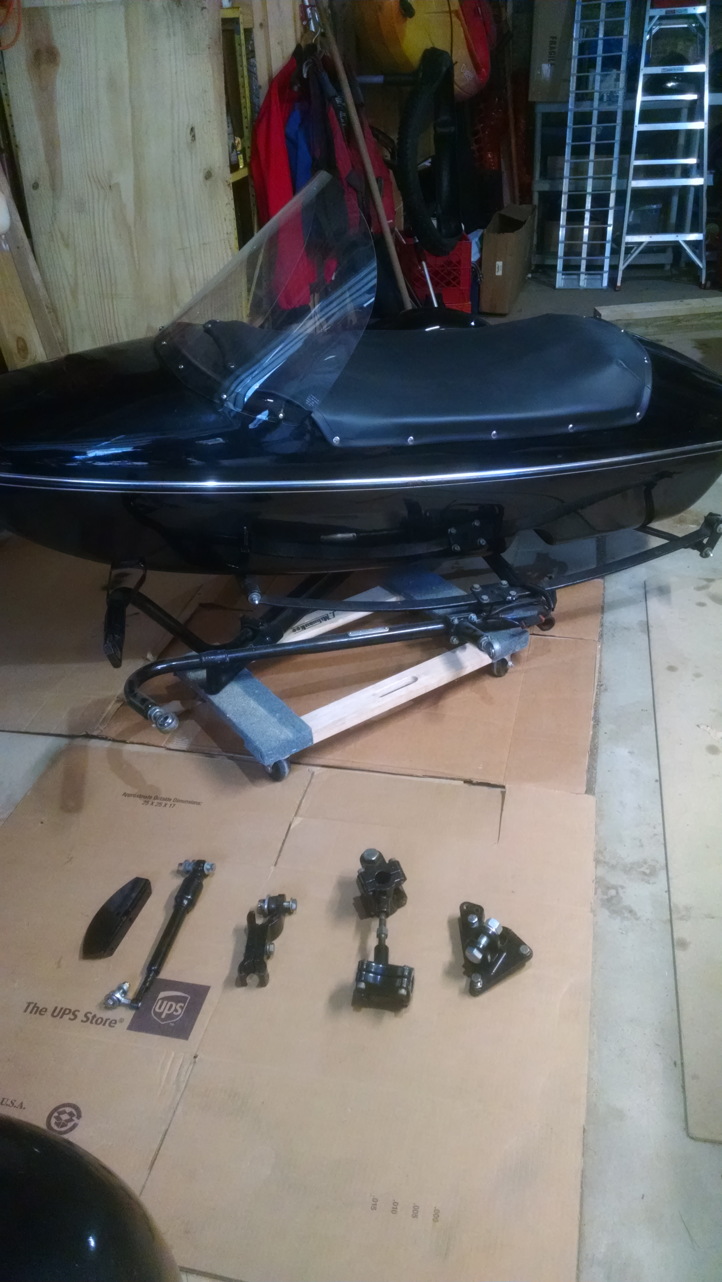

I have a 2007 Road King with Vance and Hines true duals, high flow air intake and Vance and Hines power commander. A few years back a friend of mine gave us a 1999 Harley side car. Let me give you a little back round on why. My son has a disability and loves motorcycles. When I told my friends I was looking for a sidecar for my son, they stepped up to the plate. It is almost brand new. My question is, what do I need to do to get it installed on my 2007 Road king? Can I do it myself or do I need to have someone do it for me? My son would really love it. I have it in my garage right now and Brandon calls it his batman motorcycle. Brandon is 29 with the mind of a 5 year old. If I have to have it mounted, I live in Lake Havasu Arizona. Would anyone know, if I cant do it myself, who could mount it for me. Thank you so much. If I happened to get it mounted I hope to post some pictures

Do you have the bike side mounts? The mounts in this picture are for an older bike but if you have similar parts they should work on your bike. You can mount it yourself if you have a little wrenching ability. I have some H-D sidecar service manuals that can tell you what parts you need with your combination of model years. Post a picture of what parts you have and you will get some advice here. Edit- I forgot I had this, attached is the sidecar mounting instructions for your model year bike. It looks pretty complicated but you can do it.

Looks like I have the exact same side car. I have to order the mounts for my 2007 Roadking since the type of mounts changed I think in 2006. I do know how to wrench a bit. Work on my own diesel power stroke. Do you think I need any extra power on the bike? Someone was trying to sell me an upgrade on the motor. Was the electrical and brake cable easy? Is there a way to do a quick disconnect on the brake line? Also was worried about the alignment of the tire. Guess it will all be explained in the service manual I ordered.

I have a 1993 Tour Glide with an Evo engine so my setup isn't exactly like what you will have. Mine could use more power, but I think yours should be pretty good already with what you've upgraded. The electrical is easy since there are only a few wires, there may be a sidecar harness available that would make it really easy, plug-in installation if you have the right connector on the sidecar. There should be a part number for that harness in the service manual you're getting. I don't have a quick disconnect on my brakes since mine is my sidecar only bike but there is something available that people have used. If you search around this forum you should be able to find a description of that fitting. Alignment is a little bit of a chore depending on the model year of the sidecar. Later Harley sidecars have threaded adjusters that allow you to change the toe-in easily but older models don't have them and you need to disconnect the sidecar completely to change the toe-in. I'm not sure what year that changed.

Thank you so much Dave. It looks like my side car has an electrical harness already attached. Will have to wait till the service manual get here. I feel a lot better talking to all of you in doing it myself. It does have the threaded adjustments. My son will really love his "batmobile". I was getting some quotes of thousand dollars and up to install. The parts are going to cost around 800.00. No I can spend the extra cash in getting it painted. Thanks again

the mounts you show are for a older bike - and the most expensive parts of the mount kit are not shown in your picture.
all these tiny parts come in the mount kit box - and are essential to a safe operating unit:
saddle bag latch
oil sender adapter
rear brake line adapter
brake pedal
rear brake cylinder adapter
remote rear brake cylinder reservoir
remote rear brake cylinder hose
tssm sidecar rollover switch
the only part of all of that that a dealer needs to do is activate the rollover switch.
