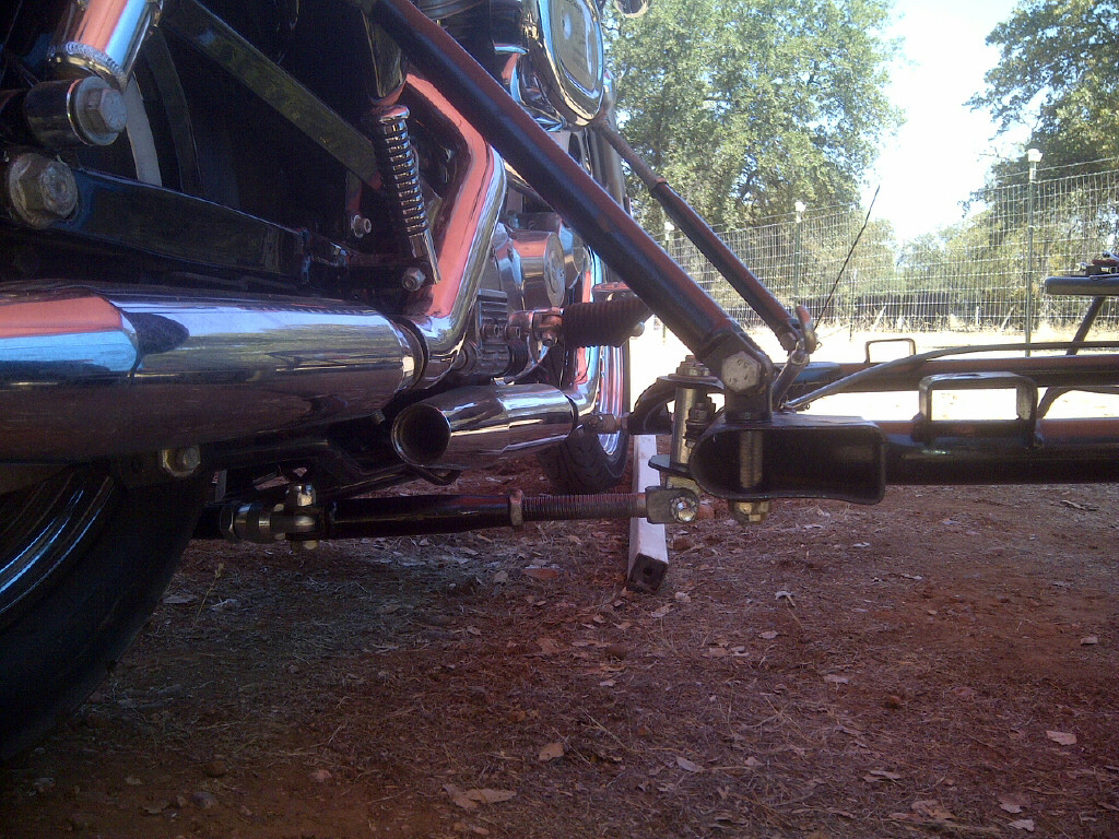

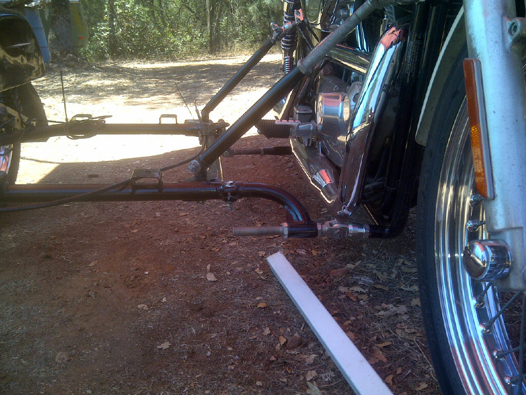

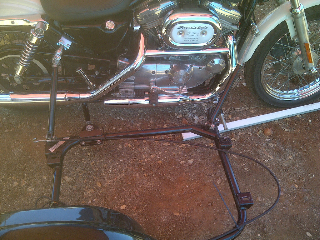

Finally got some time this weekend to join the sidecar to the bike. would like some opnions on the set up. Got this as close as I could with no concrete floor.

It looks OK but watch out for that upper rear clamp. They are known to occasionally twist on the tube. It looks like you have the strut in line with the clamp and that's good.
Posted : July 30, 2013 5:37 am
I attach the rear strut in a different way. By having the strut in a straight line from end to end with the clevis bolts vertical you eliminate one of the two possible slippage points (the 90 degree angled strut clevis to the sidecar frame clamp eyebolt). The remaining slip point is the paint to paint clamp assembly to sidecar frame connection. This can be spot welded to eliminate the possibility of slippage.
Posted : July 30, 2013 6:51 am
I tried to make it look like the photo copy of assembly instructions I had, but I like the idea of the clevis being inline. Haven't taken it on a paved road yet, waiting for neck bearings so I can replace the tree with 5 deg.
Posted : July 30, 2013 5:09 pm
(@Gummiente)
Posts: 119
How much offset (aka wheel lead) are you running? It should be no more than 8"-10", but it's hard to tell from your photos.
Posted : July 31, 2013 4:10 pm
Just a little over 9 inches, about 1/2 inch toe in. I am thinking of using Lonnie's idea for the strut and maybe push the track out a bit. My biggest dilema is trying to set this up for my wife which I out weigh by 140#
Posted : July 31, 2013 6:04 pm
Load the bike and sidecar with the expected weight load and set the lean-out at 1 degree plus using a magnetic angle gauge on the front brake rotor.
That should be a good starting point for her. Minor lean-out tweaking may be needed later depending upon the roads travelled.
High crowned roads may need more lean-out for straight tracking.
Make sure and recheck toe-in after making lean-out adjustments.
Posted : August 1, 2013 4:37 am

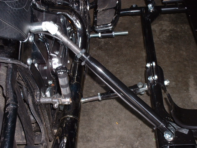

cnntnsxty....how is the rear lower mount attached to the bike? I have an 01 883C Sporty with a Velorex on it and I dont have my lower back that far.
Posted : October 4, 2013 7:07 am
This was done with one of our sub frames, The sub frame attaches to the bike at 7 points and gives you the upper front mount and both lower mounts. We use one of our frame clamps which is similar to but of much higher quality for the upper rear mount.

This sub frame works well. I think it would work better with the adjustable frame connections I seen you use on other cars. I'm still playing with adjustments but the subframe made this much easier.
