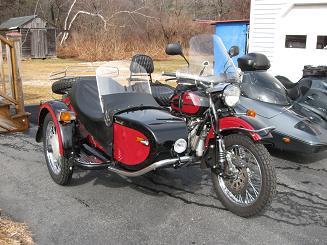

(@ural-driver)
Posts: 13
If you have room , you can have both!! I will try to send pictures. Thanks Jim
Posted : December 14, 2011 1:58 am
(@ural-driver)
Posts: 13
Hi Drone. When I joined the side car club I had the Ural. I found I needed more power for long trips and 2 up. Then stopping was another matter. I bought the BMW with 4 disk brakes, ABS and 60 more Horsepower!!! I had more fun on the URAL. I may have another one. The Ural is gone to a good home and I have a F-650 GS and getting 62 mpg around town. The BMW / Hannigan is my long distance ride for now. X Ural driver.
