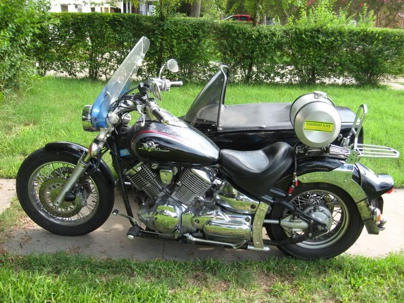

I use a 4 gallon Tour Tank mounted on a fender rack in place of the Pillion seat. It's plumbed into the fuel line with the valve just behind the seat by my left hand. With the 4 gallon auxiliary and the 4.5 gallon main I can get about 300 miles on the highways, slightly less in town.
The TT has internal baffles to prevent and control slosh and is easy to mount. It also comes in a variety of capacities from 1 to 6 gallons. Options are available make it easily detachable if so desired.
Posted : February 7, 2009 7:45 pm

Tour Tank is actually the maker. Their site is listed as Tour Tank. The tanks are all cylindrical to the best of my knowledge.
left profile
4 gallon tour tank
Posted : February 7, 2009 8:24 pm
