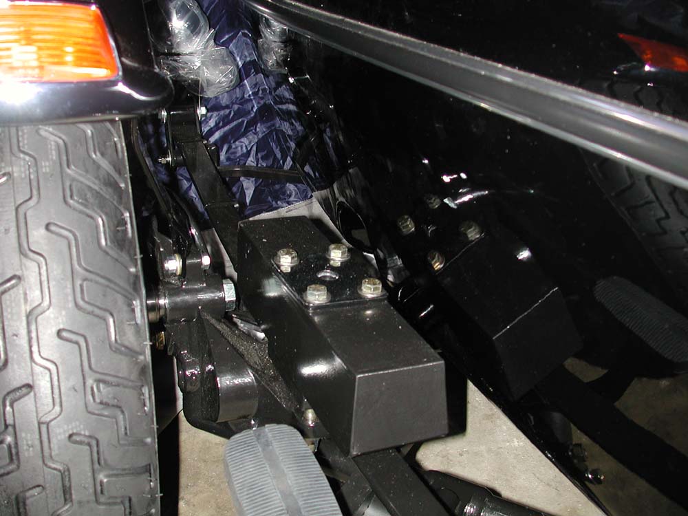

I use a 46 pound weight bolted on the outer frame of my HD sidecar. It's a replica of the 45 pound cast iron ones that HD used to sell. Mine is 1/4" steel plate filled with lead. It's more than enough set out so far.

Here's a picture of the ballast on my HD sidecar. It weighs 46# and seems to work quite well.

Guys, I appreciate the info. The pics really helped out a lot. I think I'll try to fab something using your ideas.

Originally written by gnm109 on 6/5/2007 1:27 PM
Can you give me the demintions of the weight? That is exactly wanted to put on my TLE.
Posted : June 5, 2007 3:22 pm
(@gnm109)
Posts: 1383
Originally written by joejcr on 6/5/2007 6:22 PM
Hi,
It's made of 1/4" steel plate and welded only on the inside to give a cleaner appearance. It's patterned roughly after the former cast-iron weight that HD used to sell.
It's 12-1/2" long, 3" high, 3" wide at the top and 3-1/2" on the bottom. It has a plate of 1/4" steel that is welded across the bottom center. That is about 4" wide to cover the area where the four bolts go through and 3-1/2" across to cover the bottom. The ends are also 1/4" plate to cover the area. The empty shell weighs about 6 pounds.
I also tack-welded four 1" nuts inside the unit, one on each corner. These are used to lock the filler lead in place after it cooled.
After it was welded, we turned it over and leveled it on the ground. We used lead which was bead-blasted clean and cut into small pieces. The unit was heated with a roofer's propane torch and filled with the small pieces. When the lead melted, we put more lead in until the level of lead was close to the edge. It was then allowed to cool. This method is far safer than heating the lead in a pot and pouring it. There is no pouring, the lead merely melts in place. Because the lead was first cleaned of outside impurities, there was no slag at all when it melted. I suspect that the lead that I used was alloyed with antimony as most commercial lead is, since the resultant weight is very hard. I used some antique theater curtain weights that were given to me many years ago but you could just as easily get about 40 # of fish weights - although, you would have to remove the brass hooks when the lead melts if you go that route.
The usual safety and comfort precautions apply: face shield, gloves, long trousers, long sleeves, 6 pack of Budweiser, potato chips, etc.
The result is a very neat weight that came in at 45 pounds, only one pound less than the original style HD 46 pound cast iron weight.
After all was done, it was necessary to drill four 1/2" holes down through the top and through the bottom center plate. The pattern for these was the top spring plate that holds the right spring onto the sidecar frame. These holes clear some longer 7/16" bolts to hold the weight in place over the spring.
The older TLE's, had leaf springs and since 1998 they have had single leaf springs. This design should work with either style. I later decided to add a spacer under the weight to lift the weight clear of the springs. It probably wasn't necessary but I didn't want the springs to slap the bottom on the weight. The spacer was 1/2" steel plate but could just as easily have been aluminum.
In the alternative, if you could find an OEM Harley weight that would also be good. Harley used to make two other accessories for the sidecars that they no longer produce. One was a reverse unit for the earlier sidecars. it had a ring gear that mounted on the brake drum (pre-1998) and a mount for a starter motor and a relay. The lead-acid battery went in the back of the sidecar in the trunk with your $400 leather jacket. LOL.
Harley also used to make a parking brake unit for the sidecar. Apparently the weight, reverse and parking brake didn't sell well so they have been dropped.
I hope this helps.
gnm109
