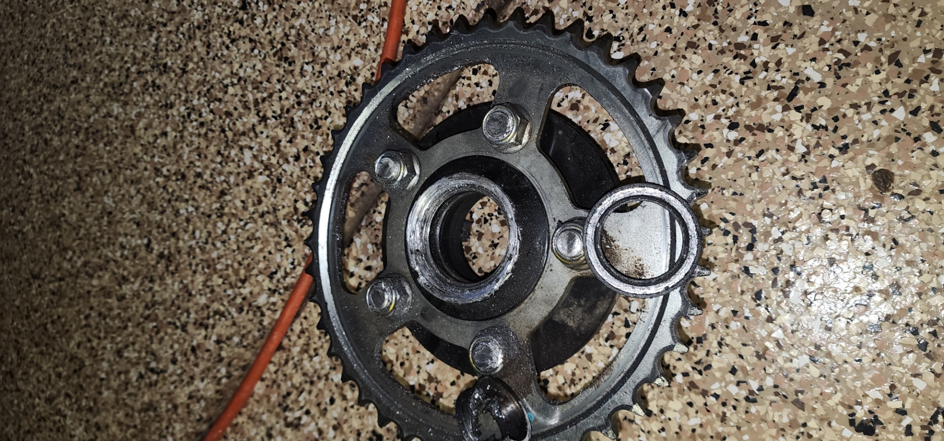

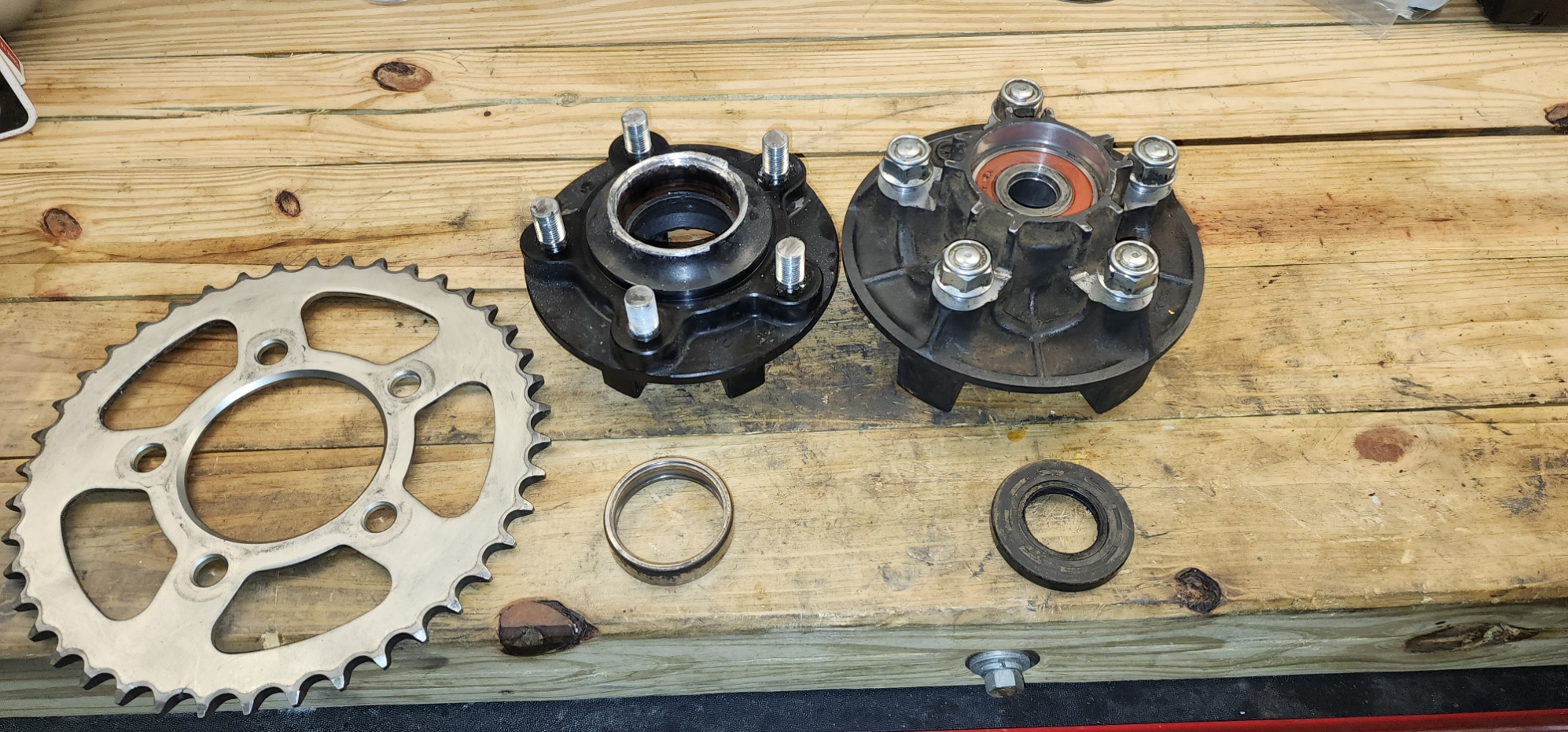

Evidently there was some damage/grit that got into the rear sprocket carrier bearing (think left outer wheel bearing of the 3 bearings on the axle.)  It failed catastrophically last weekend, with about 8000 miles on the hack conversion.  Unfortunately, the bearing came apart and destroyed the pricey Haan Hub that was in the center of the Woody's wheel.  Pic below:

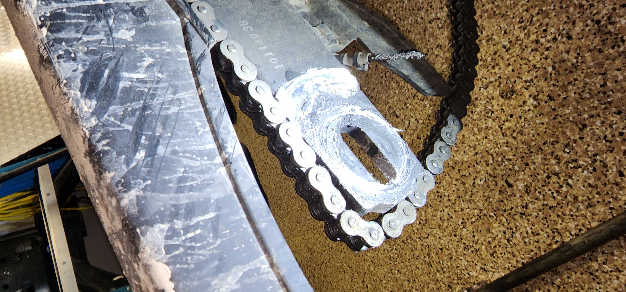

Of course, the bearing failure allowed the sprocket carrier studs to cut a deep groove in the swing arm... sheesh.
Icing on the cake?  Well the Haan Hub actually uses a smaller bearing than the factory set, a 52 mm OD, 20mm ID bearing vs the Honda bearing that is 56mm OD x 22mm ID, and rides on a sleeve to be able to be a larger bearing.   The Haan Cush Drive is also significantly smaller and showing signs of rubber wear at only 8000 miles.  I suspect the Haan hub is underspec'd to be a pusher on a hack.  I will likely figure out a way to get a stout wheel built up for it in the near future, using the OEM hub and cush drive.  Comparison pic below, Haan hub on the left, OEM on the right:
