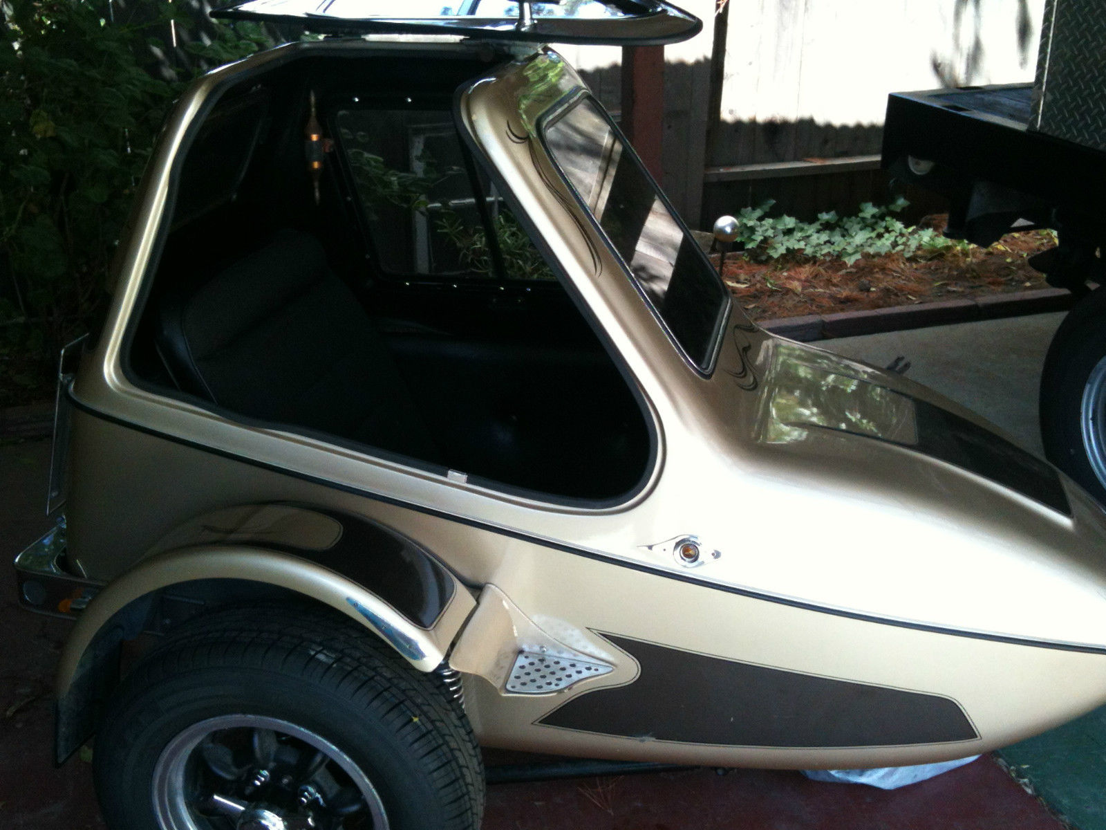

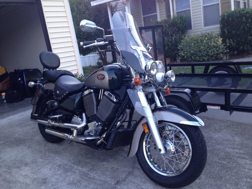

I am looking for the mounting hardware to marry my 2001 Victory 92CL Deluxe Cruiser to my newly acquired used Motorvation Coupe Royal Sidecar. Can any offer up any information to help me along my may. I am located in North Central Florida! 😉

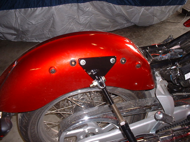

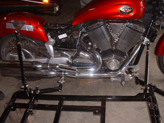

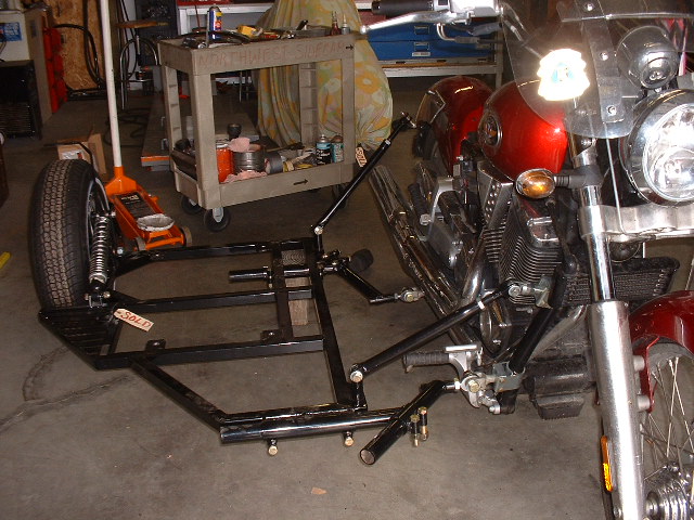

Here's a Victory mounting system using some DMC hardware and my own rear mount and trailer hitch.
Pretty rugged setup since they pulled three people and also pulled a camp trailer with the rig.

Lonnie, you are beautiful people! I have a lot of common sense and I am mechanically inclined but, I am not a visionary. I have to see something at least once. I have to thank you for that and believe me I do. These photos show be a,lot. This bike is newer than mine but, this ie where the common sense will come in. Thank you again.
