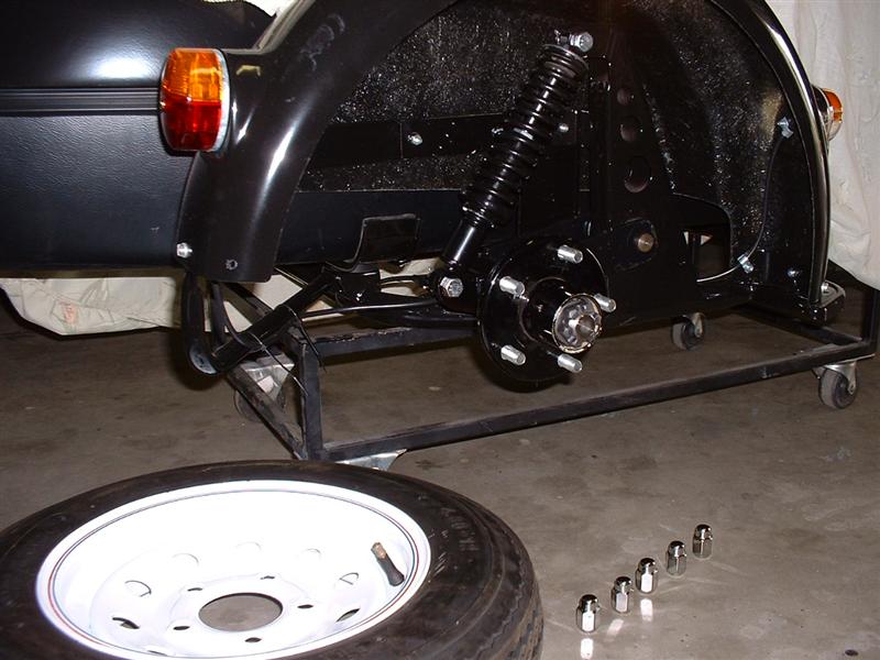

This Bolt on conversion kit allows pre 2005 Velorex sidecars to support larger bikes with 1,100cc's or more, also for heavy loading and dual sport work.
Fits all 15mm axle Velorex's 562, 562E and 700 models. No more bottoming out or wallowing in the turns, great for dual sport work.
Swingarms with the 15mm axles were designed to support a 350# JAWA or MZ. My swingarm will support a bike almost twice that weight.
Uses modular wheel with 4.80x12" or 5.35x12" flat tread tire. Includes Heavy Duty swingarm with 1" axle, standard 4"on 4" hub with Timken bearings.
Straight bolt on modification. No welding or other mods needed. $300. with US shipping.

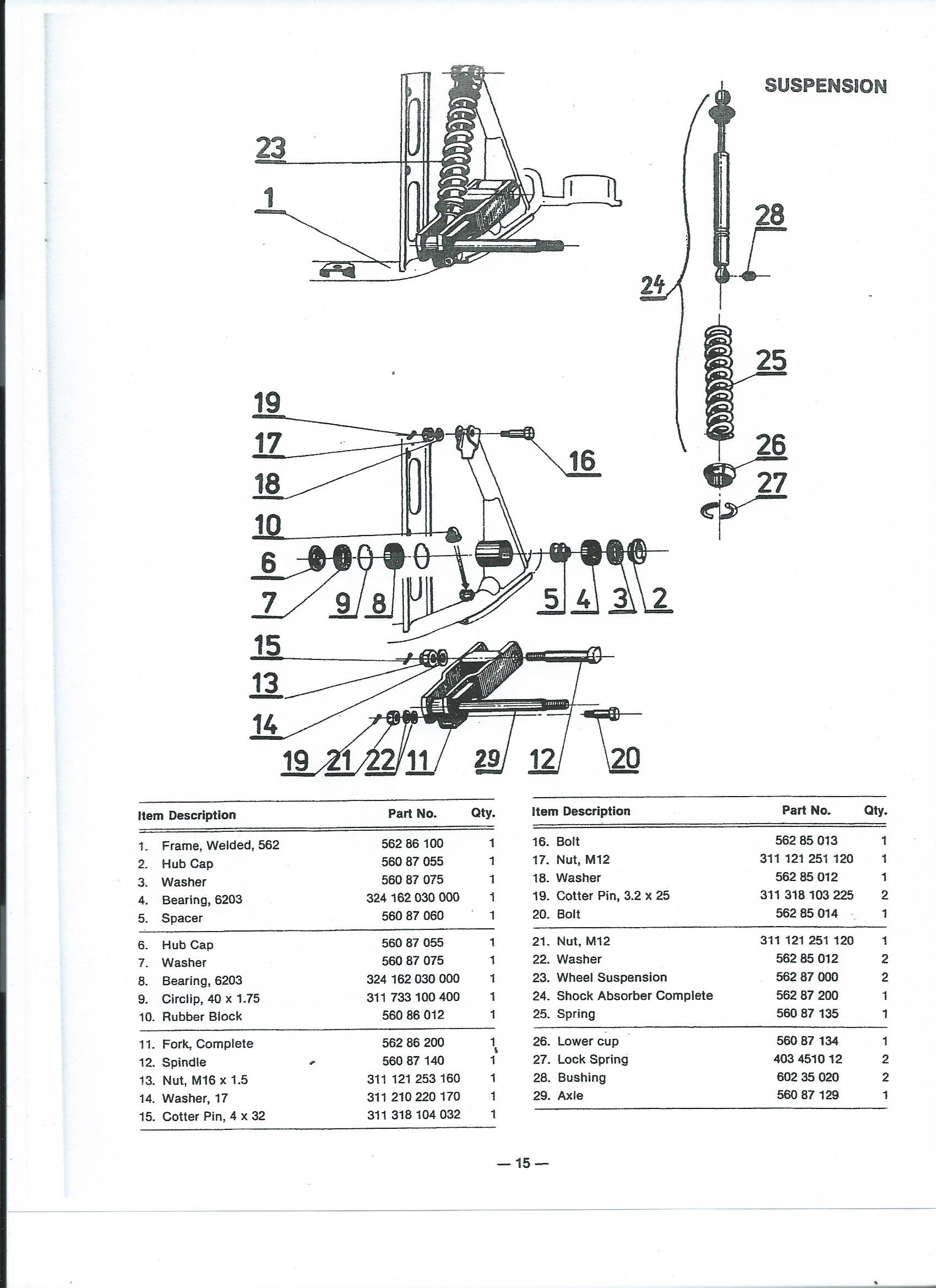

Cycleboy,
If you have the stock spoked wheel and your swingarm looks like #23 on the attached illustration you have the original swingarm with a 15mm axle.

Lonnie, thank you for the quick reply! So, the original lower shock attachment is in front of the axle and the HD conversion it is behind? What other parts are necessary for the conversion? Will the original fender still work? Does the new hub have a 5 bolt pattern? Where are those wheels available?
Posted : February 28, 2015 9:40 am
Our bolt on suspension upgrade uses a heavy duty swingarm with 1" axle. The hub is now 4 lug.
It uses a 12" modular wheel with a 4.80 series flat tread tire.
Chrome, galvanized or powder coated wheels are widely available from trailer supply stores, Lowe's, home Depot, Harbor Freight and others.
Nothing else is needed. The kit is priced at $300.00 including US shipping.
