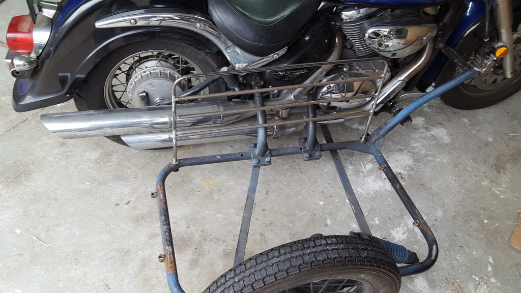

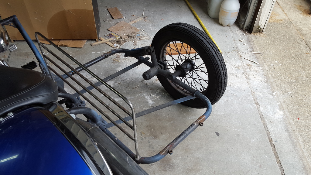

I am re-doing my SoA (although i think it has a calif body, it's fiberglass and no support ribs.)
Anyways i used this, slightly shorter eyes were the right diameter and i wanted black. (shock on my was 12" these are 11", we'll see if or how much it changes lean, it might even make it straighter, have to see when rig back on.) He claims they're for light bikes and not heavy cruisers, so i'd think they're close. My rig will be heavier what with wood floor and all.
http://www.ebay.com/itm/231633089632?_trksid=p2060353.m2749.l2649&ssPageName=STRK%3AMEBIDX%3AIT
Here's the frame with a bracket i added so the beagle/daughter doesn't touch the exhaust.
Posted : November 22, 2015 11:09 am

cortcomp - 11/22/2015 2:09 PM
That is some fine work!
I wish I could weld.
Posted : November 28, 2015 4:59 am
(@cortcomp)
Posts: 16
B5, thanks! My father in law lets me use is 110v mig welder, it's perfect for these projects. Honestly, i bet anyone here could have done that bracket, simple cheap tubing bender, some tube, some all thread, and a welder/grinder with a sandpaper wheel on it. I used to think welding and body work were magic. If you have guidance (and who doesn't with the internet), just go try it! Never to late to learn something new 🙂
Posted : November 29, 2015 4:38 am
