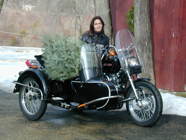

See attached

I think this illustrates just how popular this model was (or maybe how limited choices were) back in the '70s. We've had this question with a similar chair twice in a couple of months. Still, a very cool sidecar with lots of potential. Enjoy and post lots of pics!
