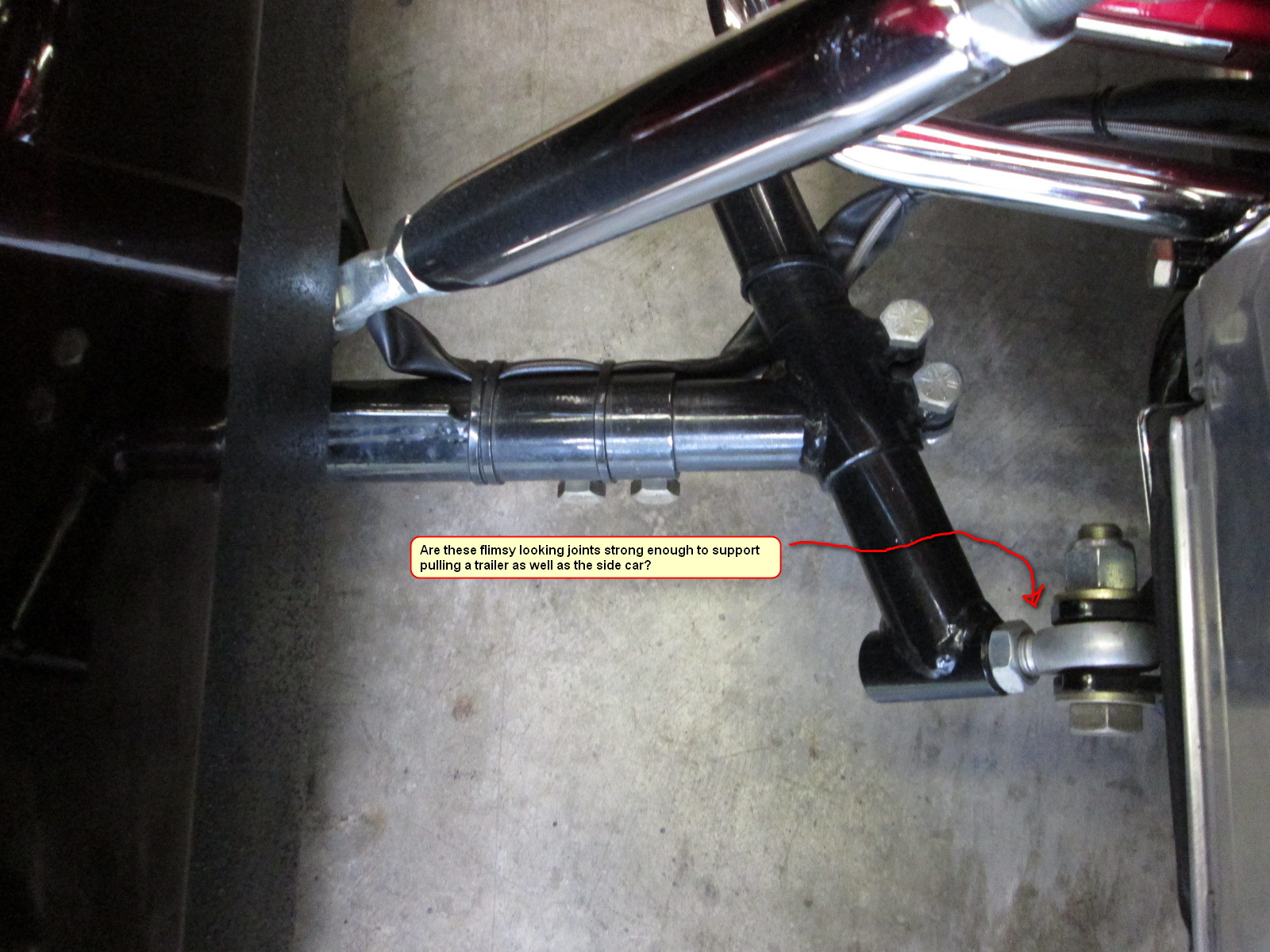

Ok. I am going to try and post a pic. Hope it works.
Before I get to involved with pulling my kwik kamp I have a question. If the pic shows up that should explain it.
The text in the pic is quite small. If you can't read it , it says Is this flimsy joint strong enough to pull a trailer as well as the side car.
My trailer weighs between 500 and 600 lbs. And is the 1500 strong enough to pull this kind of weight riding two up ? I weigh about 160 lbs and my partner is around 140 lbs.
