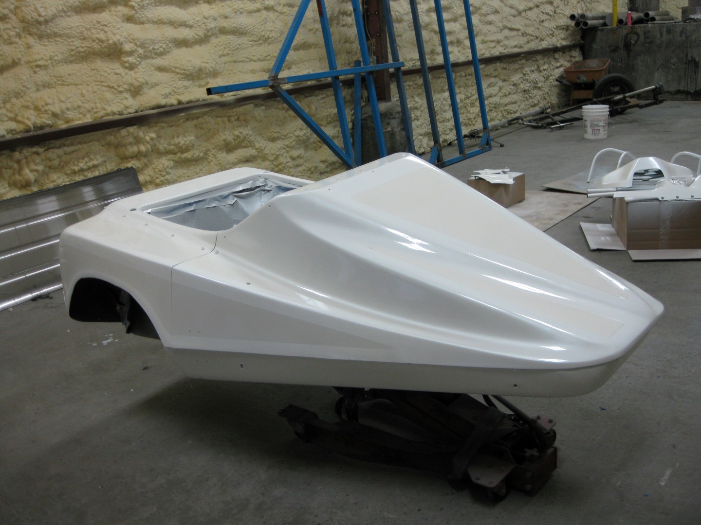

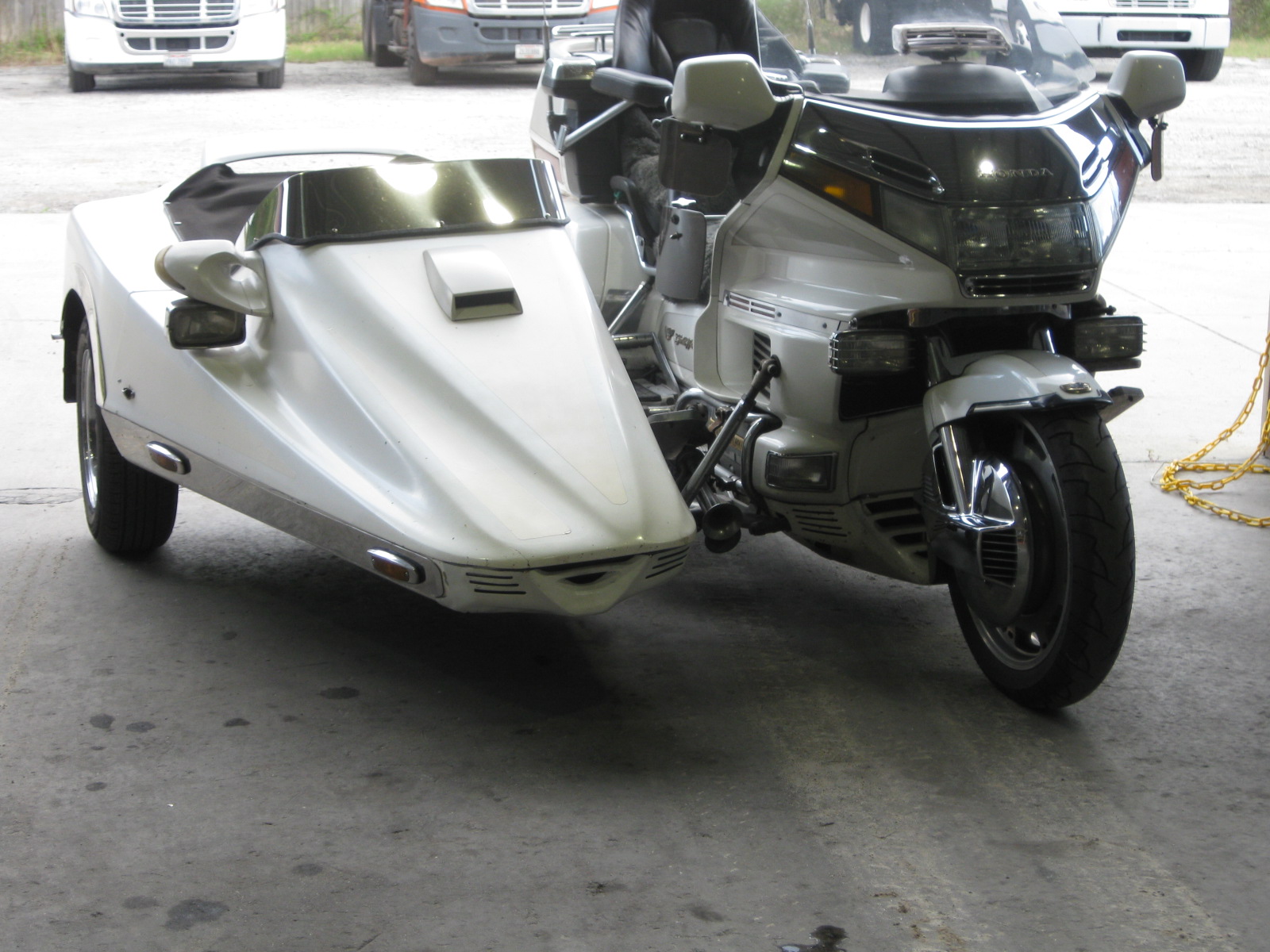

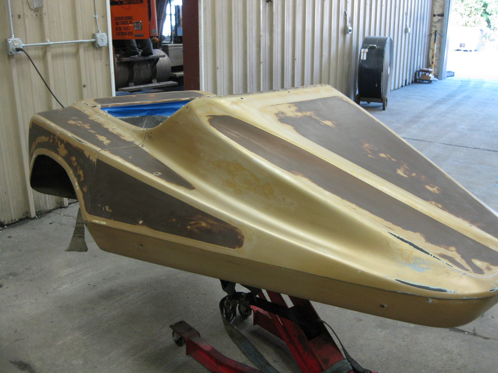

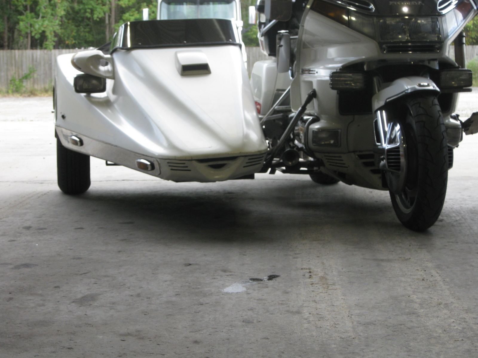

first pic is the way it looked when I bought it, well after I stripped and sanded it
next is after I painted it , then after I mounted it to the bike.
I was only slightly happy with the paint job as my 2 tone section didn't come out right so I knew I was going to repaint it

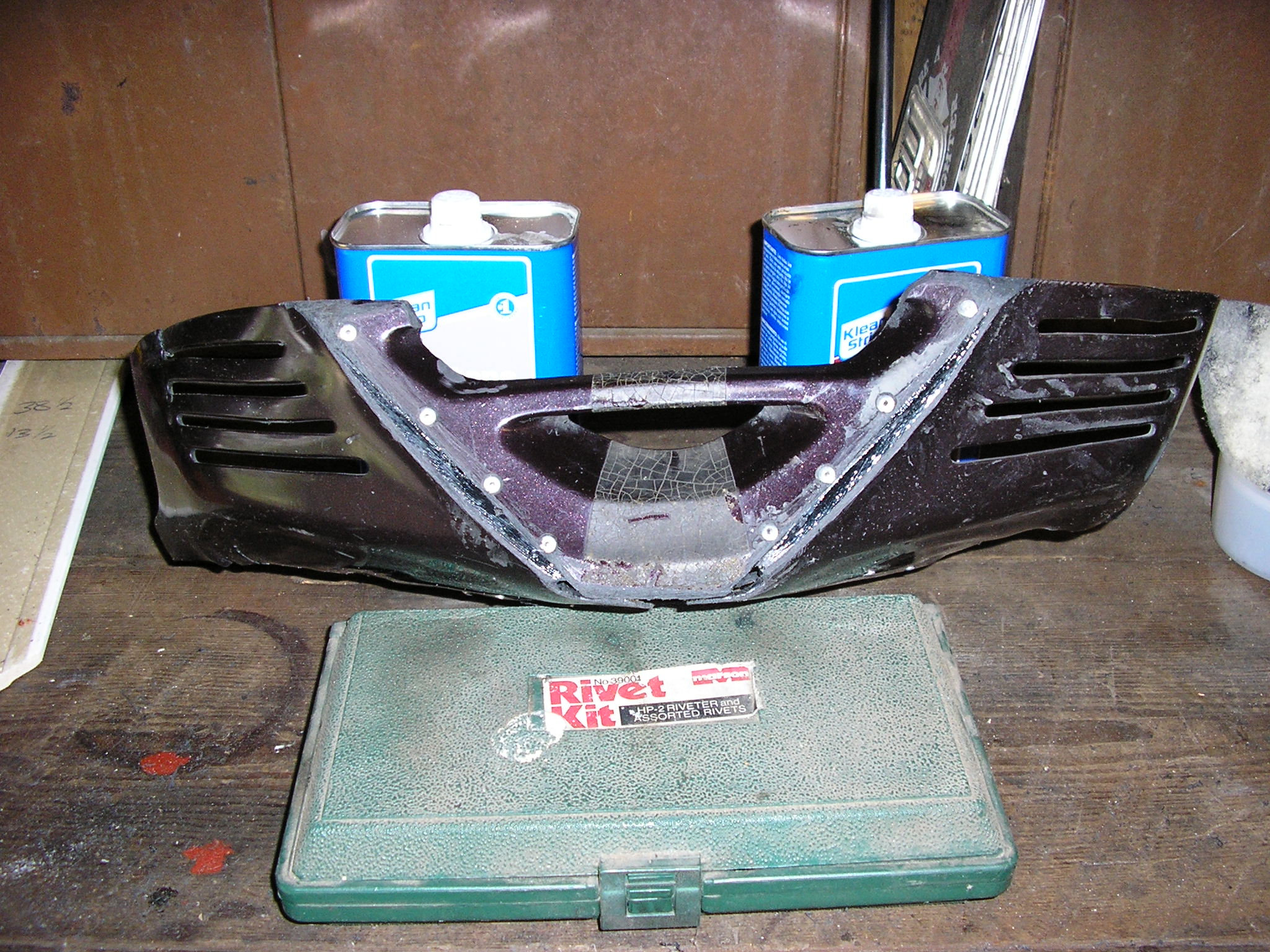

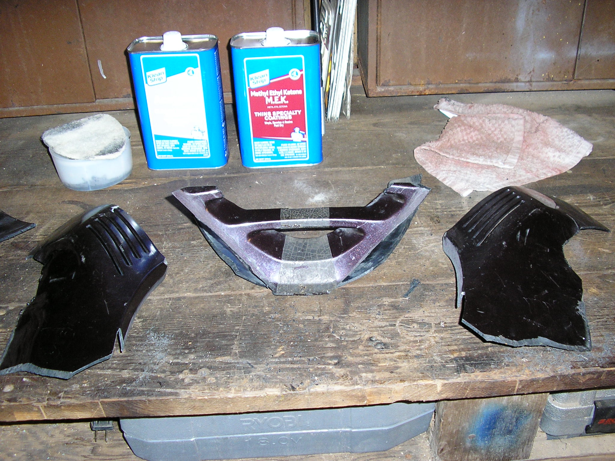

I did a little more work on my project this weekend, I'm working on the nose spoiler. I had to cut it into 3 sections because in it's original size it is too wide and too tall to fit the nose of the sidecar
so after some careful cutting, grinding and forming using a heat gun I managed to get it into shape to fit the car. I am using acetone and MEK to bond the pieces back together then countersinking rivets
here are a couple pics of it, first in when it's in 3 pieces, 2nd is after it's bonded and formed to size. I still have to fill in the seams and do a test fit, I should be able to do the some time today

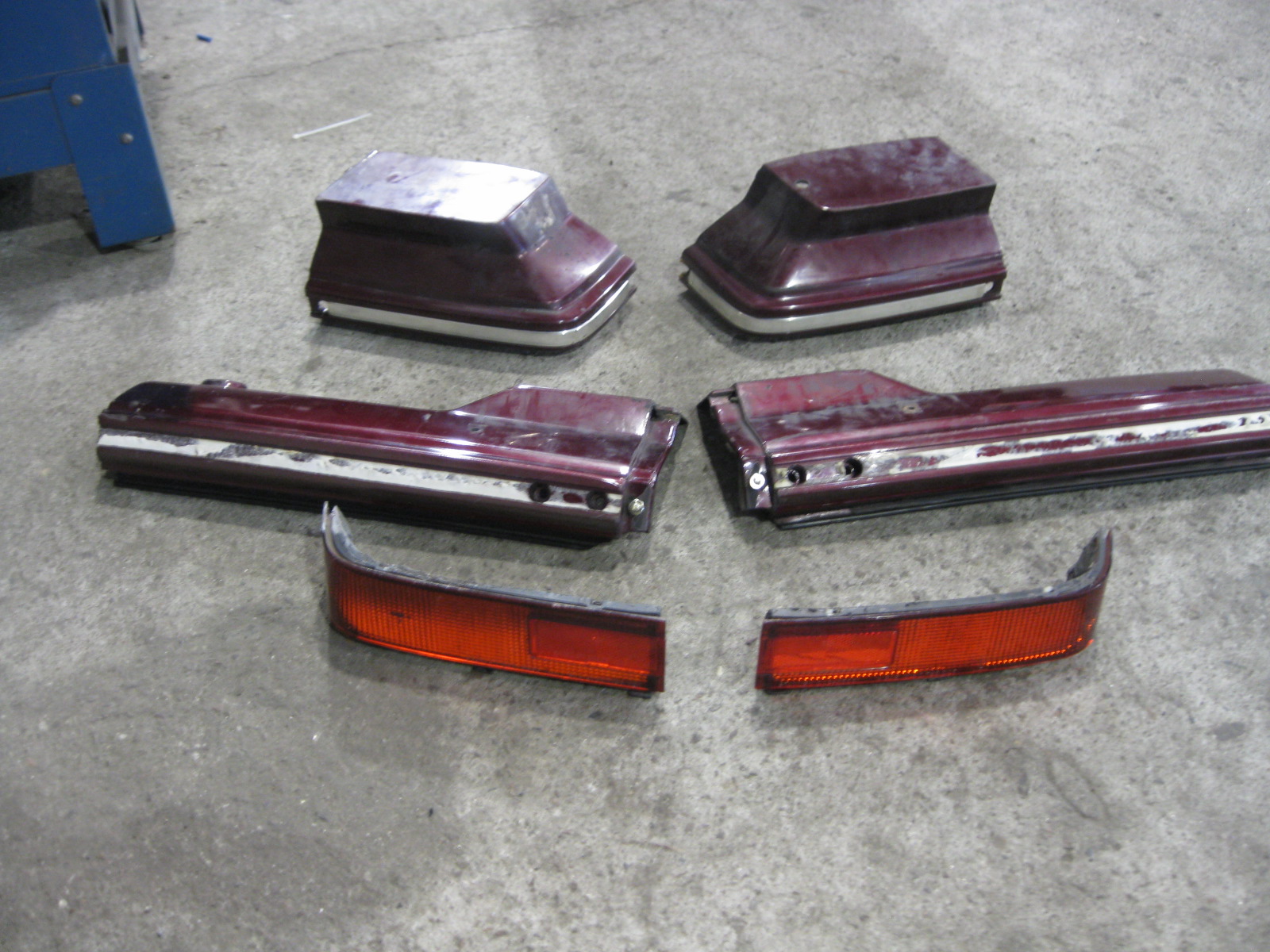

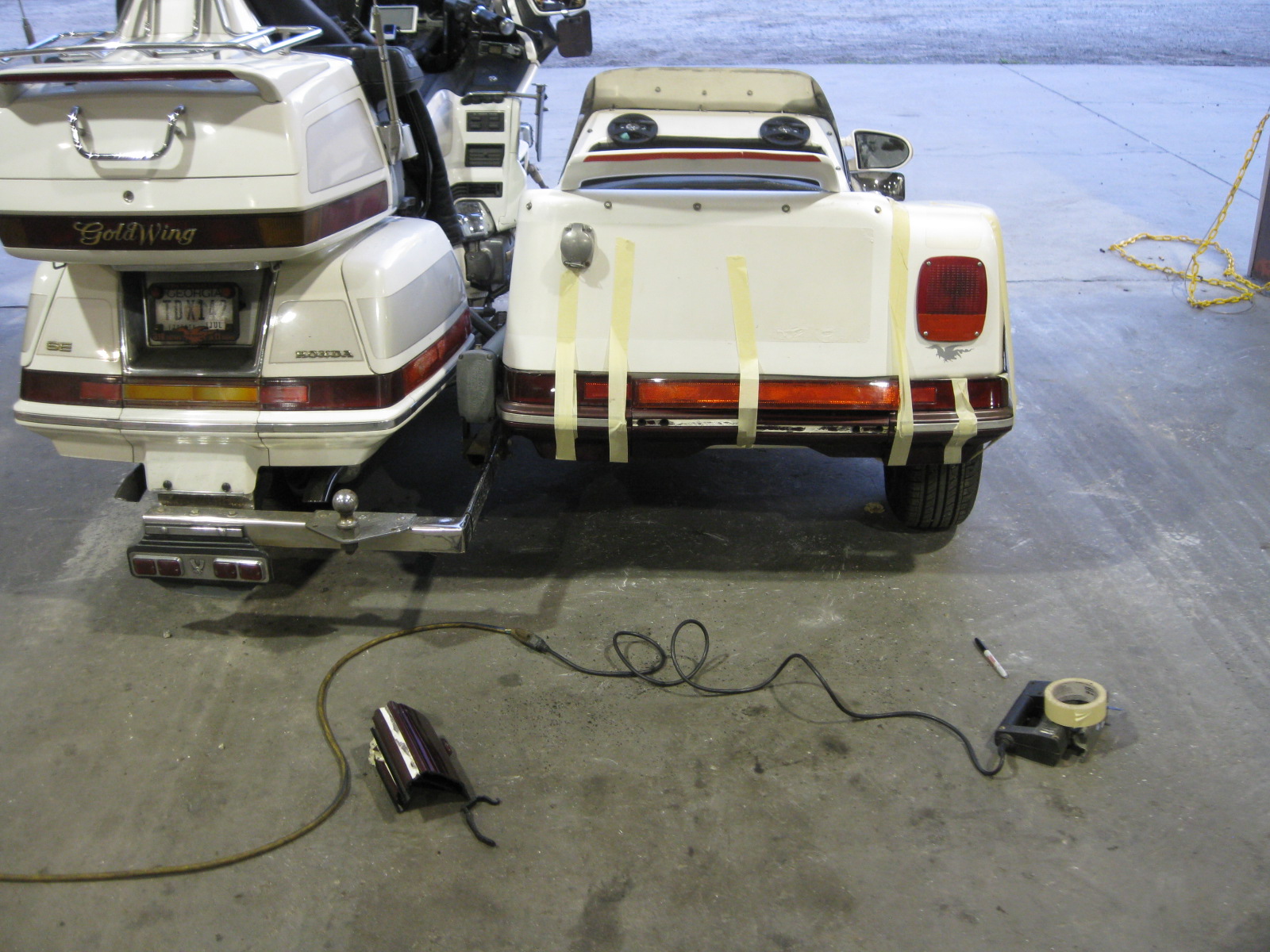

I have been working on the rear of the car a little. I removed the er/ light bar and the mud flap I had made so I could start the sizing/fitting of the new parts
I took a good set of used saddle bags and started cutting them up until I had the parts I needed to start the build with. I also cut and ground the taillights so they would fit against the back of the car properly
the first picture is the car once everything was removed, 2nd is right after I started cutting up the bags, 3rd is the pieces I'm now working with to create the new look
Posted : October 19, 2017 4:37 am
