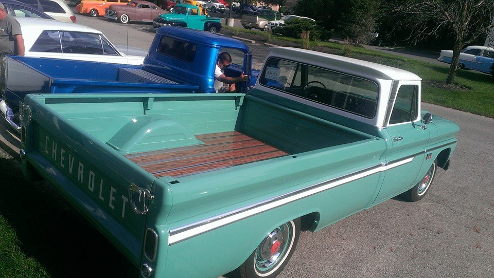

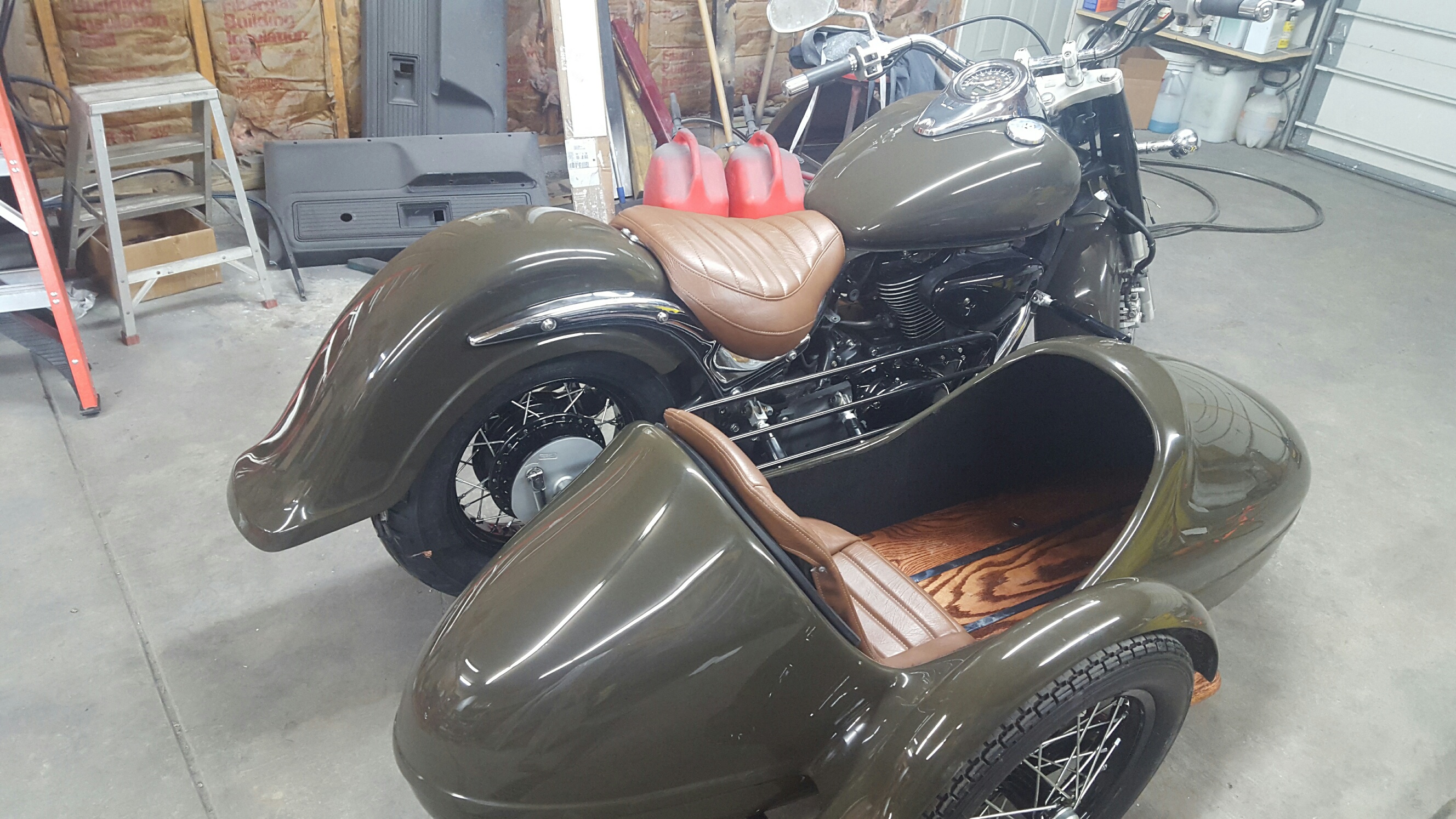

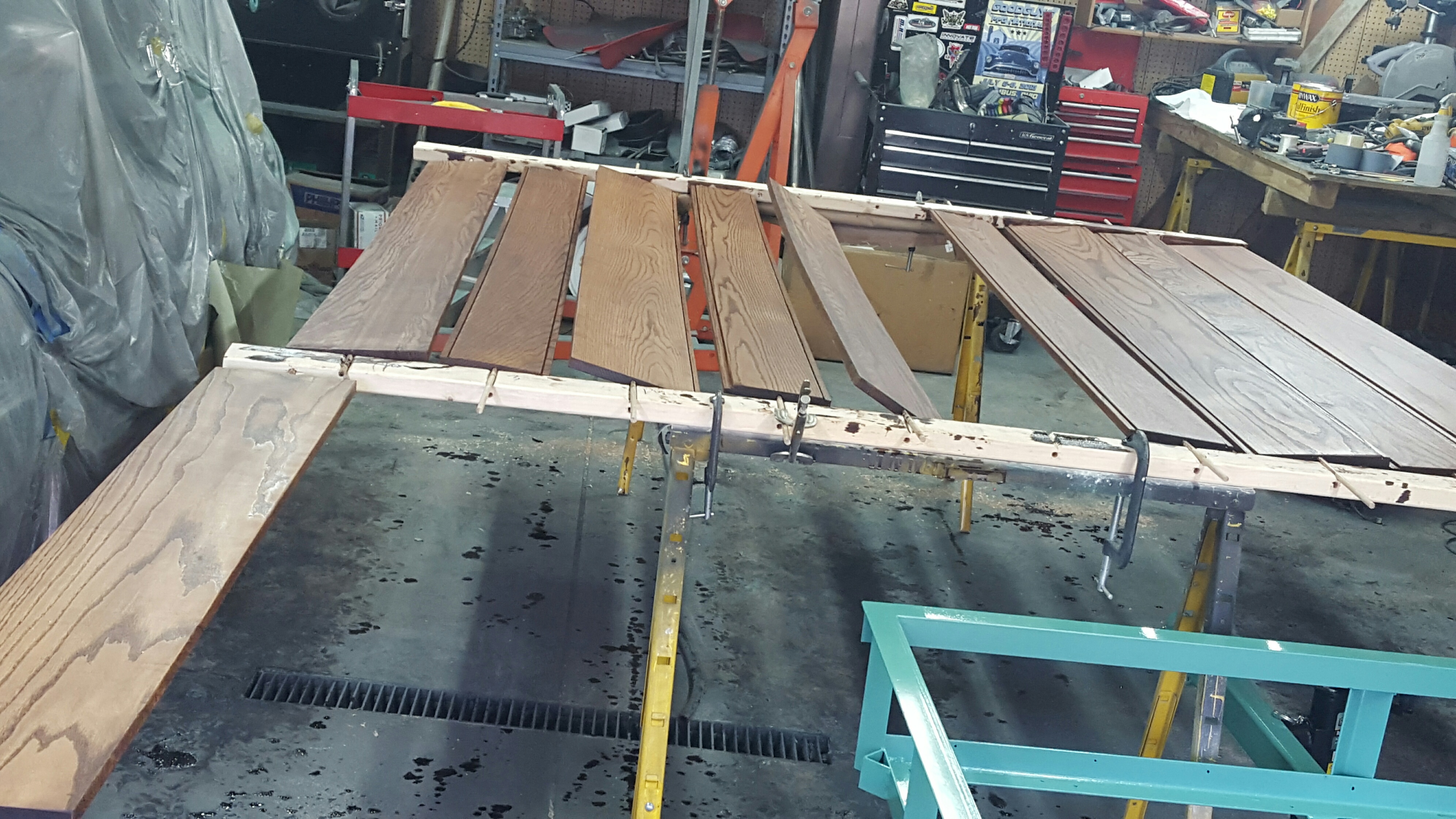

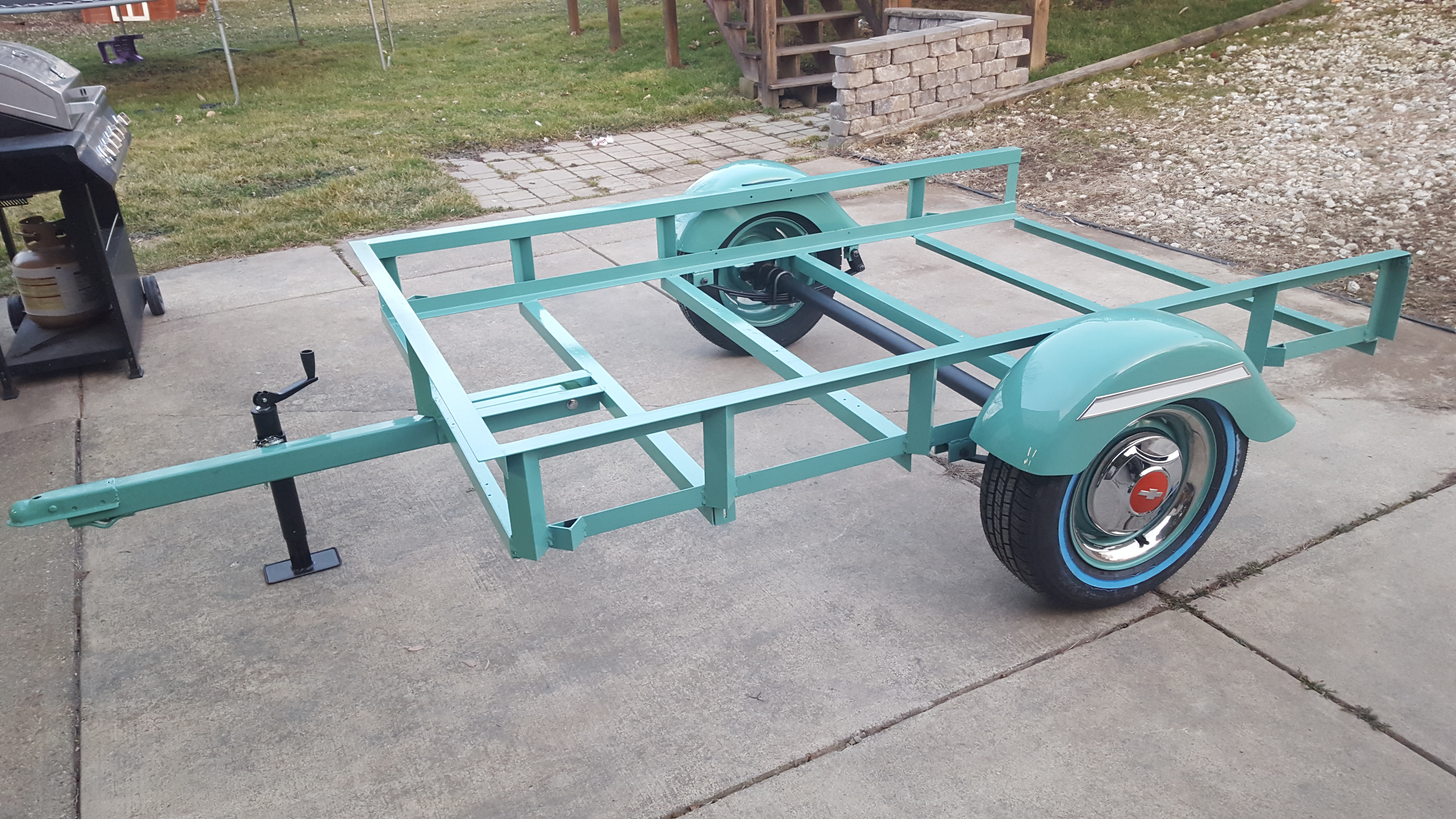

I'm glad others are thinking/doing this, i figured people would be put off or poke fun that i'd be trailering some and not always riding.
I'm building a trailer for mine to match my 66 c10/wood in the sidecar floor/wood in the truck bed now. Little 5x8 tilt model. but again, mine was custom mounted when i got it, it's very close to the bike, i did little but strengthen the mounts and add a leaf spring for stiffness:

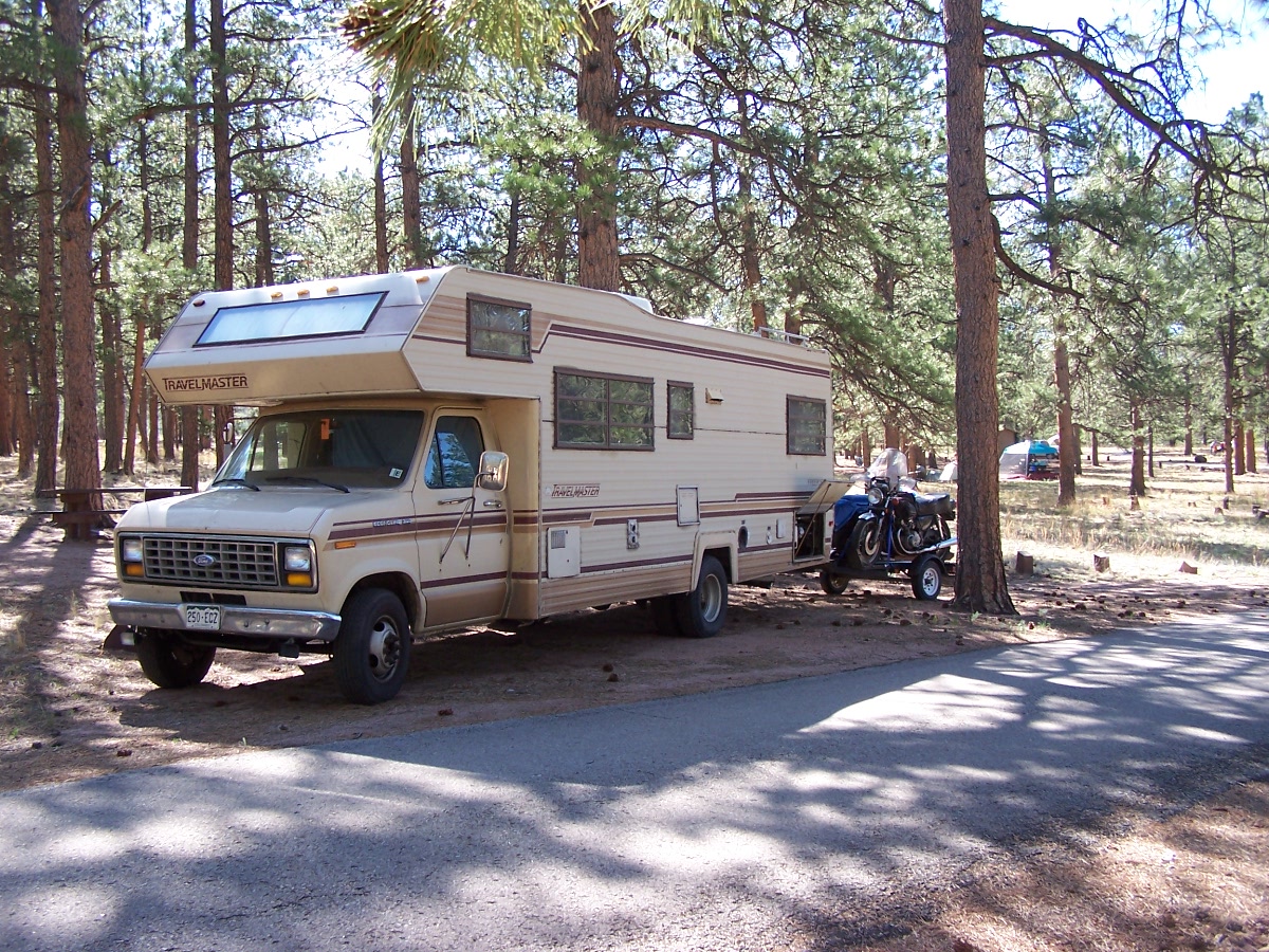

Posts: 449
I like to take the Ural and the Rokon for week long camping trips and such so I have an open trailer I use with a bike rail on the tongue for the Rokon. I have had the K100/EML rig on it also to get it home from Denver when I first bought it and the K100/EML is actually 4" narrower than the Ural. Haven't tried the GS rig but I am pretty sure it is too wide for the trailer.

Man that is some gorgeous country!

That's just my yard, come out for the sidecar national this year and see how good it really gets around here.
