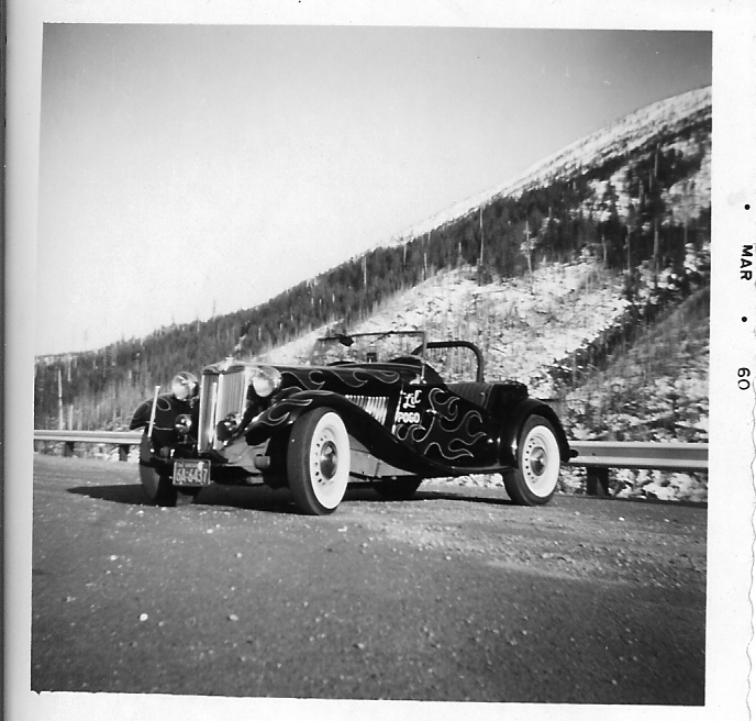

After a couple years of daily driving and racing "LiL' POGO" the 1950 TD/Stude, the '51 259cc motor was getting a bit tired after 136,000 miles (it still had original pan gasket, those old Kettering engines were bulletproof).

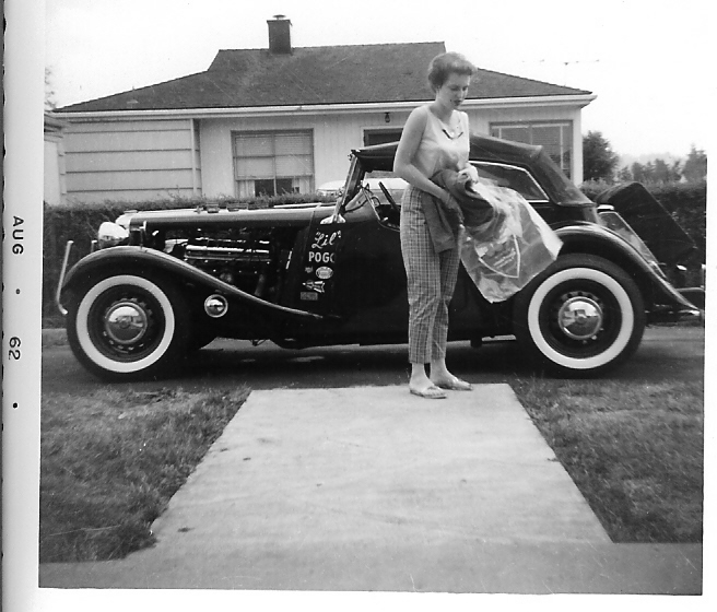

So, time for a change. In went a '52 Olds engine (another Kettering) donated by my recent bride from her 98 convertible which had shed a Hydro and was languishing in our back yard.
By moving the firewall back 18" and relocating the steering and seating I gained cubic inches and shaved 180 pounds from the Studebaker setup with this motor combo. Flowed heads, bore, cam, headers and 4 carb Wayne road racing manifold followed. No more auto crossing for this rig.
