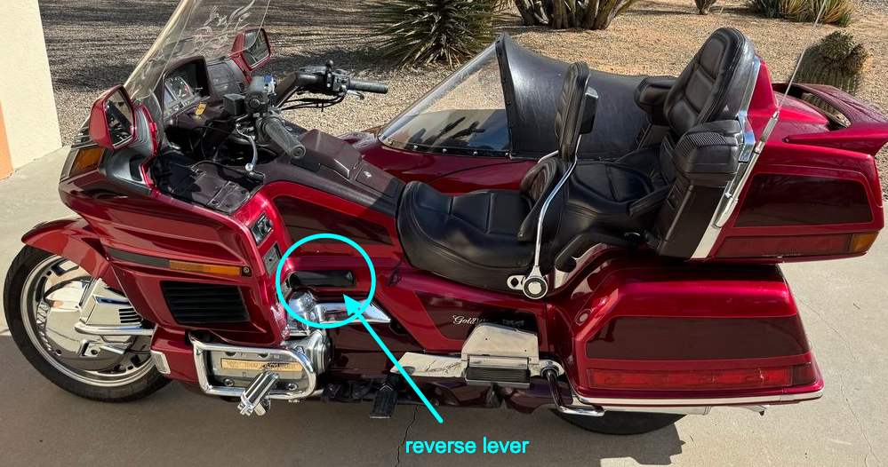

Steve, I was just reminded about something, go check and let us know if the reverse lever is pulled up
Posted : January 25, 2024 5:58 am
Posts: 620
Do not drag the bike with your lawn mower!  Sheesh!
Check to see if you accidently put it in reverse.  The reverse handle should be pointing forward, not up.

All the wheels are free. Started the wing and got it to move VERY slowly. Now that could be mud or maybe a combination of things. When moving it took a lot of revs to do it whereas before the bike would almost lift as though the brakes were stuck. So maybe i need to tow it onto firmer ground if i can. Front and center lower link on the sidecar to tow? Reverse is down and light out.
