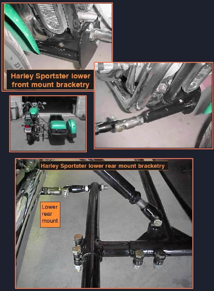

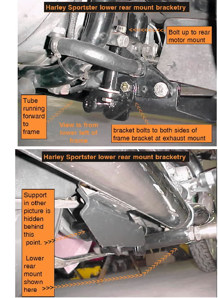

Attached picture is of a portion of a subframe we did for a late model sportster.Dunno if they wil make sense or not.
Posted : April 15, 2008 2:21 pm
Hello Claude,
I am not into Harleys at all as you know.
I didn't know that they are now pretty stuffed and don't let you much space to work with.
The rear motor mount looks pretty good, but on the front and back mount you have a lot of lever that might need reinforcement corners and the long angle legs I would avoid and eventually continue straight to the main frame with a fist as lever rest.
Just a thought for the next occasion.
I'd love to have to assemble as much rigs as you do. That would be a nice pensioneers job, but still a long way to get there.
Best regards
Sven Peter
Posted : April 15, 2008 2:54 pm
Sven wrote:
>>The rear motor mount looks pretty good, but on the front and back mount you have a lot of lever that might need reinforcement corners and the long angle legs I would avoid and eventually continue straight to the main frame with a fist as lever rest. <<
I was hesitant to post those pics as they do not show all of what is there.Wish I had taken more but it was kinda complex underneath. From what you can see of the mounts I would have said about the same thing.
I wwas told by a long time Harley employee and long time sidecarist that the swingarm support area on these newer sprotster frame was amn investment casting that had little additional strength to deal with much. This was why things got a little invloved when we mounted this sidecar.
I will see if I can find more pictures. The ones I wanted to post were from an '07 Sportster and were more complex than the ones here.
