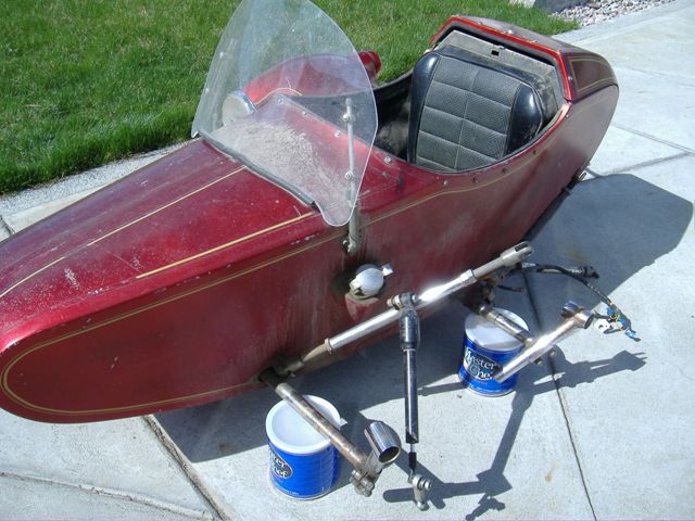

If the frame seems to be inside of the body the lower mounts slip into tubes at the bottom of the body and the upper struts are going through the body itself, it sounds like you have a Motorvation Spyder sidecar. Got pix?
Posted : September 10, 2007 7:29 am
Hackin' yer right, it's a Motorvation Spyder, Doc.

Definetly its not a Motorvation. The pics are not very good. I had to magnify and probably lost some quality. Don't know how to post a pic though
Posted : September 11, 2007 2:44 pm
Hey jwebfournow, the pics are of a Motorvation Spyder, believe me I have one, buy it, Doc.
Posted : September 12, 2007 1:29 am
The pics that Hack'n posted are of a Motorvation, I'm saying the pics that the guy sent me are not the same ones Hack'n posted. The guy that I'm talking about has them posted on Craigslist San Francisco. I would post them here but I don't know how.
Posted : September 12, 2007 6:23 am
Is this the one?
http://sfbay.craigslist.org/eby/mcy/419265815.html
Posted : September 12, 2007 7:26 am
This is an early model Velorex 562E (Euro) model.
The frame looks intact, however the mounts are not all there. The mounts are available for this car.
Without accessories and an interior I'd guess it's about $1,000.00 rough if the body is undamaged.
Posted : September 12, 2007 8:18 am
Yes Joyce that would be the one. So I guess $500 is not to bad of a price. Why is it that all the good sidecars are in the midwest or east coast. Don't see to many on the west coast for sale.
