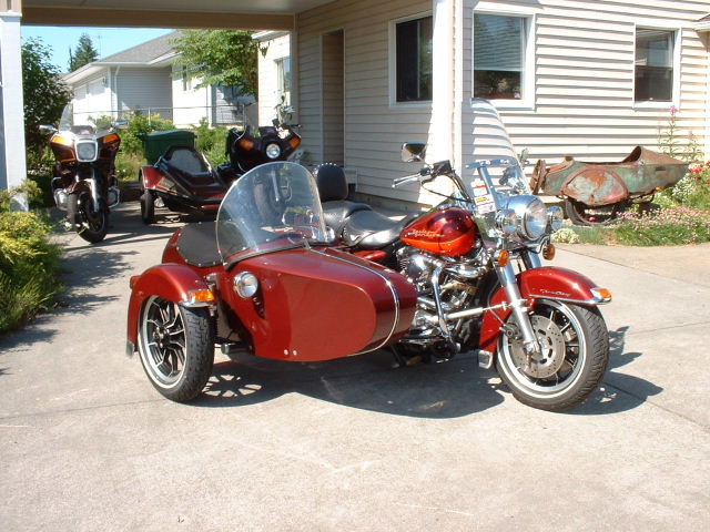

Do you have reduced trail? My RK/TLE rig with 5% Liberty trees made it easy to overcome road crown without a trim device. Running PCH and the Sierras was a cinch.
The '98 with a Stage II 80" Evo and FI delivered 42mpg on the highway if I stayed at 65 or so. At 70 to 75 it dropped down to around 32 mpg with the extra wind resistance and rpm.
In the hills 65 was about tops in 5th gear. In order to run 70 or more it took a shift down to 4th.
Great outfit but I thought it needed a bit more horsepressure at times.
Now my Turbo RK/Spyder rig was another story.
Posted : June 17, 2007 6:08 am

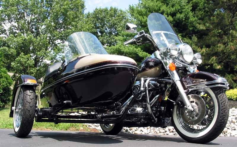

After a few months evaluating my '97 Valkerie/Motorvation Spyder rig, I've made the final conclusions.
The Valk has more than enough power. I've had it to 95mph and it was still accelerating.
The Valk has more than enough appetite for fuel. It doesn't surprise me. If I run over 3,000rpm in 5th (68mph indicated) the fuel runs through at about 26/ 28mpg. Under 68, about 30-32, good for a Valk but would be dismal for most bikes with more streamlining and/or less cylinders.
I wish that I had easy lean adjust. Right now adjustment is a compromise and works well on interstates but not so good on heavily crowned roads or crosswinds.
Overall, the Steerite reduced trail triple tree was the best investment in the rig. Easier steering and NO wobble or instability.
Did I mention on back roads I get up to 37mpg? I find that the reduced speed I'm running now, is a joy, both in seeing things that I missed before and easy on the wallet.
Wayne
Posted : June 17, 2007 7:41 am
