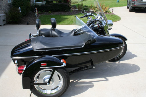

What SC wheel lead is Harley using now? I assume they increased it as the vintage rigs did have a reputation for nosedives. Going on second hand info as I haven't driven one myself. The ones I have seen were pretty rigs....
If by "lead" you mean the relationship of the rear wheel to the sidecar wheel, the HD TLE sidecar is probably the farthest back you can get, e.g., very little lead. Here's a typical picture of one (not mine) where you can see that the wheel has very little lead over the rear wheel of the bike.
With the sidecar mounted and some weight on the frame, these rigs are definitely "heavy metal" and it would take quite an effort to do a nose dive on one. They are really quite stable.
Posted : June 13, 2007 3:03 pm
Thanks. I really should try one out someday.
Does the nose dip in lefts? It looks like the front of the sidecar is quite high, perhaps to compensate?
I can well believe the rigs are stable, between the weight , the width and HDs almost legendary low center of gravity.
From what I have heard passengers say, it seems you either love or you hate the sidecar body's sprung suspension. Some folks say it makes them motion sick, I have heard others assert it is the most comfortable ride you can find.
Variety and choices are a good thing, 'specially for a gear head 😉
Posted : June 13, 2007 3:18 pm

Originally written by RedMenace on 6/13/2007 6:18 PM
I really couldn't tell what happens in extreme situations on turns since I don't make extreme moves on the sidecar. Every time I get too fancy my wife punches me in the right kidney. The machine doesn't seem to dip much either way, although I admit to slow, almost "regal" turns.

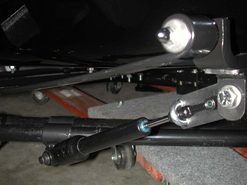

The sidecar will remain stable for the most part. I went one step farther and added a damper on the frame that holds the tub very flat even over bumps. Here's a picture. This is a VW steering damper (same part as the stock HD steering damper only $100 less expensive) but you could also use a 50-50 shock if you can find one anymore.
