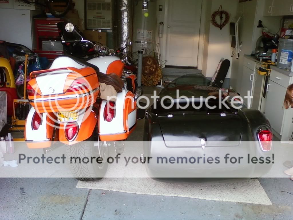

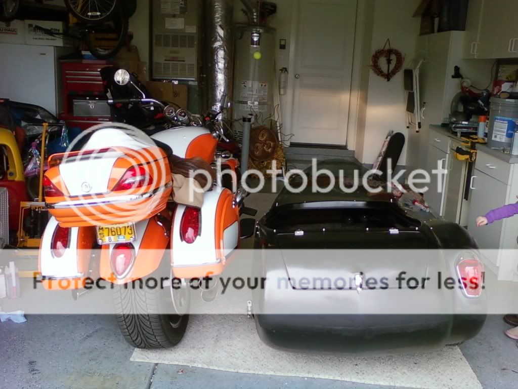

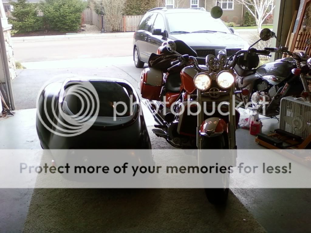

Well, the cross-country shipper finally dropped off my new sidecar today, all the way from Hannigan in Kentucky. Ironically, they also dropped of my tug at the same time, which has been gone for the past month in Indianapolis, Indiana getting a supercharger installed and on display with the supercharger company (TTS Performance from England) at the 2009 Indy Dealer Expo.
Nevertheless, both are home now. I attached some quick pics I took with my phone. They are not great, but you get the idea, and a sense of the size. The sidecar is MUCH bigger than I anticipated. Should be fun 🙂 Side-by-side, the tug and hack are about 7-feet WIDE. Can you believe that? For the sake of reference, that is the same width as my Nissan Quest Minivan. Perhaps this is not surprising to you, but to me, a green, novice, and ignorant sidecarist, it was a bit of a shock.

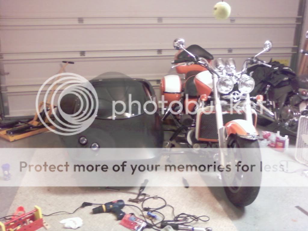

Thanks guys for the comments! I got the hack mostly installed today. Spent about 12 hours working on the darn thing.
Here are some pics and commentary.
Lots of little problems. Maybe some medium problems, nothing catastrophic though. I actually took it out for about 15 miles. Gave my wife a ride, then gave the kids rides around the block. That was my first time driving a sidecar. Not really sure what to say. It's not easy to drive. Going straight at a constant speed is fine. Everything else is a lot of work. Clutching from a stop takes some finesse. Braking makes the rig go left. Acceleration yanks you to the right. I was warned about both of these, but its very pronounced and takes some work to compensate. The sidecar brake should help a lot once it is hooked up, at least with the yanking left issue.
Turning takes mega effort. This is a big bike, and a big sidecar, and then throw in a person plus me as the driver and we're a 1600+ mass of inertia that lacks symmetry and has no power assist for turning. But I'm not sure if it is supposed to be this difficult! I have to pull REALLY HARD. After the minimal 15 miles total, my shoulders are quite literally sore. I'm not exactly a wuss, and I'm not a bean pole either. But those handlebars took some serious wrangling.
I really hope that I get used to that, because it makes it no so much fun. For about $1000.00 I can get the EZ steering kit, but it is permanent and the motorcycle cannot be driven on two wheels with the mod. So I'm not going to do that.
Ok, enough rambling. Here are the pics.

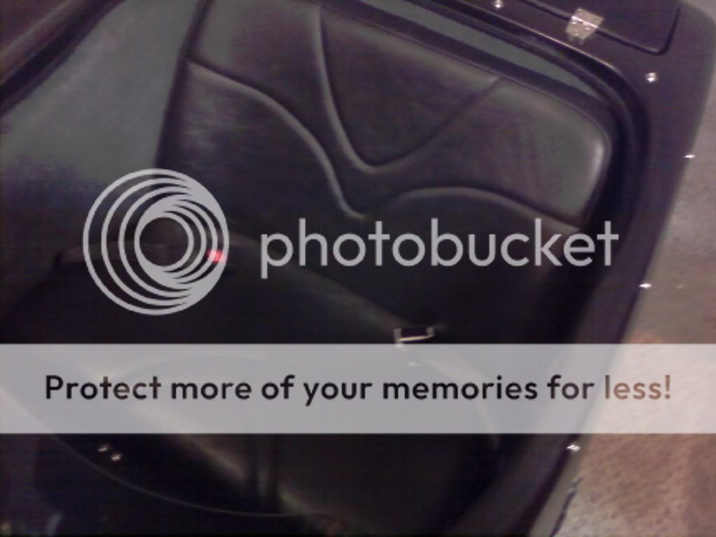

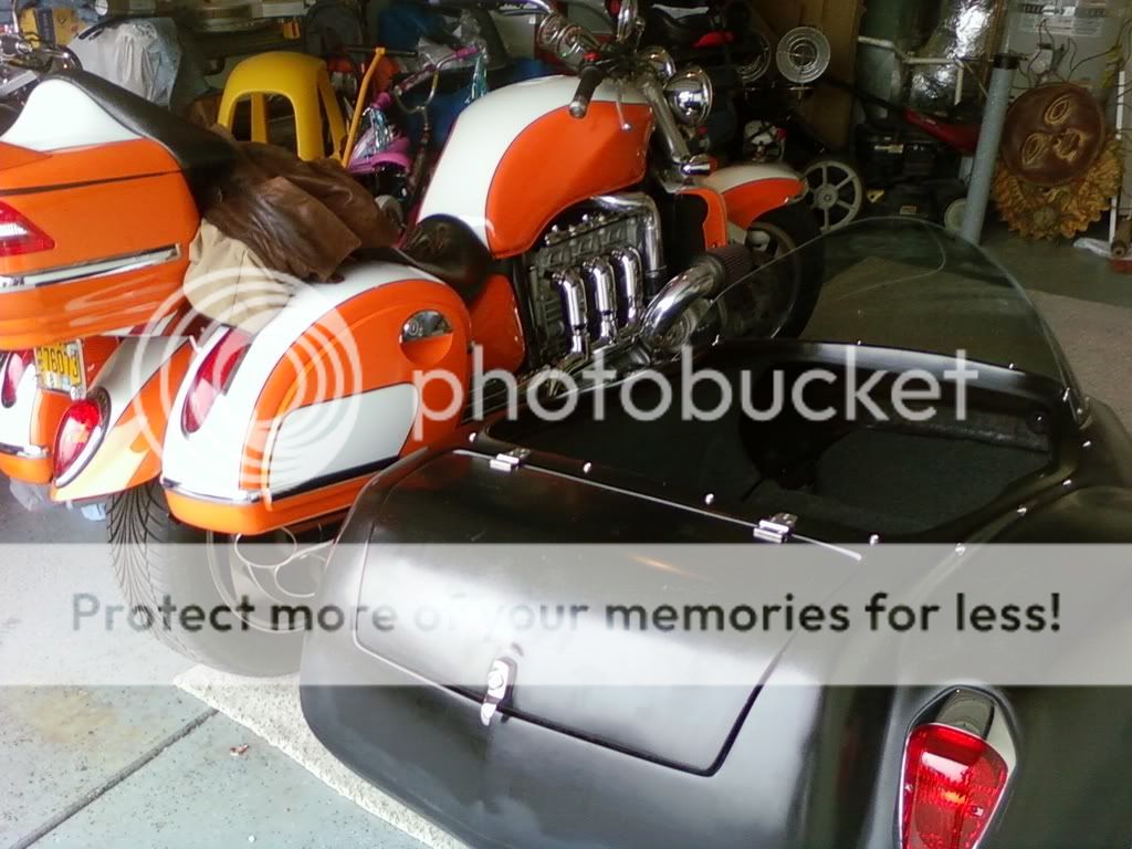

Here's the seat. Easy two seater, perhaps three small kiddies.

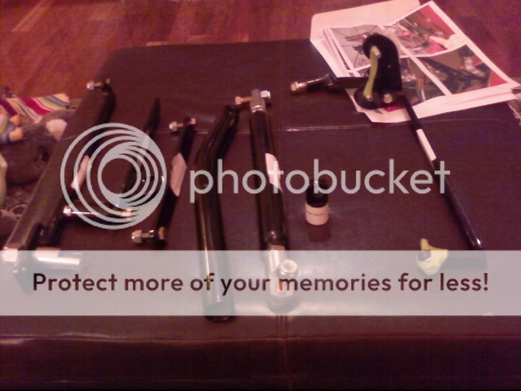

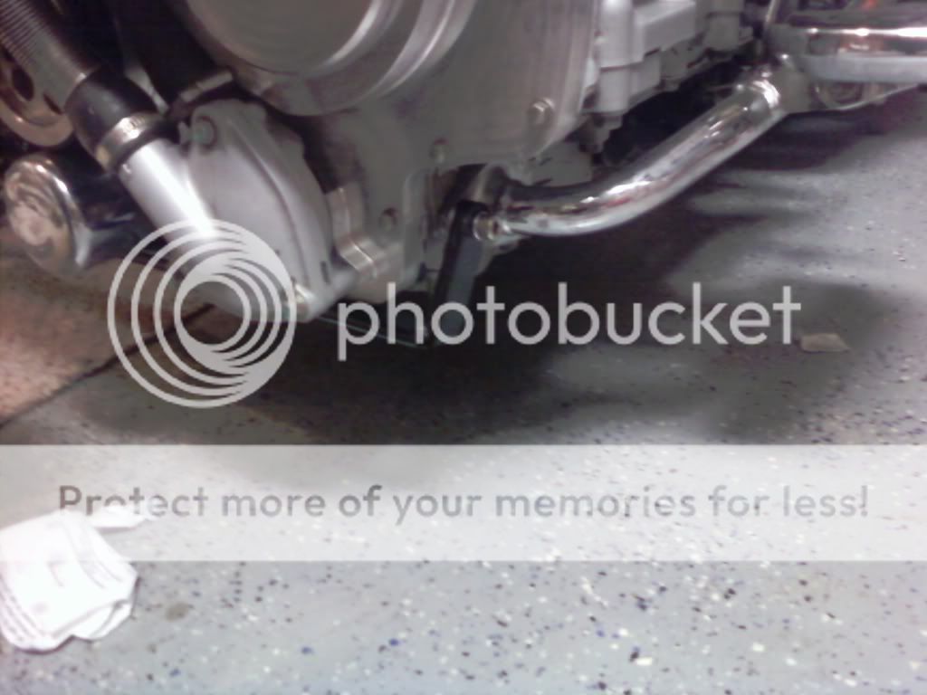

Here are the bike mount points and struts that go b/t the mount points on the bike and the mount points on the sidecar. The instructions are in the upper RH corner. Just pictures. NO WORDS whatsoever. That made it interesting. I had to drill some holes and take some stuff apart, but figuring that out was a process of elimination, swearing, and asking myself, this part must go somewhere ... if I was designing the mount, what would I have done. Ugh ... just a few words could have saved TONS of time.

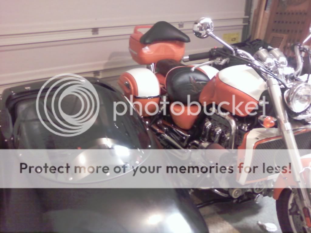

Ok, here's a front view of the car actually installed. And yes, I did use the hammer (more than once) and yes, I did use the drill ... many times. The "sippie" cup is not mine.

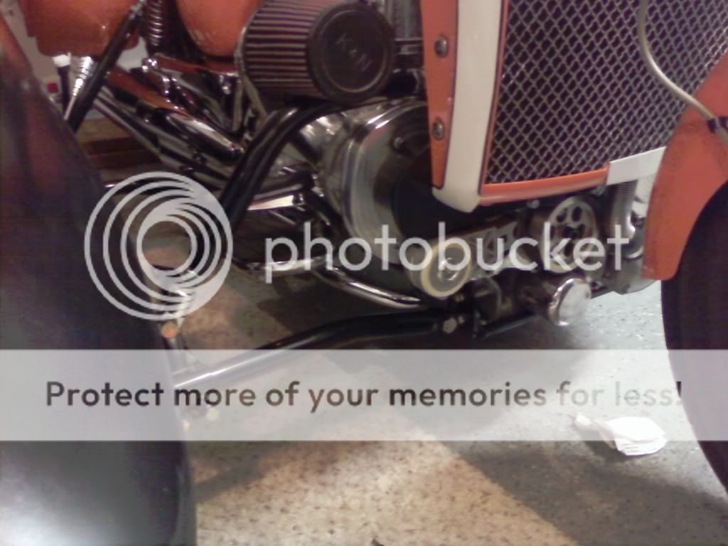

Here are the front struts. They BARELY fit around the supercharger, and I had to get creative with the installation of the lower mount point. You cannot see it in this pic, but there is a vertical reinforcing brace coming off of the lower mount. It shoots up right behind the turbine into an empty bolt hole on the engine block. The turbine was about 1/2" above the bolt hole and I had a 5 inch bolt that I had to put down through the hole to mount the reinforcing brace. Hmmmm ... no way I was taking off the turbine. So I got a threaded shaft, with no head, screwed it into the reinforcing brace, poked the other end UP through the bolt hole, then used a neoprene nut, a locknut, locktite, a small wrench for the tight space, and LOTS of patience, and I got the sucker mounted! Ugh.
So this lower front reinforcing lateral brace is taking up the mount point holes for my bellypan/chin spoiler. I'm sitting here installing this brace and just thinking to myself ... that belly pan is NEVER going to fit again. Crap.

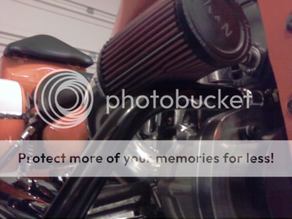

The air-filter does not fit. I had to squish it. It looks fine from a standing position, but I may see if I can source a narrower cone.
The RH Passeng
