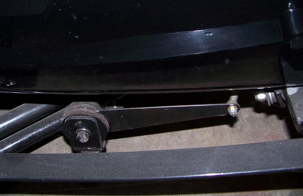

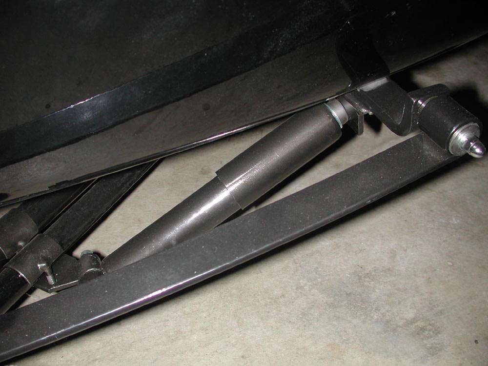

I forgot that another person on this forum gave me some pictures of work he did to reduce bounce on his HD sidecar. Attached are pictures of a friction damper and a shock absorber setup.

Well, that's interesting. Any details available?

There is a thread "Harley sidecar tub bouncing" or something like that which has a few more details. If you search for "bounce" or "bouncing" you should find a couple of discussions about this topic. The person who designed and built those dampers is gnm109. I'm not sure if he is still active here. The damper pictures are over 5 years old, not sure exactly when he made them.

Thanks for the info, the shock set up looks interesting.
