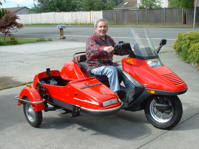

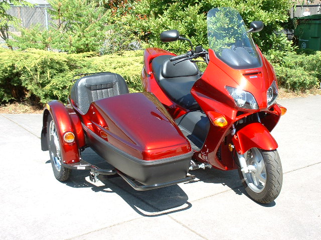

Here are other example, but of a 250 CC Honda scooters.
Both affected by rain grooves though I think the tires are larger and wider than the Vespa.
Weight about the same as the Vespa 250. Great powerwise for in town and secondary road travel where freeway speeds are not needed. Sidecar drops mileage range around 25% due to weight, wind resistance and expanded frontal area. Also drops maximum speeds attainable for the same reasons.
Sudden side blasts of wind (50+) can push the rig into another lane at speed due to large exposed profile and light weight. The smaller tire footprints offer less lateral traction which may help add to this phenomenon.
