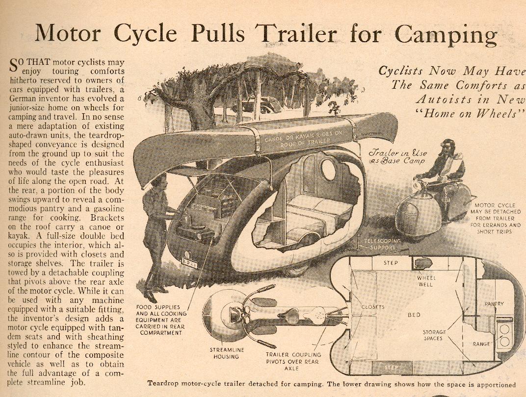

Here's someone's concept from 1936. No sidecar, interesting concept...
Also no mirrors. No traffic in those days?

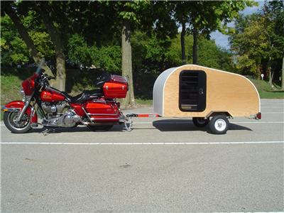

Joe, I built a camper from the plans you are looking at on ebay. The only modification I made was to make it 48 inches instead 40 inches at the highest point. I made it to tow behind my Ural and it pulled it well. Unfortunately, my Ural experienced a firey end is no longer with us. I just had a Texas Sidecar installed on my Bandit 1200S along with a trailer hitch so I will have something to tow it with. It will tow much better with the Bandit. Pictures of the build are posted under Grove tear drop camper on the Wagner web site. Try the following link: http://autos.ph.groups.yahoo.com/group/wagnerscycle/photos/browse/d6a1
It was an easy build or I would never have tried it as my wood working skills are very poor to say the least. I figure I had about $750 in it by the time I was done. It is basically a one person unit if you are large. I'm six foot two and weigh about 230. It would work well for two smaller people. Realize it is just one step up from tent camping. You are of the ground, dry, and don't have to put up and take down a tent. You also have plenty of room to haul your gear. Now that I have my Bandit set up for it, I will use it this coming weekend for going to the Vintage Motorcycle Days at the Barber Motorsports complex and Museum in Birgingham.

I used the HF trailer #42708-IVGA which is listed at $239. I happened to get it when it was on sale for $130.

JOE ,I WOULD SURE LIKE TO SEE SOME PICTURES OF YOUR CAMPER, AND THE FLOOR SUB STRUCTURE. THE TRAILOR IS 40" X 48" , HOW DID YOU GET THE FLOOR TO BE LONGER THAN 48" ? THANK'S, JOE
Posted : October 13, 2008 9:22 am
Pat and Joe, I don't think I did a longer report, just the pictures I posted on Wagner's site. The floor is 3/4 inch plywood and sticks beyond the frame in the front and back. The floor, front, and back, are all made from the same sheet of plywood. If you are thinking of making one, the plans are worth the $25, if for no other reason, he includes contact points for all the suppliers.

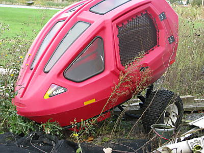

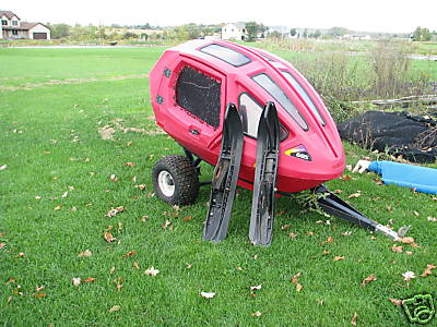

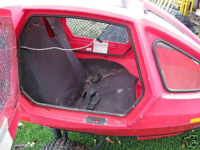

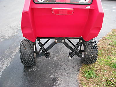

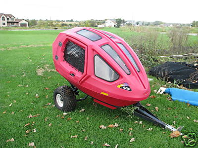

Although I was familiar with teardrop trailers, I hadn't see these ATV pull-behind trailers before. I found this one on Ebay while searching for motorcycle trailers. It looked interesting and certainly unique. Too high a price for my pocketbook to handle for a new one, but not so terrible for a used one. No ski areas per sey in my part of the country, but this could be easily converted for holding additional gear and going camping.
Anyone have any experience with such. I was thinking that the smaller tires could also be swapped out on this trailer, but who knows?
