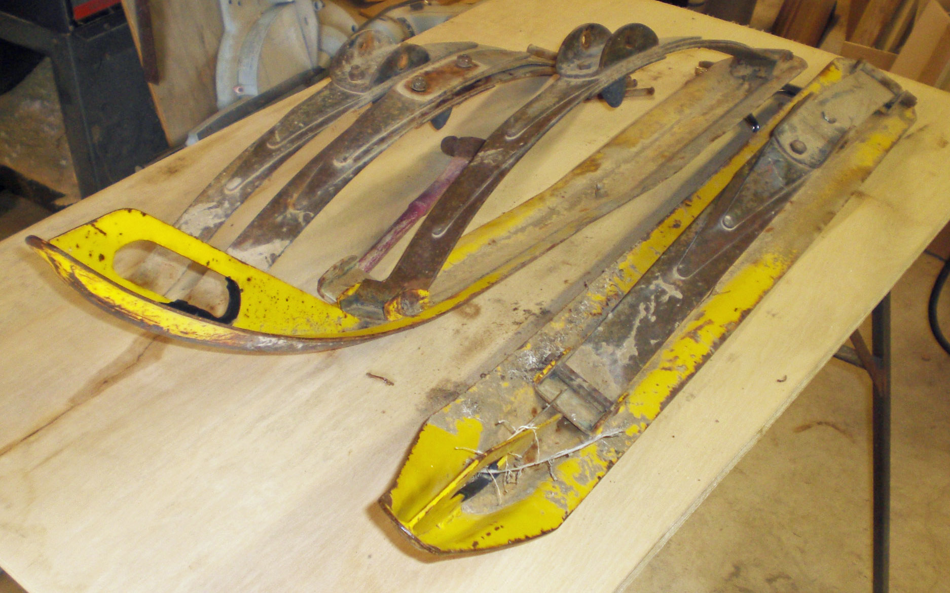

Well, I scrounged up some springs today. They are off the front of some old snowmobile. I think they will hold the carriage pretty good. I needed these before I can design my frame. I also am going to bore out the wheel for some bearings. I have some Timken style bearings that will work good. After I get the wheel bored out, I'll start on the axle. There will be pictures:o)
later, Wes

Hang on to those skis, they might come in handy in a month or so.
