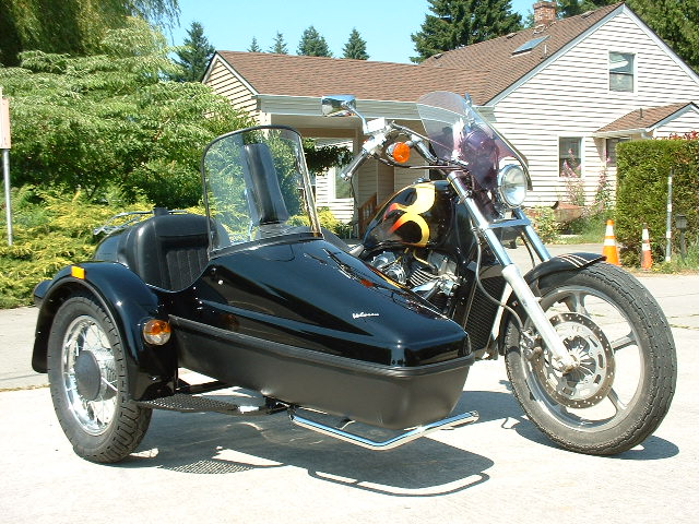

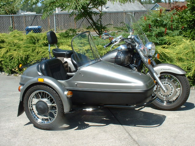

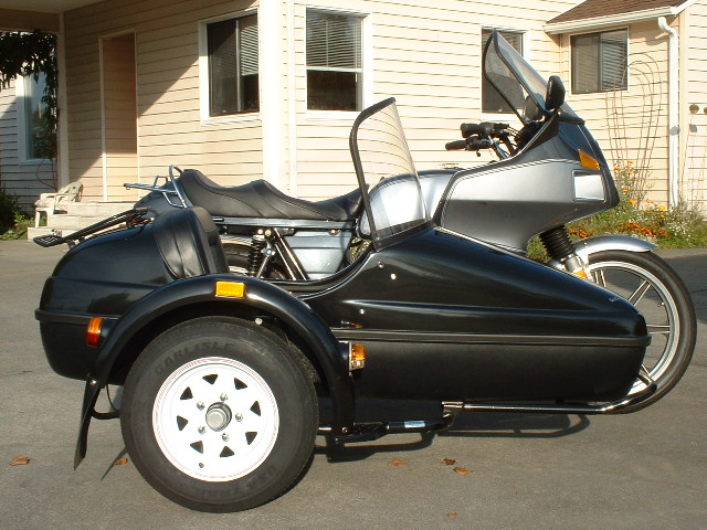

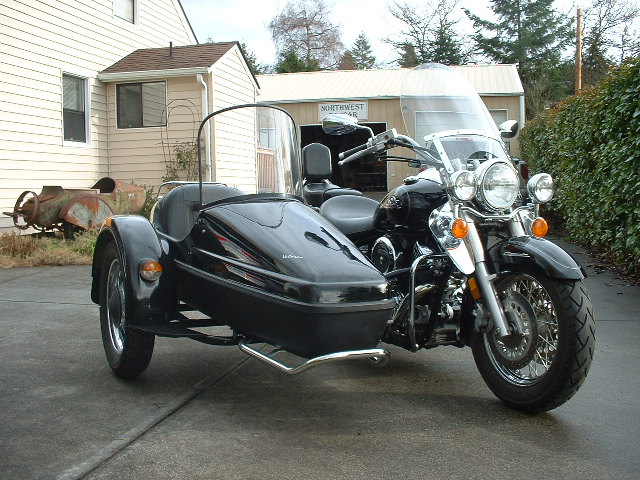

Here are a few examples of our conversions.

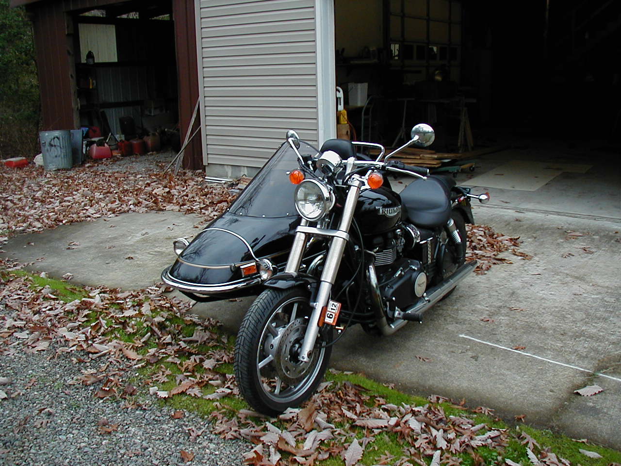

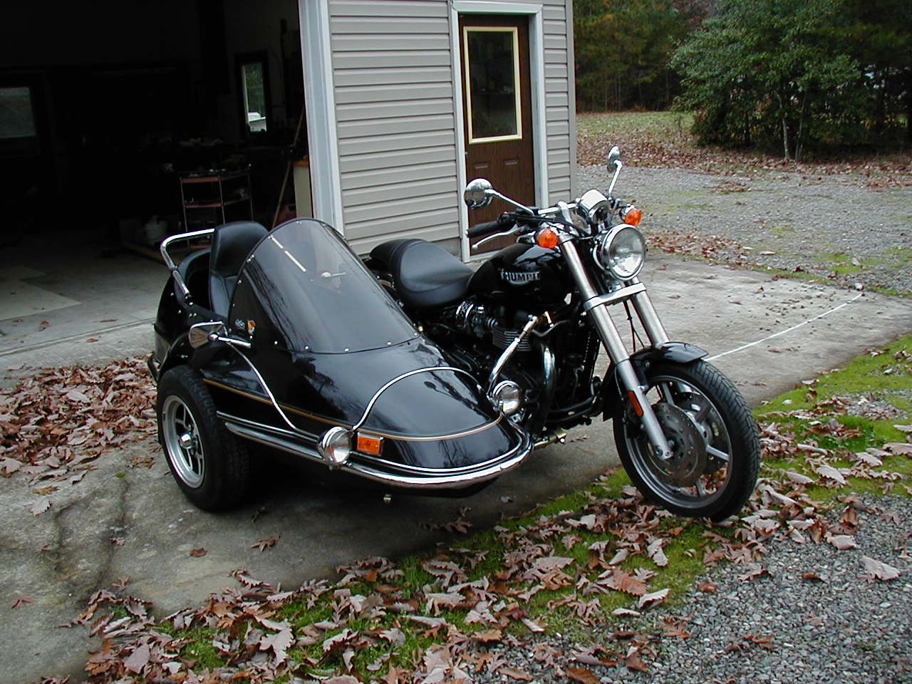

Hi Smitty, Just thought I would throw in my 2 cents about the Triumph. I connected a CSC hack to a 2004 Triumph Speedmaster , 790 cc. It works great and was fairly easy to connect with no frame modifications. I had to have one special piece fabricated and that was pretty simple. Good luck in your choice.
