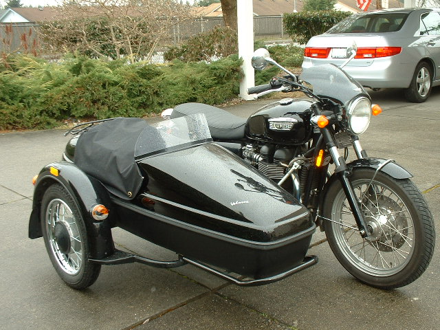

Another affordable option available in your area.

I have to say, I have seen pictures of what Claude can do with a Cozy and it's spectacular. I'm supposed to have called him by now, but there's a part of me that doesn't want to know how much...
For all-round reasons like good weight AND vaguely period-correct looks, I vote for the Ranger or the Spyder.
Aside from the price, I think the Ural would be too bulky and heavy and the LS200 would be too light. The S500 would be rather dandy, but the prices Blue Moon quotes are all ala cart and the final price is rather shocking.
