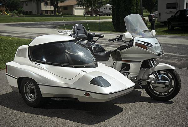

So $6200 for a '94 Wing with the Astro 2+2 is not a bad price then? Even with a non -functioning radio & some running lights out? I could learn on it for a year or 2 and sell it for about the same $$, ya think? I thought the size of the car might too much for a beginner hack driver.

1. 1994 1500 Goldwing w/ 105K miles & and Astro 2+2 sidecar asking $6200. Radio doesn't work & a couple other minor lights out.
2. 1984 Suzuki GS1100 w/ a 562 Velorex sidecar 35K miles asking $4000
Advice requested - Which is better suited for a total novice sidecar driver? I have several 100K on 2 wheels - 0 on 3 wheels. The Wing rig looks HUGE, but I worry about the age of the "Zuki.
redsimp. That seems a bit high for a '94 Gold wing SC Rig. What has it got done to it? A 1500 GW will go a lot further than 105K.
Your location also has a lot to do with price. I just picked up a 2000 GW with Color Matched Champion Escort. It has E-Z Steer and electric lean. Everything works even the Cassett player and the CB radio. Bike had 22,500 miles on it when I test rode it. I'm up to 22,900 now. $8500
Posted : July 19, 2016 8:35 am

Actually, a big (as in wide) car is easier for the beginner as it's less likely to tip on right turns. You will have a bit more push and pull on acceleration and deceleration but with the EZSteer and adjustable lean, you shouldn't have much trouble at all.
