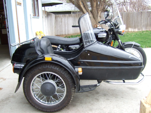

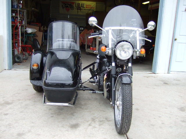

Here's a 2009 Bonny/563 Tour that we set up.
Posted : November 2, 2015 12:34 pm

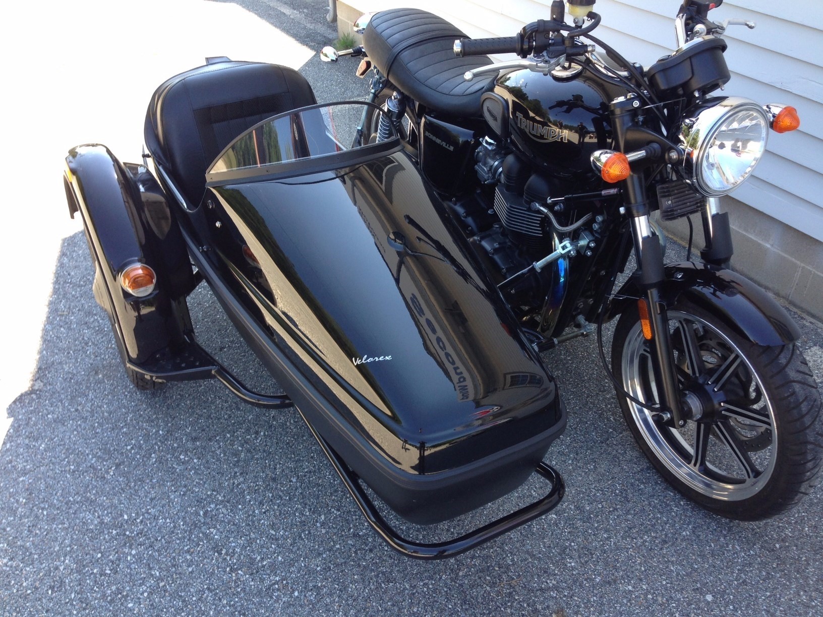

That looks great!, actually almost exactly like the one I am considering. here's a picture of the 2009 I'm looking at. bike has 1600 miles on it, car was attached 300 miles ago, car is a 2014. They are asking $8995, but I may be able to get them down a bit

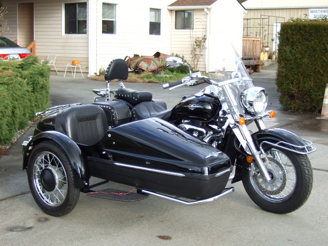

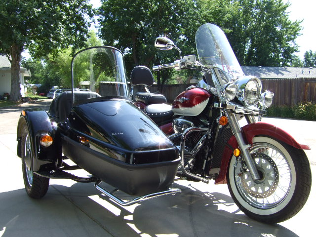

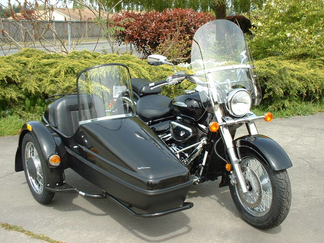

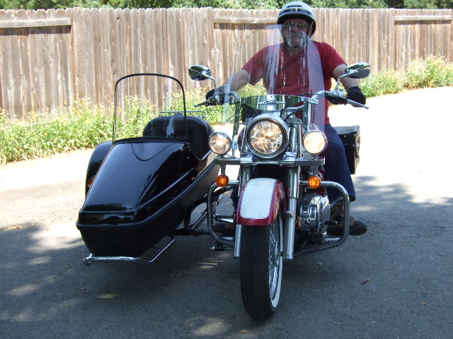

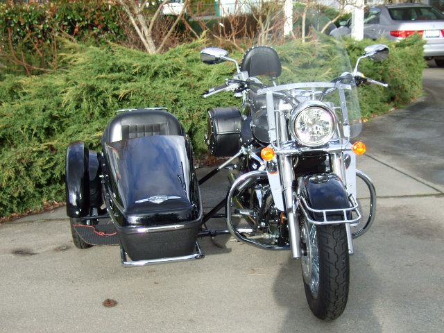

Here are some C50 Suzukis we have set up with Velorex's using easily fabricated subframe brackets.
Posted : November 3, 2015 7:51 am

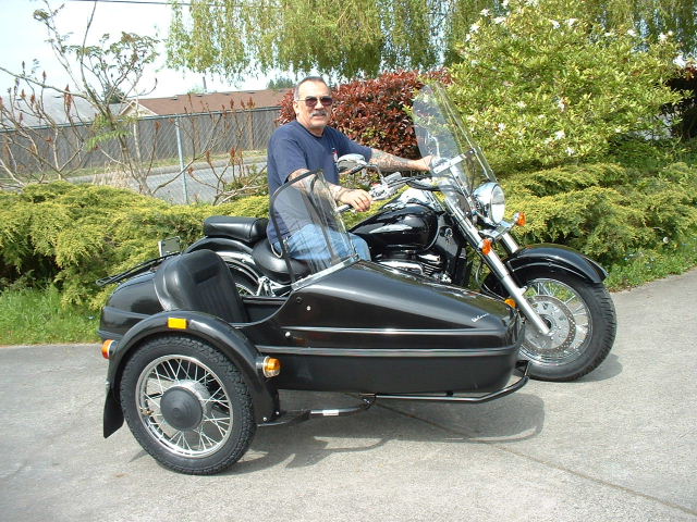

Roland down here in Louisiana has been quite pleased with his C50/Velorex combination, which has traversed quite a few miles as a commuter for various family members. I don't know any details, but I understand Roland mounted the sidecar himself.
Posted : November 3, 2015 1:53 pm

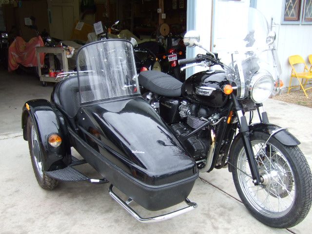

George & Aurora and their widely-traveled Triumph/Velorex rig:
