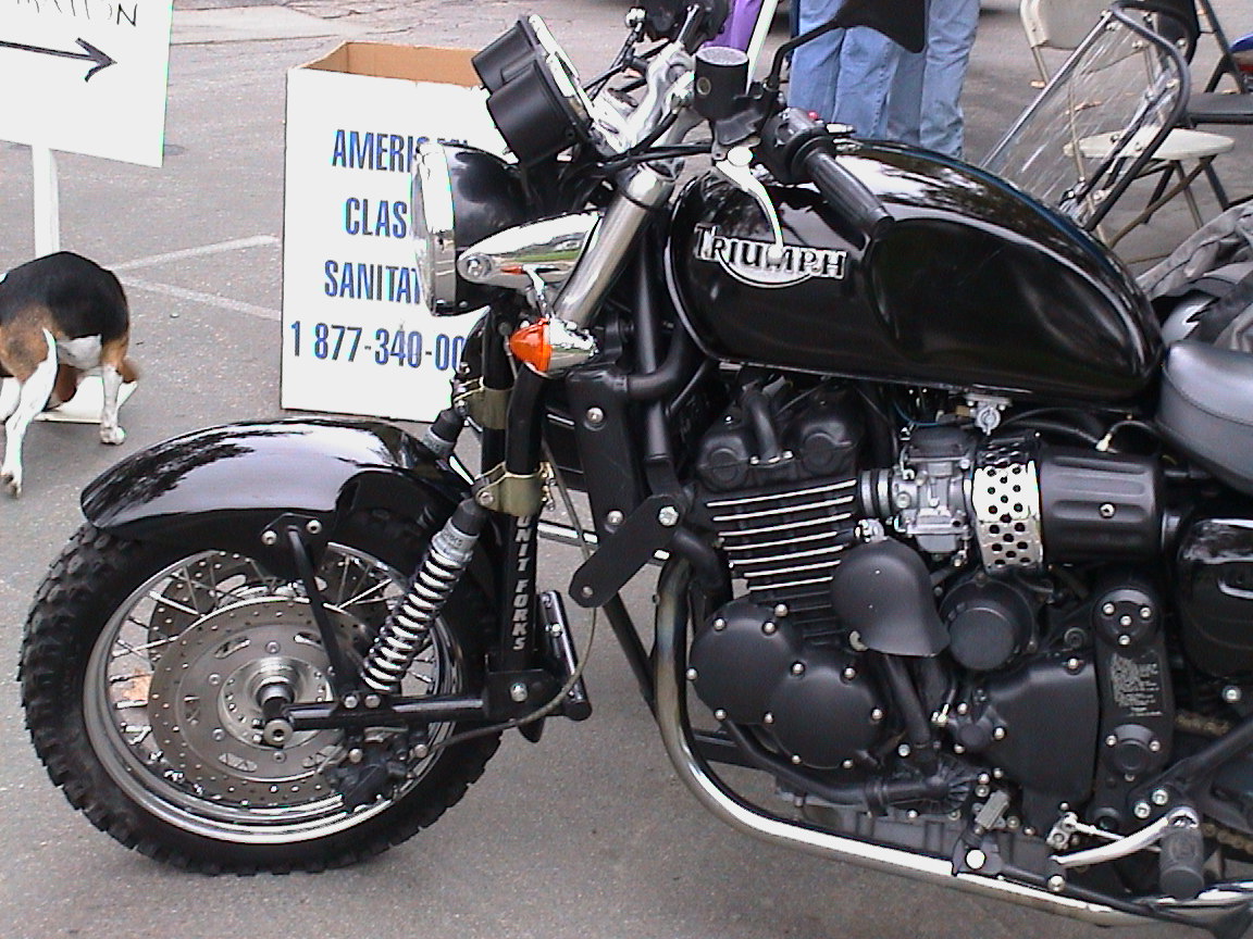

I would take a look at the leading link front end. There is a manufacturer over there that makes a very good one. May not be real pretty but it sure does work. You would end up steering with one finger loaded or unloaded. Good luck.

For the Unit leading link forks in the UK contact:
Broomhill Composites, Ltd. in Hedingham, Essex
Ph. 01787 461000
Installing the Unit forks will make the rig steer effortlessy, like you had power steering.

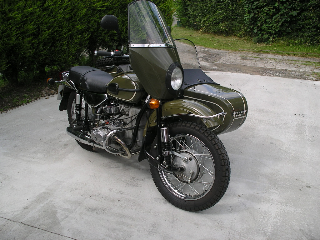

where are you located in the uk? if your not to far away you could have a spin on my ural to see what leading link feels like & i could have a look at your setup. even with standard tele forks you should'nt be fighting the rig. stick with it. Hank

Hi Kayley you can have a go on this one
Posted : August 26, 2009 3:57 am
Wow, yes please!!!!!!!!!!!!!!!!!!!!!
