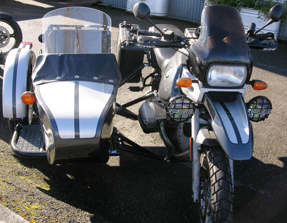

Having built almost 500 BMW GS sidecar bikes and having never turned off the ABS and always kept it working I have no idea where Hack'n comes up with the idea that you would disable the ABS. If you want to give me a call we can go over everything needed to mount a sidecar to a GS, as well as what options you may or may not want. We offer bike specific mounts for all of the GS bikes from the first air head up to and including the current R1200GS Water cooled bike as well as all of the F and G series GS bikes. We have steering modifications for most. In the case of the R1200GS we make a new from billet ball joint mount that moves the front wheel forward making for lighter steering with the sidecar. We also offer an automotive rear wheel for the bike that will interchange with the wheel on the sidecar. For the new R1200GSW we are working on an automotive wheel for the front that will interchange with the rear and sidecar wheels.
For me my first choice is the R1200GSW, Lots of power and I really like the cruise control. On more of a budget the R1100GS is a great value right now. It is also the least expensive bike to modify the steering on.
I have attached some photo's. The first several our of our M72DX sidecar which is about 4 inches wider then the Ural you had. It is mounted on the new water boxer GS. The last photo is of our M72D sidecar which is almost the same size as the Ural but with a deeper trunk area. It is on a R1100GS
