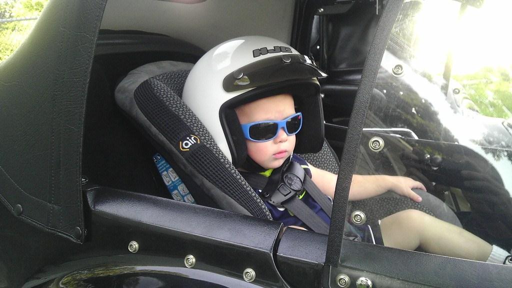

My grandson did his first poker run in mine when he was about six months old. With his car seat strapped in to the seatbelt he smiled or slept for 100 miles. As he got older a booster seat worked well,and if he grows as much this year as last year I suspect the seatbelt may be fine. Make sure you have pillows for them though,as the rig seems to lull them to sleep.

My grandson started riding at 2 years and 4 months, last July . He now has over 5000 miles riding with me and we just went on a 7 day 1350 mile road trip to Deals Gap NC and rode the Tail of the Dragon twice and 28 and the Cherohala Skyway. A good carseat and a convertible top till yours gets older will help . Mine loves the new 4 inch windshield i made for ours instead of the 12 inch but he thinks its a carnival ride.

Hey Ribbons, check my post for some cool pics. I will gat you some close up pics fo the seat and "redneck hanns device" on my rig . Aiden would rather ride in the sidecar than in the car or truck 95% of the time . He has ridin in the rain a few times and has asked to go riding in the rain. As long as we are moving he doesnt get wet other than a few drops on top of his helmet . Check here for some REALLY COOL pics. we are on both pages of pics this day
