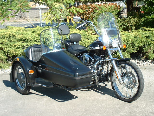

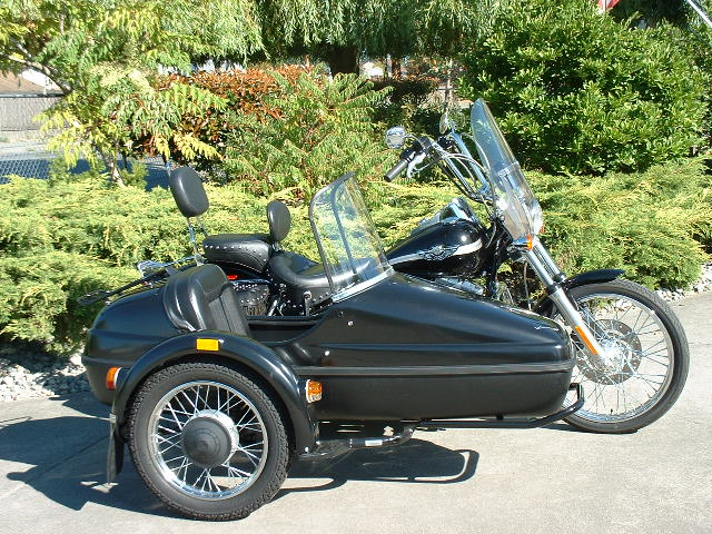

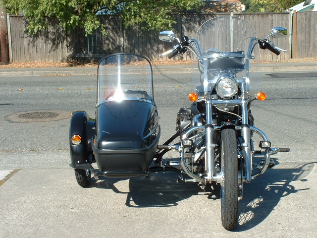

Here's an '03 Softtail with one of our Velorex sidecars mounted.
Posted : September 9, 2009 7:15 am

your bike looks great thank you 4 the pic as soon as I get mine I will also post
