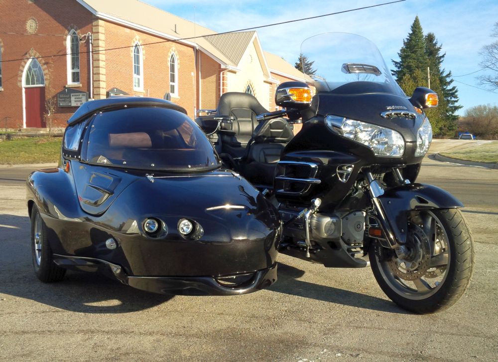

Here's some eye candy for you in the mean time; this is a 2010 Gold Wing I recently mated to a Hannigan GTL with all the bells and whistles...

I do like the hannigan cars, and Wow the GTL is one sweet looking rig
it looks like your forks are raked in the pic, if so what degree is it

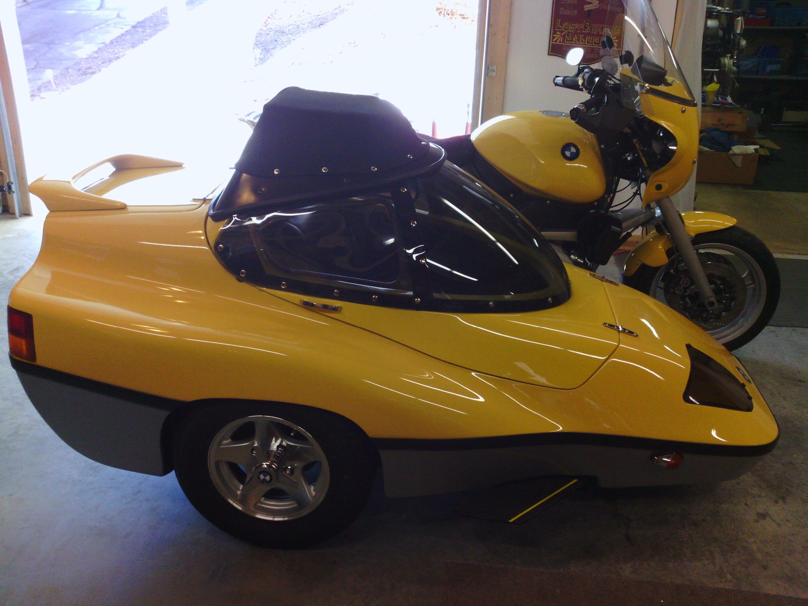

Of the four rigs I have owned two of the chairs were Hannigan models. I really like their quality and my wife likes the ease of entry and storage. As Claude mentioned in his post you can flip the top without removing or detaching anything. The only downside for me has been that some of the models bubble shield and tops limit the movement of the passenger and feel confining. This too can be fixed if you don't mind little time and effort. I was able to fabricate a hardtop, windshield and removable side windows that my boss monkey says fits the bill. I will try and post a couple of pictures so you can see the difference. Size wise you wing should be able to handle any of the large chairs you may find. Good luck on your search!

New top

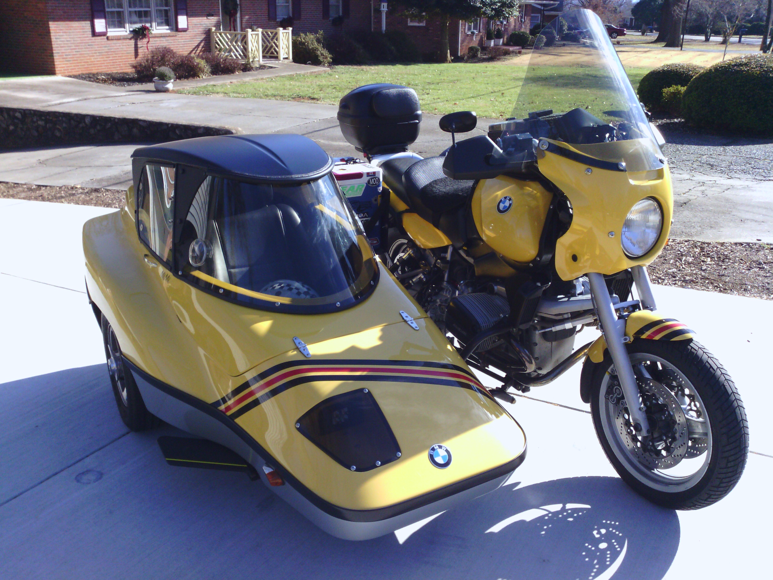

Here are a few picks:

Will and Draper, those are a couple of nice rigs, I love the BMW emblem on the nose, very nice touch
Will is that an Escort

Yes it is. I am not sure what year Escort. The person I purchased it from had it on a 1500 Goldwing and two 1800 Goldwings. He was in his 80's and had to sell it for health reasons.
